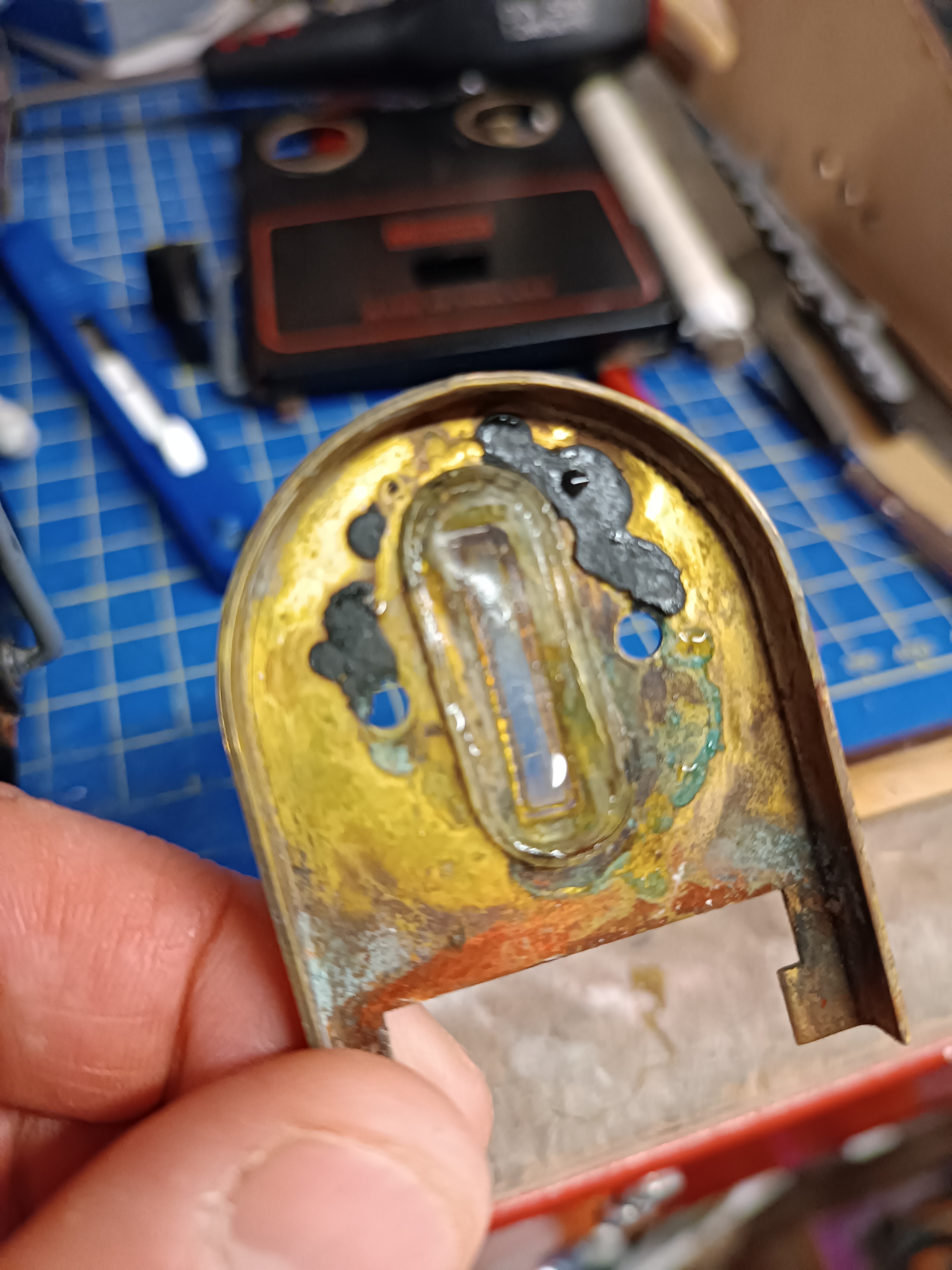

I have recently bought an SL1 locomotive that I'm going to convert to 45mm, but I have noticed that the sight glass was all fogged up. On removal and inspection it appears that there is a rubber diaphragm (or is it black sealant ?) on the back of the boiler with a hole in it. Is this right, or has the previous owner bodges it by sealing it?
What should the rear of the boiler look like after the sight glass keeper plate has been removed?

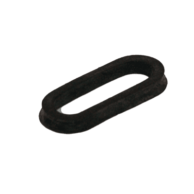

Take a look at the Mamod spare parts and you will figure out.
https://mamodspares.com/spares-14-c.asp
Between the sight glass and boiler there should be a gasket.
And there should be a slot in the boiler looking like the gasket.

I was wondering why it doesn't look like any of the spares, so from that I think we can safely say that someone has covered the space between the boiler and the sight glass with either a piece of rubber or filled it with black sealant and poked a slit in it...
Looks like I have bought a lemon... She doesn't want to steam either. Pressure is just getting lost from somewhere and running lasts literally a couple of seconds.
Much work to be done to this one. It May well be eligible to be modified, or become an expensive source of spares! I will post a picture of the boiler back end shortly.

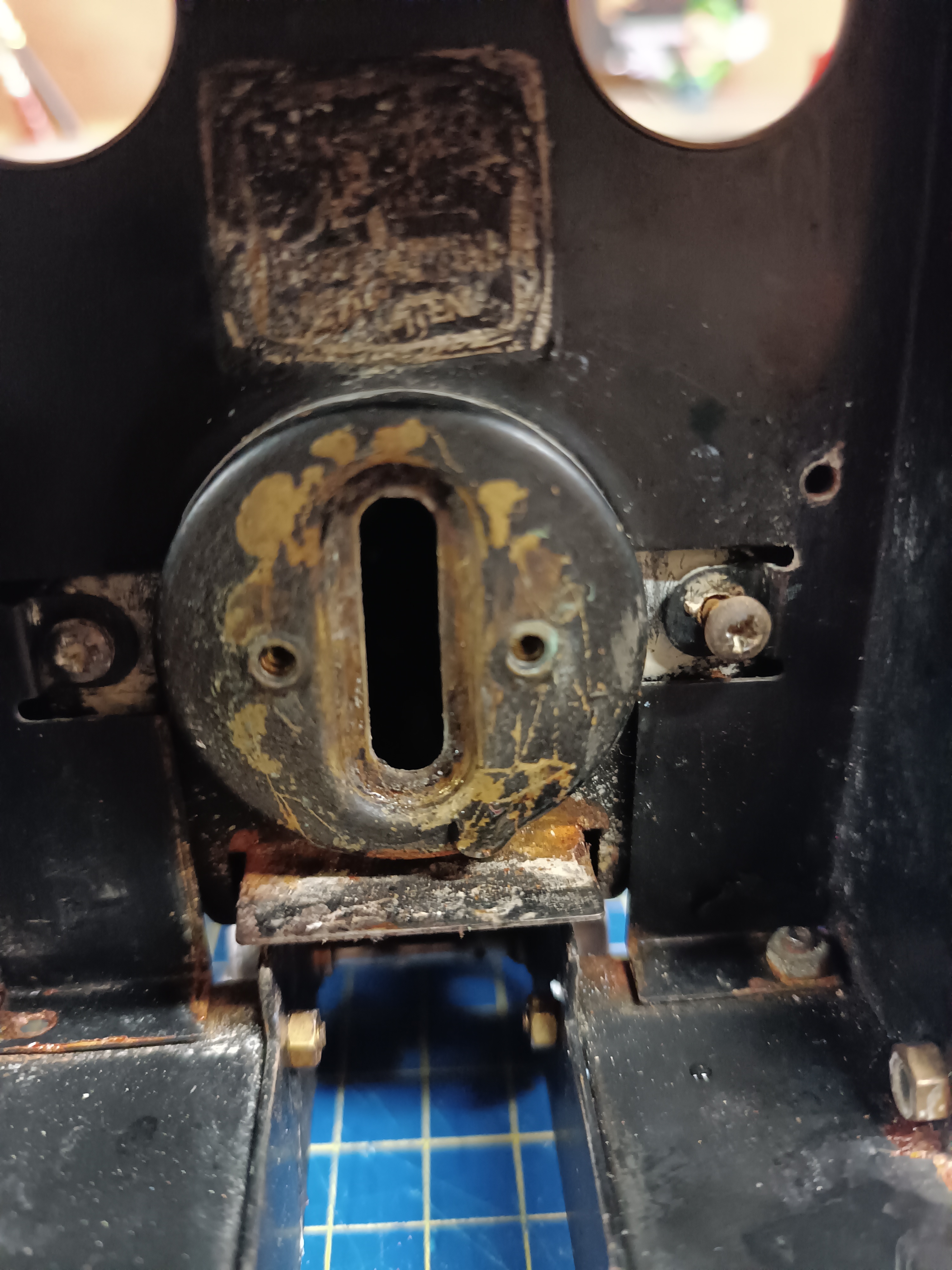

Re: Mamod SL1 boiler end
As you can see...
Not very nice and doesn't look right to me.
Thoughts?

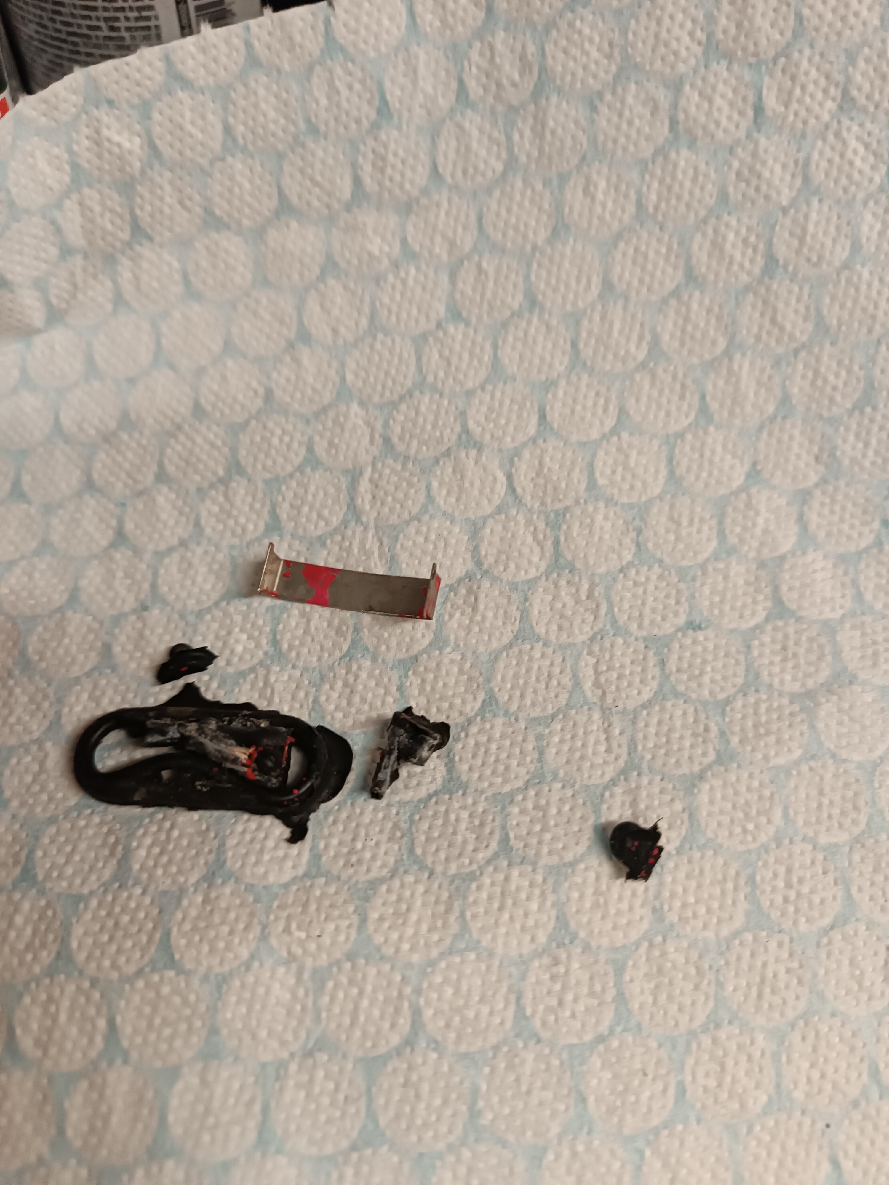

So, after watching the football (sigh). I decided to cheer myself up by going to the workshop and look again at the boiler... Looks like Mr Bodger from Bodgerton was the previous owner. I found half a tonne of black mastik in there along with a piece of metal...
No idea what Mr Bodger's thought process was other than not wanting to spend around a fiver on a new gasket.
Hey ho, at least I can give this loco a fighting chance now...
![Image]()
That's better!!!
- Attachments
- IMG_20240714_231221.jpg (2.03 MiB) Viewed 107949 times
Looks a lot better that. Just get a seal and see what happens next hey. Good luck Tim.
