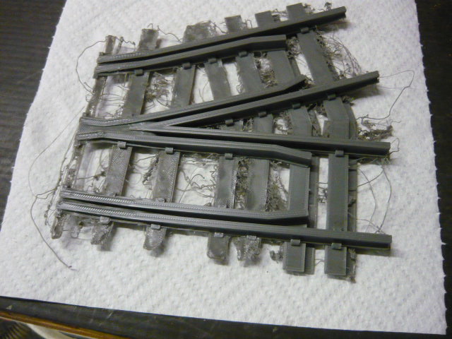

I had a failure while printing an object and noticed the mounting bracket on the BL Touch had been bent well out of 90 degrees it must have caught on something substantial but I'm not sure what, I am guessing it was most likely the print as there are signs that it had moved.
The print was full height at one end but at the other the lower levels curved up from the plate with loads of spaghetti underneath indicating an adhesion issue.
I straightened the bracket using a square and the sensor appeared to be working fine when sensing the build plate when I started a print, but the nozzle has driven into the build plate no filament flowed and there are brass marks on the build plate.
I think I may have to set up the printer again and replace the bracket and the sense pin or in the extreme the whole BL Touch.
I also think that build plate may need replacing.
Has anybody seen or heard of this sort of thing happening and offer any advice or direct me to somewhere that I may ask about this problem.

Further investigations have revealed that the bracket I straightened is not holding the sensor at right angles to the build plate and the probe actually has a slight bend in it (only noticeable when rolled across a flat surface).
I rang a supplier of replacement parts to get a new bracket and told me that what happened is not that rare, when I told him what had happened he said it would appear that the probe has caught on the print and tried to drag it across the bed but it was adhered to strongly hence the bent bracket and probe.
As the probe is adjustable by turning the small screw on the top of the body when I replace it I will have to do a complete bed level and Z offset adjustment.
I never would have thought that a print adhering to a bed would be strong enough to bend a mount, but it is alloy.
I think the replacement may be steel but I would think that would change the magnetic parts internally (will check with a magnet when they arrive).
The supplier said that the marks on the bed should not affect the print quality but if it does a new plate may be needed which will again necessitate a new tune.
In summary this is a lesson learned.
Thanks to all who offered suggestions/experiences it put me on the right track.
