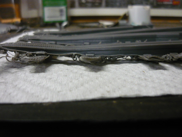

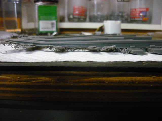

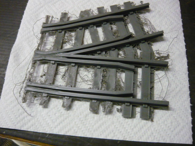

I had a failure while printing an object and noticed the mounting bracket on the BL Touch had been bent well out of 90 degrees it must have caught on something substantial but I'm not sure what, I am guessing it was most likely the print as there are signs that it had moved.
The print was full height at one end but at the other the lower levels curved up from the plate with loads of spaghetti underneath indicating an adhesion issue.
I straightened the bracket using a square and the sensor appeared to be working fine when sensing the build plate when I started a print, but the nozzle has driven into the build plate no filament flowed and there are brass marks on the build plate.
I think I may have to set up the printer again and replace the bracket and the sense pin or in the extreme the whole BL Touch.
I also think that build plate may need replacing.
Has anybody seen or heard of this sort of thing happening and offer any advice or direct me to somewhere that I may ask about this problem.

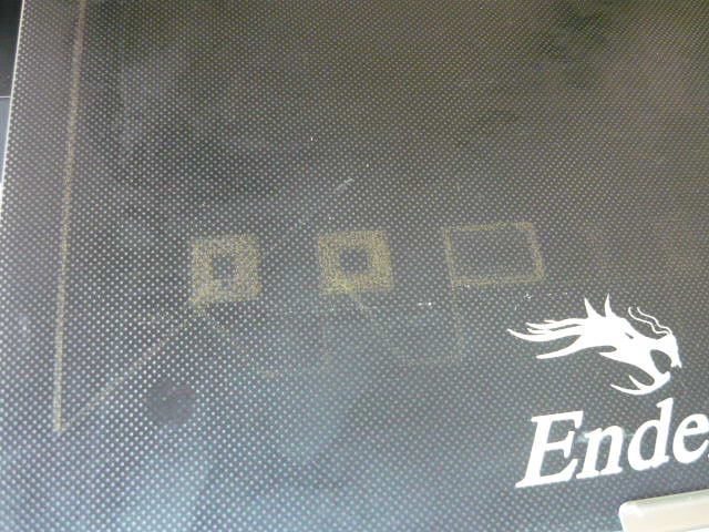

The supplier said that the marks on the bed should not affect the print quality but if it does a new plate may be needed which will again necessitate a new tune.

I was able to remove the brass marks on the plate because it was actually embedded in filament and not on the glass but during one attempt the nozzle was driven hard into the plate and dragged across it leaving score marks. A new pate may be needed in the future.

After a lot of work I have my Ender3 V2 working again.
I replaced the bent bracket and the probe, the BL Touch looks a little of square but it doesn't seem to affect the probing.
I went back to square 1 and loaded the original firmware and without the probe being in play I levelled the bed.
I started by using a "T" level and a bullseye level to roughly get the bed level, then proceeded to level the bed using the paper method.
This took a rather long time until I finally worked out that no matter how careful I was that when I moved the print head I actually put downward pressure on the Z axis and changing it's the height so I was forever readjusting the knobs.
Reading many, many articles on levelling and watching hours of YouTube videos, I found a method that uses the printer controls to move the print head into the 4 corners to use the paper method that removes the risk of shifting the Z axis.
A quick level up and then a Z offset adjustment I tried a test print, the nozzle hit the print in a couple of places and in a others all I got was a blob of plastic.
Watching the print a couple of times with similar results I found the nozzle was to close to the bed so while it was printing I used "live adjustment" till I got a fairly good print.
I then loaded an stl file and printed it and it came out very good, bit of stringing but as I used the Creality PLA that came with the printer all in all it was a good result.
I had just finished the print when the phone rang and it was Jaycar telling me that the Ender3 V3 Se that I ordered had arrived.
So I now have an V2 working and a V3 waiting to be assembled.
