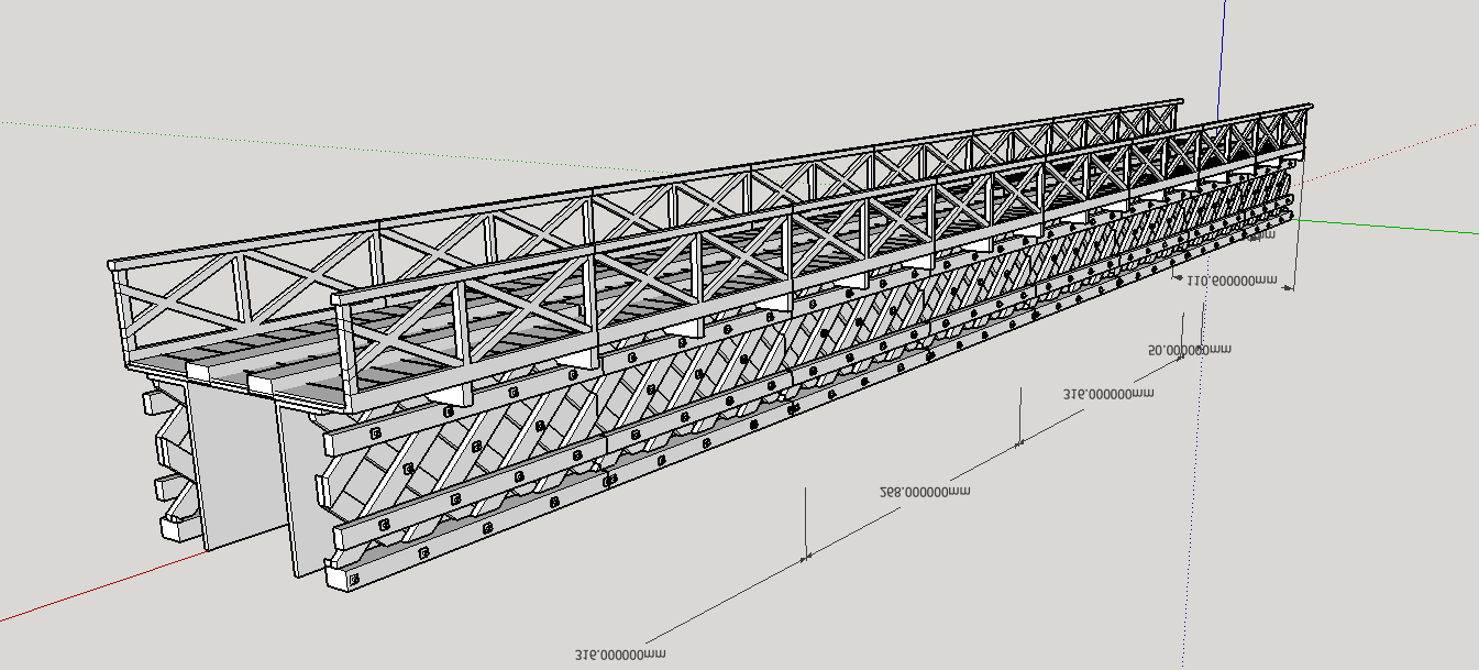

The second path crossing for the current extension on the "Railway in the Valley of the Mill" was inspired by the drawings and photos in "The Little Train to Llan Ffestiniog" by Chris Jones. The Real bridge wasn't actually on the Ffestiniog Railway - but was on what should have been an extension to it.
It was a wooden trellis bridge built on stone piers, with three spans each 80 feet long. I will only need to model one span, or a shortened version of it to span the 1 meter gap.
The 3 D model to show you what it will look like:
Screenshot 2023-03-02 at 14.37.38.png (110.72 KiB) Viewed 16379 times

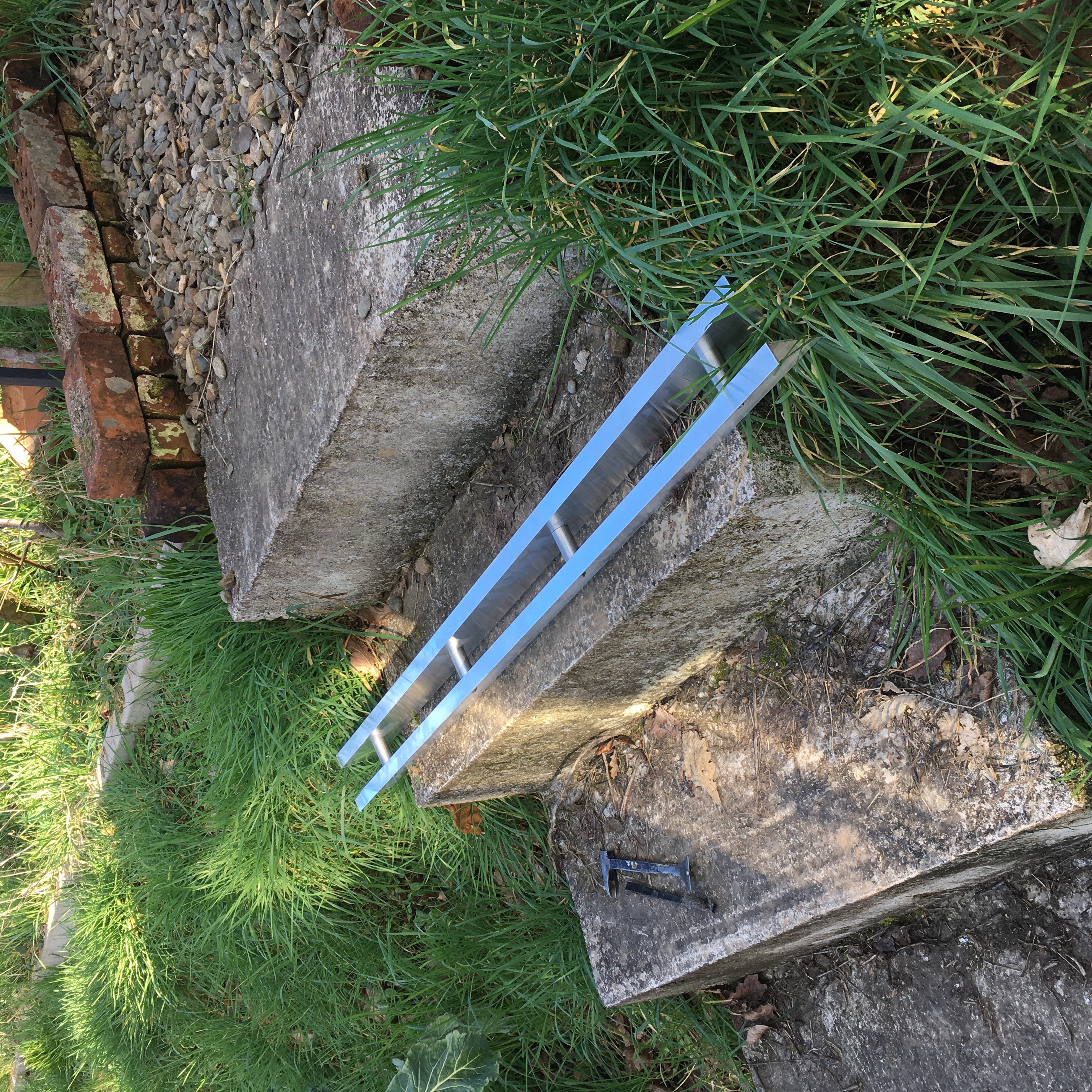

It is to be a composite structure, the strength being provided by an alloy sub structure which will be encased in a filament printed skin. The alloy substructure and the gap it is to fill:
The alloy is 20mm x 60mm angle 2mm thick, fixed 45 mm apart using 4 stainless tube spacers and nuts and M6 bolts. The track will be mounted on a printed planked deck, with longitudinal sleepers printed into place. I think I will print the chairs on at the same time. ( I am currently extending the track using ABS printed chairs. The trick is to wash the chairs with acetone which reinforces the inter layer bonds. )

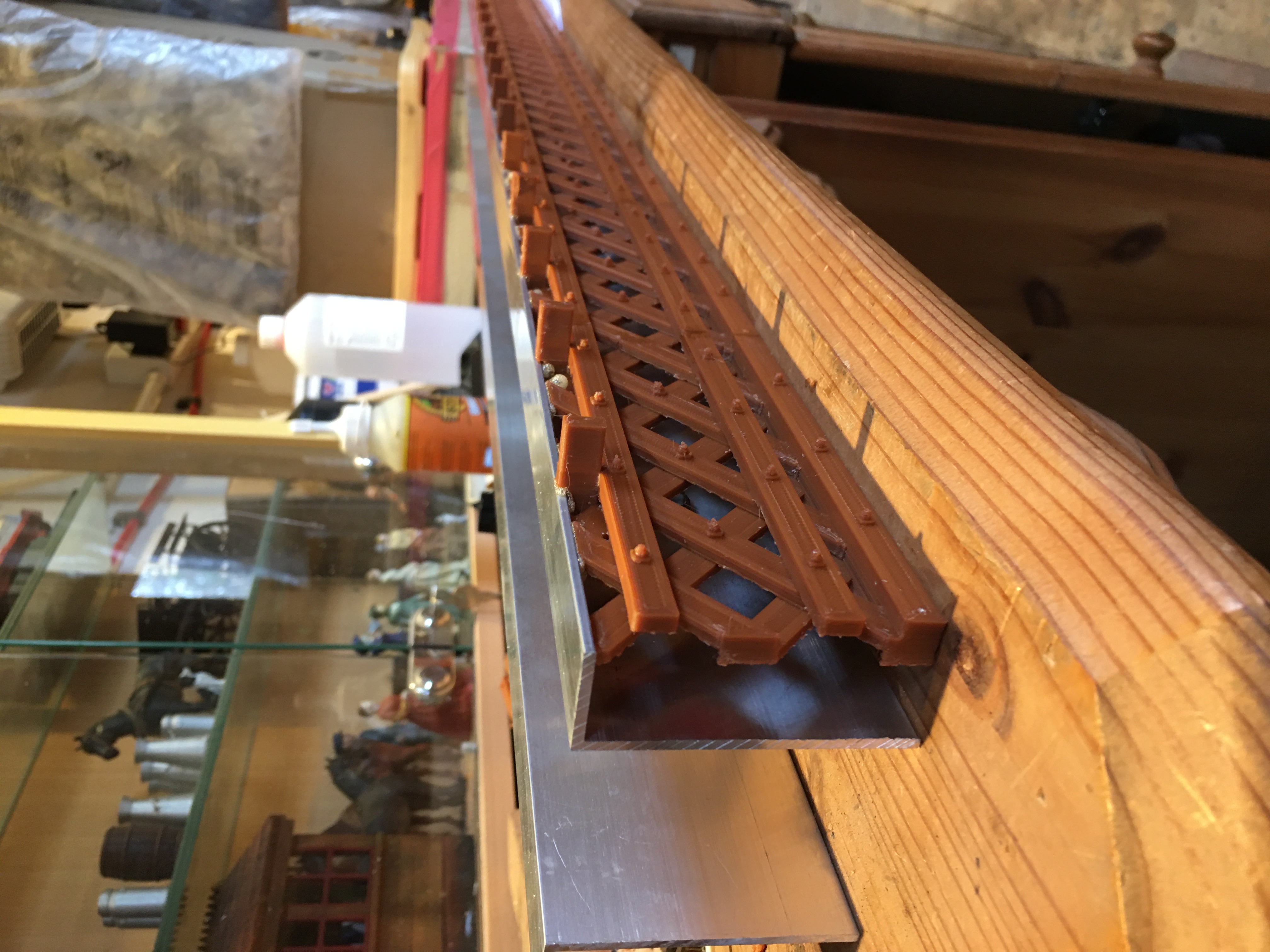

The trelliswork cover for one side of the bridge is now printed and bonded onto the aluminium frame:
That was printed in 8 sections, 2 at a time flat on the bed of the printer. I used the "tree like" supports which enabled the true shapes of trelliswork to be printed. 4 sections of the trelliswork for the other side has been printed. Later in the week the decking should be in the printer.
I used gorilla glue to attach the trelliswork to the alloy, and acetone to bond the sections together.

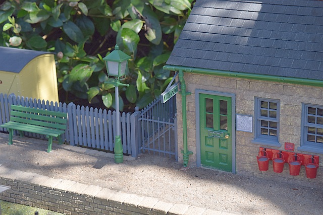

Phil.P wrote: Tue Mar 07, 2023 12:48 pm 3D printed components, I wonder what they will be like in 5, 10, 20 years?
The modelling is brilliant, it is the resistance to the elements, that concerns me.
I detailed my build of this station and all the ancilliary items, back in April 2018. The platform face, platform lamp, bench, windows, doors, fences, gate, fire buckets, gutters, downpipes, drain grille, 'way out', etc, are all printed in PLA ( Trevor uses ABS which should be even more durable):
DSC_0021 small.jpg (189.72 KiB) Viewed 16222 times
...and here it is in my gallery entry, as of a couple of weeks ago:
It has all been out in wind, rain and shine, summer and winter, 24/7/365 for 5 years. The lamp post is drunk because it got kicked by a rampaging dog. The platform is growing a nice crop of moss and everything is a bit splashed, of course, but those are the only sign of defects.
Come back in another 15 years for the answer to the third part of your question! :lol:
