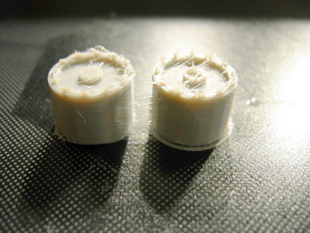

Post by ge_rik » Fri Jan 27, 2023 4:03 pm
Can anyone advise?

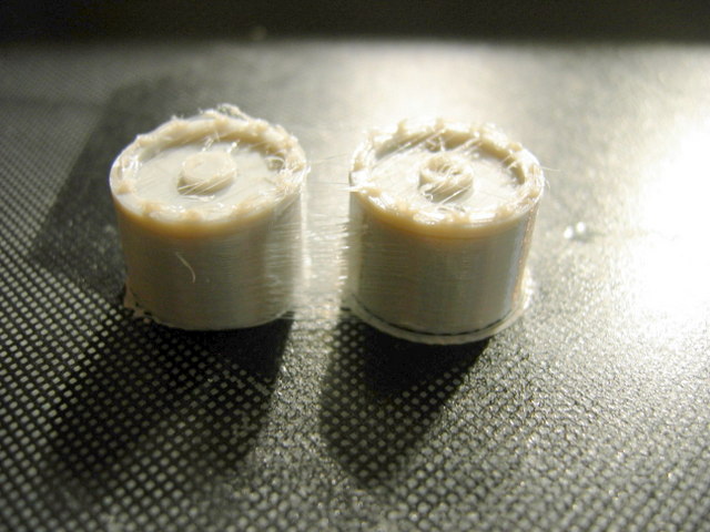

I've suddenly started having problems with stringing on my FDM printer. I've not used it since before Christmas and it has been cold out in the workshop, just in case that's a factor. When I started it up and printed, it was fine at first ....
But then, I started having stringing problems
I have loo ked online and tried everything which was suggested:
  • Decreased print temperature
  • Increased travel speed
  • Adjusted retract speed and distance
  • Replaced the nozzle
I've then changed to a brand new reel of filament (in a vacuum pack) in case the old reel had absorbed moisture and the problem has persisted (as you can see above).
I've even wiped the filament with olive oil as suggested in one YouTube video.
I'm rapidly reaching my wits end with it.
Any further suggestions?

I had similar problems and I adjusted the retract speed and distance that did help and when I switched from PLA over to PLA+ the problem went away.

What I can't understand is why it happened so suddenly. The first print I did was fine, then suddenly I got stringing with the next one

Stringing isn't a problem I've ever had to any serious degree until just recently. It didn't start until I started to use my first ever reel of PLA+ in early January, when I started getting rats nests of cobwebby fine strings very similar to Rik's white prints above. I had the problem for about 10 days and then it just stopped for no apparent reason.
Having read the posts in this thread, I'm wondering if it was indeed temp related, as Trevor suggests. I have my printers indoors and temp has never been a consideration before, however with the energy cost rises we have turned down/turned off the radiators in non-essential rooms and that includes the room I use for my printers. A couple of weeks ago, because I was working in there more, I increased the heat a little and thinking back, that could be when the stringing stopped.

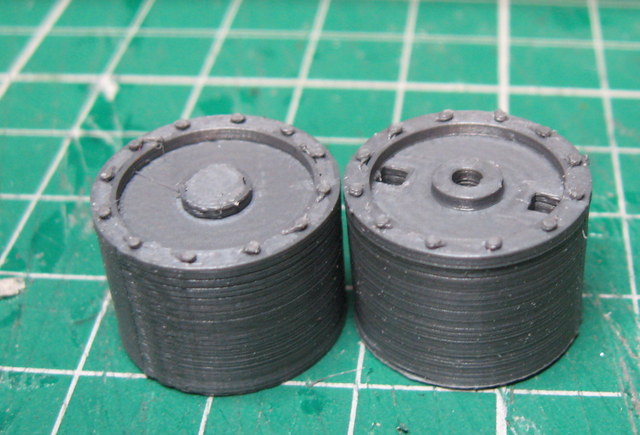

What I can't figure out is that the first print I did after the Christmas period was more or less perfect (the first photo) but all those since then have been whiskery. That doesn't seem to diminish whatever settings I change (temp, speed, retraction, cooling).

Thinking about it some more, my prints that were stringing were fairly large open boxes which took about 8 hours each to print. I printed them overnight, for two reasons (1) because of the length of print time and (2) because we have recently switched to an Octopus tariff that varies in half hourly increments and gives cheaper rates overnight ( on a few occasions it actually paid US money to use electricity!). However, overnight it has definately been cold, even indoors, and in a closed room with no heating I'm pretty sure it could have dropped into (low?) single figures.
As a possibly similar illustration, we had a PV system installed in early December. The gubbins is all in the garage which is unheated and in the beginning the lithium battery wouldn't charge. By playing around in the various menu's I discovered the battery temperature readout which was down around 4deg and lower. Putting about 15mm foam insulation around it solved the problem and it has been happily charging and discharging ever since. So I'd say yes, try insulating your printer until the room temps rise to at least 10 deg.
