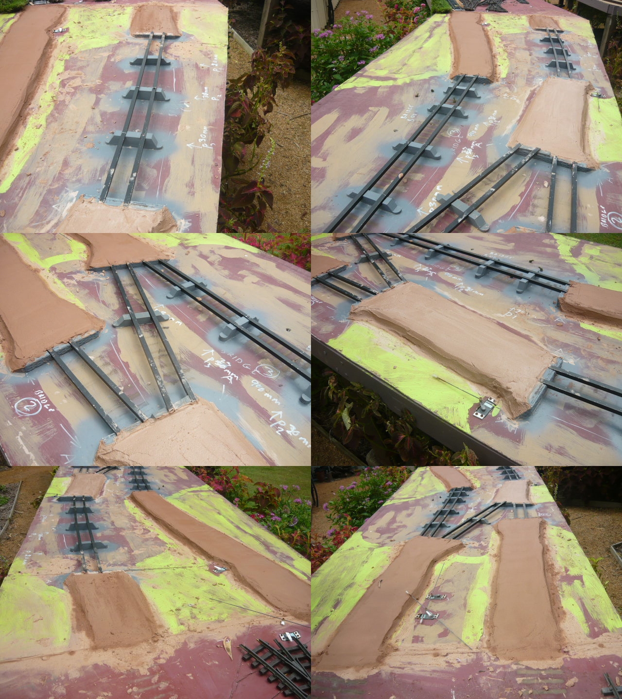

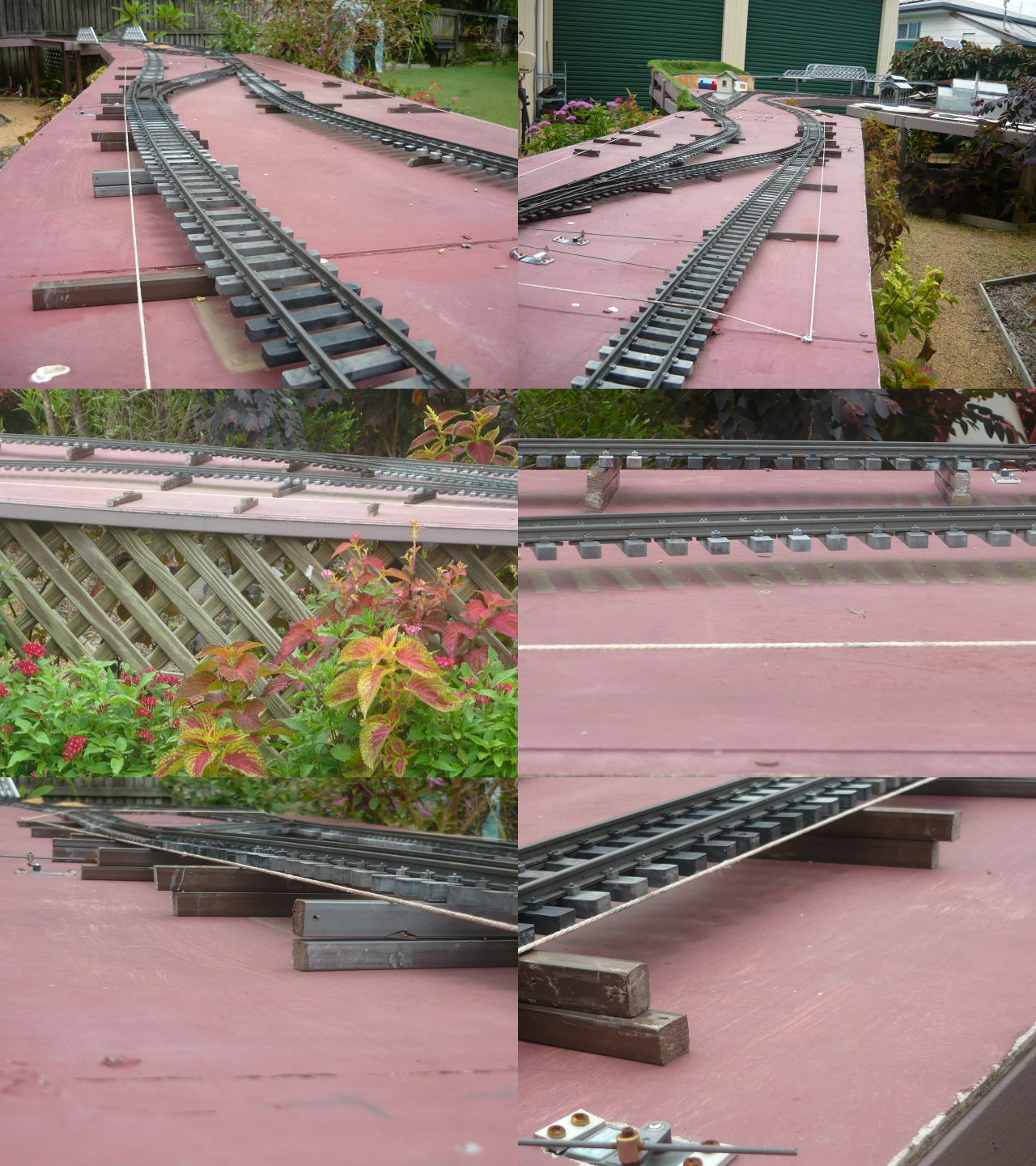

More progress on the embankment area.
I roughly painted areas where there will be a dry river bed a light brown, the embankment areas are in the red colour while the bright green is where artificial turf is in the plan.
Bridges are indicated by pieces of wood.
All the points will be on embankments.

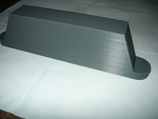

I 3D print some bridge piers for the embankment area bridges to see how they would turn out.
I designed them using Tinkercad and its my 1st project using it and am a bit chuffed with how well I did.
I now have another 6 to print, I can custom build them to a height that fits under the track by manipulating 1 object in Tinkercad and saving them in another project for export to use with the printer.

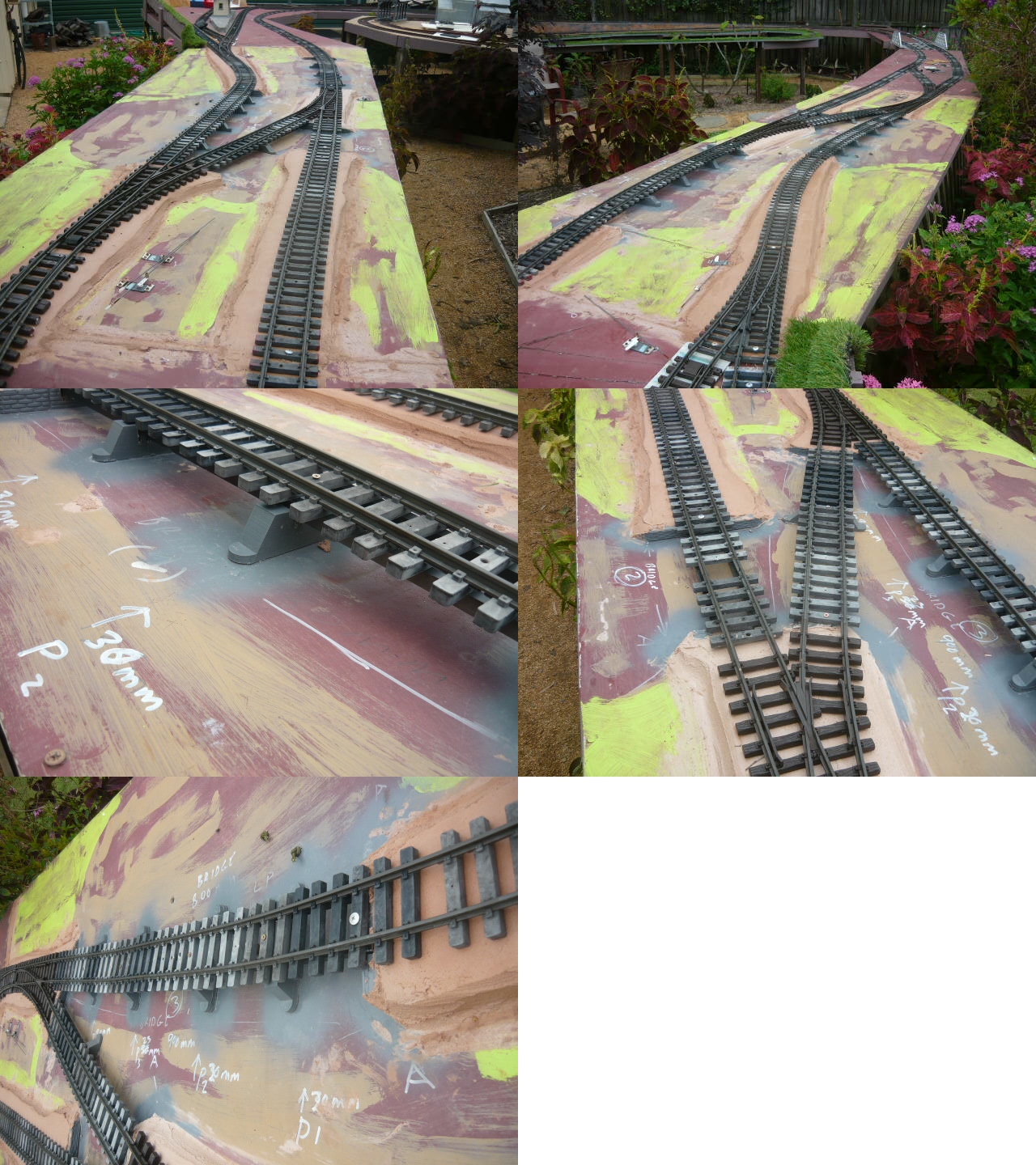

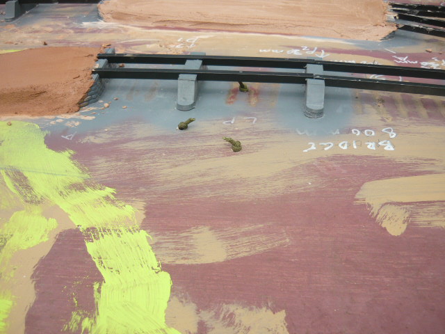

I have made some real progress in the embankments area.
Bridge abutments and piers have been installed, rail supports fitted and embankments have been made out of acrylic render.
After the track is relaid, I will finish the scene with artificial turf and gravel to give the impression of the line crossing over a dried up swamp and creek bed.
To carry water down through the baseboard at the low point (LP) holes were drilled through the baseboard and wicks put into them. These allow the water drain away quickly to prevent ponding.

Today I re-laid all the track in the embankment area so next step is to run a train to test it out.
Then it will be complete the scenery (turf, gravel etc) and it should all be done.

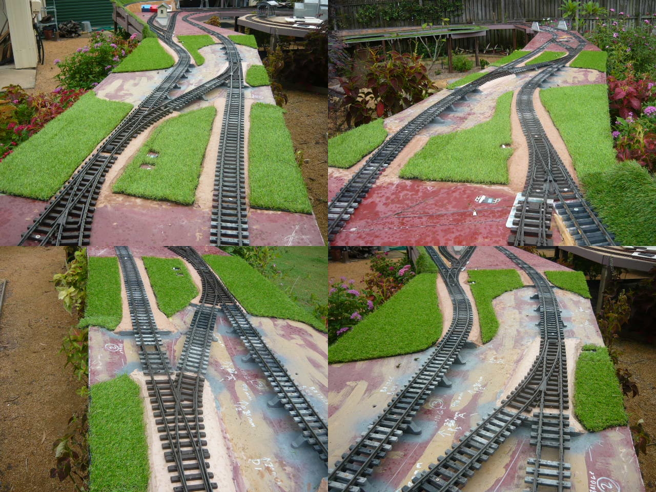

I laid the turf today.
Now all is left is to paint the "swamp/river" area and add some gravel for the rocks.
After some train playin.....um testing tomorrow, to verify alignments etc, I will ballast the track and it should be finished. After this it will be back to finishing the backdrop along the fence scenery.

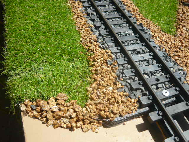

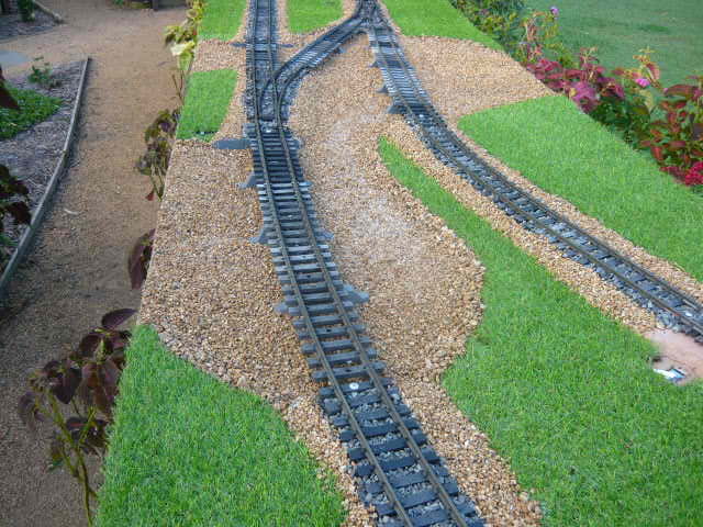

Re: Constructing an Embankment

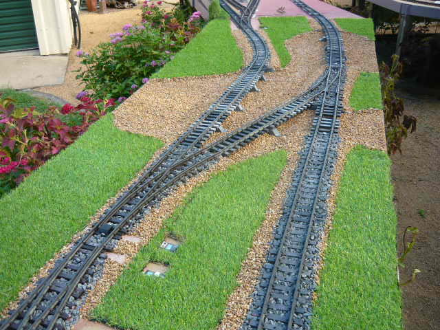

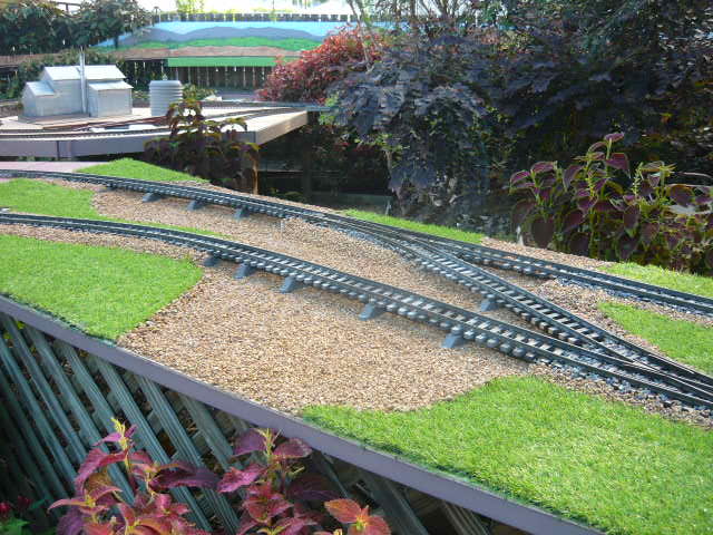

Laid the ballast and gravel on the embankments, all that is left to do is put gravel across the creek bed area.
As I have a gravel train I'm considering putting in a siding for a gravel pit probably on the garden side. Thinking about putting in a siding to a gravel pit which justify having a Gravel Train, probably on the garden side.
Blog being updated and will be published shortly.

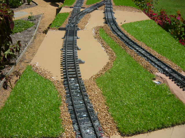

I finished the embankments area by laying the last of the gravel in the creek bed.
My blog with descriptions and pictures has been updated
https://ringbalin-light-railway.blogspo ... -2023.html

Thinking of a few bits of turf offcuts as long grass growing in the dry creek bed.gregh wrote: Fri Feb 10, 2023 8:19 am I think it looks GREAT. Maybe a few plastic 'bushes' or some reeds?
Also thinking of putting in a line to a gravel pit, non operational points similar to what I did in the back corner to suggest a line into the bush, when the plants grow a bit more they will hide the fact the line is a dead end.
The 2 lines will provide justification for my log train and the gravel train.
