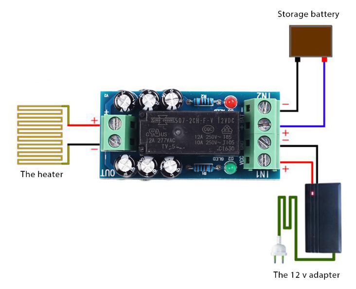

It looks highly likely that there will be power cuts this winter, particularly if we get prolonged periods of cold weather. I found that BT does provide a battery backup device for my Smart Hub for the princely sum of £85 but it only works for an hour and won't power my cordless phone base station. So, I looked for a cheaper option.
For around £15, I got a 12v 7 Ah lead acid battery
https://www.ebay.co.uk/itm/154316027270
and for c£7 I got an auto changeover switch.
https://www.ebay.co.uk/itm/204112420848
These can be bought directly from China for under £5. Here's how they work:
Both the hub and the phone base station are powered by 12v mains adapters and so this seems to be a suitable option. I'm trying to figure out if I can power both from one mains adapter and hence use just one battery backup, but if not, for around another £20 (still half the cost of the BT battery backup), I'm happy to invest in a separate backup supply for each.
More importantly, if it works, I'll backup my mum's emergency button base station.
I'll let you know how I get on.

Does the auto changeover switch actually charge the battery??
If not, you could use a simple manual changeover switch or just a plug and socket. (and remember to keep the battery charged) I investigated the same problem here in Oz, then found that the incoming fibre system did not have battery backup anyhow, so that the internet and phone went down with a general power cut anyhow.
I agree that for you Mum an auto changeover would be necessary.

No, it doesn't include a charging function (but I'll bet there is a Chinese module out there which does - I'll try AliExpress). I'll just top-up the battery manually from time to time.gregh wrote: Fri Nov 04, 2022 8:20 am Does the auto changeover switch actually charge the battery??

Look for a "float" charger it will keep the battery topped up while the battery is being drawn upon.ge_rik wrote: Sat Nov 05, 2022 9:00 amNo, it doesn't include a charging function (but I'll bet there is a Chinese module out there which does - I'll try AliExpress). I'll just top-up the battery manually from time to time.gregh wrote: Fri Nov 04, 2022 8:20 am Does the auto changeover switch actually charge the battery??
https://www.batteriesplus.com/blog/power/charge-on

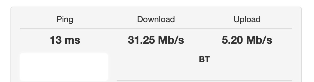

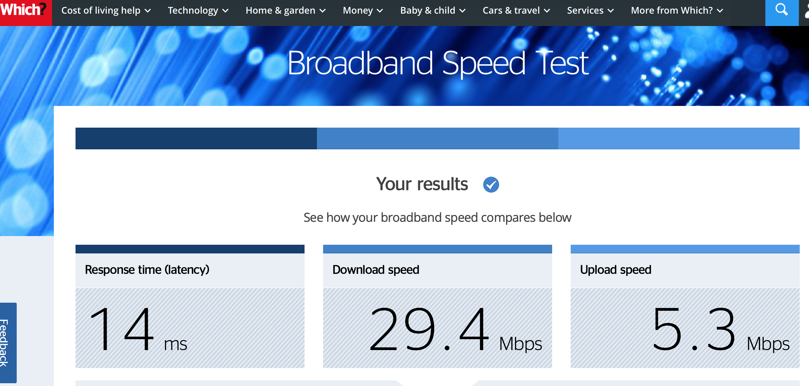

Mmmm interesting this.We have been with BT for 15 years and we still haven't got fibre, all I get when I get in touch with them is, it's due to be installed in the next 5 years....
Thats been said for the 15 years, I will be long gone before they install it and it also will only be going to the cabinet, so it's not going to be much better than what we get now.
The first screenshot is from www.broadbandspeedchecker.co.uk
The 2nd one is from Which
Not a lot of difference between them. I have looked at Fibre Broadband prices and I am not prepared to pay the silly prices every month for something that I don't really need. We get by with BT's poor service really. Our broadband goes down quite regularly and we have got used to it, but saying that when we moved from our last address, 3 quarters of a mile away, we got nearly 56mbh, strange really even though we are closer to the green box now. There are several green boxes in our area that supply lots of new local houses, that may be the reason who knows
Still Rik's battery backup looks interesting, but do I need it, I'am not sure. Even though I am now classed 'At Risk' and we have the emergency system in our property, it wouldn't help having the system Rik as told us about, it won't help it would it. Although for mobile phone charging it would be a great help indeed.
