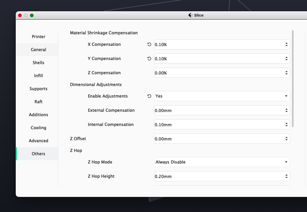

I have found what I think is a solution. On my slicing software there is an option to compensate in different axes:
The above screenshot shows the alterations to the settings that I have made. As default the compensation facility was turned off. Your software may use different words but this might be a guide.
The result is:
This print has almost finished and there is no sign of it lifting or distorting. Probably the best result I have ever achieved.
