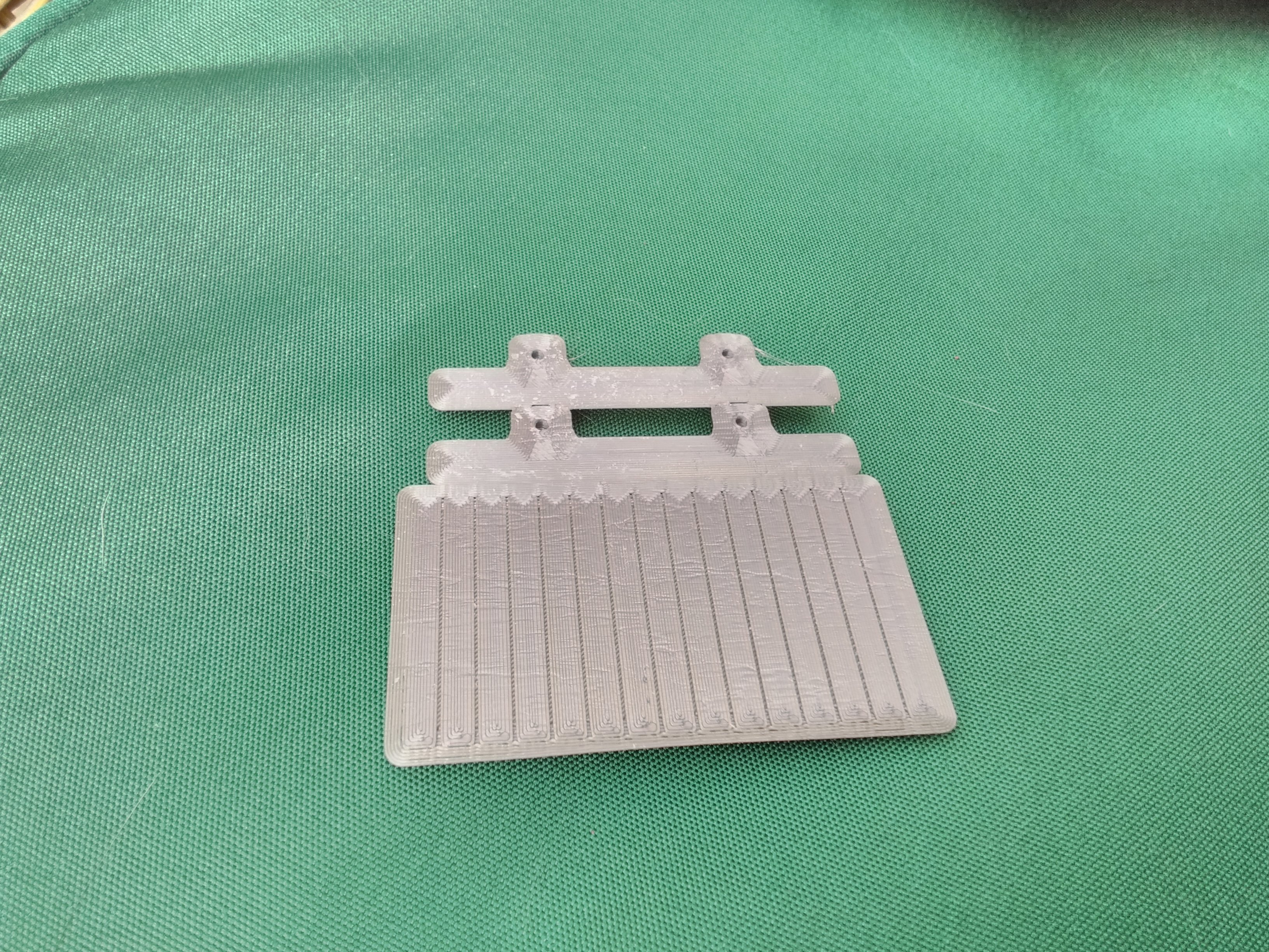

I scrape off the prints and the old Pritt with a broad-bladed chisel. I've not noticed any scoring or scratching of the glass. As it's heat resistant, it's quite tough.
There is a very slight unevenness on the lower surfaces of the print, but I don't think it's obtrusive. This is the print bed side of a 7mm scale chassis (with five-layer brim) I've just printed. As you can see, to my mind, it's fairly smooth.
