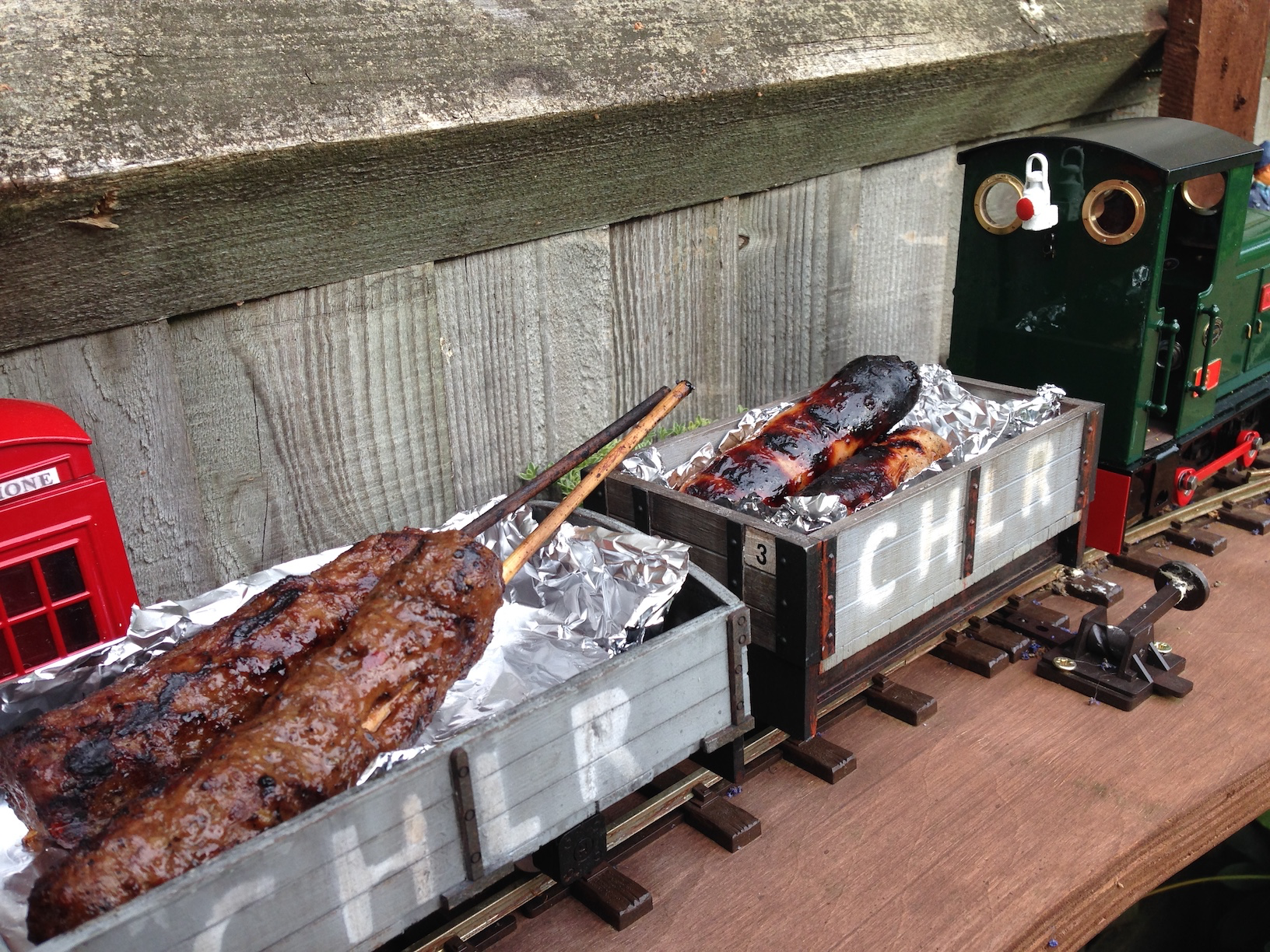

Post by markoteal » Thu Jun 02, 2022 9:30 pm
As a runner of a BBQ train on my previous line(see below) I love this - great idea
