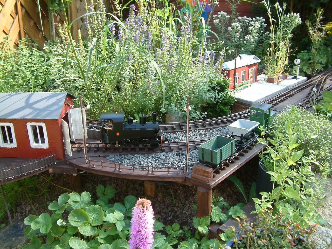

Hello, my name is Peter, I am a retired teacher (having taught Physics and IT) in secondary education and live in the Rhineland-Palatinate, sw Germany. Due to a major redesign of our garden I suddenly got the necessary space to do what I have dreamed of for decades: Setting up a garden railway. Taking out two big trees last fall gave me the space to build a circle line round the garden shed this spring. So I went for it.
First steps included building a dry wall and perform terraforming to cope with the slightly slopy terrain. About 2 tons of material had to be brought in to have the ground for the station and the rear part of the track.
Since 2 tons of material were not really enough to build the station right on ground level, I had to "level up" track by building a wooden structure to place the tracks on. To camouflage this I planted different kinds of perennial herb around it and so improved optical impression (hopefully) a little bit.
These plants, by the way, are also the reason why the railroad line is prefixed "Bumblebee": Hundreds of these insects populate the inner section of the railway during summer having breakfast, lunch and dinner.
A removable bridge is also there to be taken out if I want to bring the lawn mower or garden shredder to the lower end of the garden. Also a railroad crossing near the rear fence of the garden.
Track
The line is in 32mm gauge, 16mm per inch scale, so it represents a 600mm (something) narrow gauge line.
All track is homemade. I have been using Code-200 rails made from aluminum, wooden sleepers (1 by 1 cm cross section, 7 centimeters long) cut from oak wooden strips and drilled using a brass made pattern to make drilling more easy and more precise.
Rails are fixed on the sleepers using bolts (brand name "Spax") 2mm in diameter and about 1 cm long. Each 2.5 centimeters of track the rail is fixed by 4 bolts. I have built about about 40 meters of these tracks which took me about 1 months. That was hard work. :-) For the switches I have used the very useful information on https://www.16mm.org.uk/resources/ A great resource for a beginner in garden railroading like me!
Sleepers have been treated with timber preservative to avoid rottening in the moist weather we sometimes have here. All track is accessible easily for maintenance and repair.

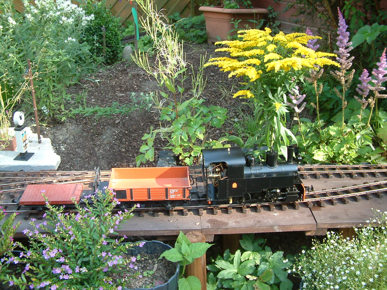

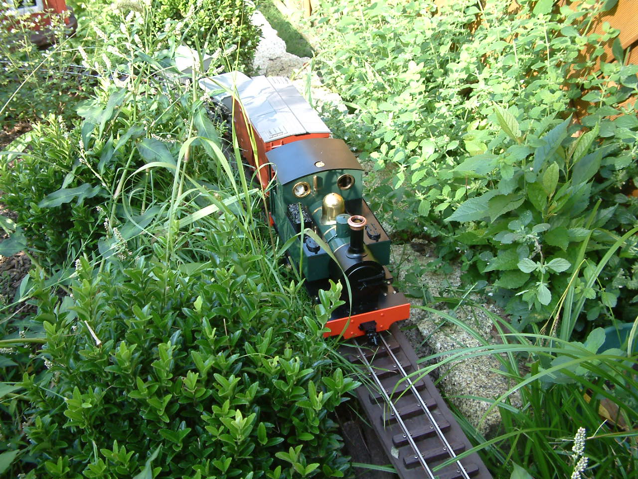

I own two live steam locos made by Accucraft: A Decauville 0-6-0 and a Talgarth 0-4-0.
The Diesel is made by IP engineering (Cabbed lister loco):

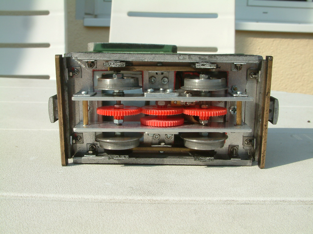

and has been a little bit "pimped" up. I built a drive unit made from aluminum with both axles are driven:
Besides I have built a tiny radio control unit (another hobby of mine is amateur radio and electronics). I'm now really happy with my rolling stock but another Diesel engine is to be projected in coming winter.
Cars are made by LGB and have been re-gauged to 32mm. They will get better couplings but I'm still thinking of what exactly I will be doing to solve this problem. Original LGB couplers are far too large for my point of view.

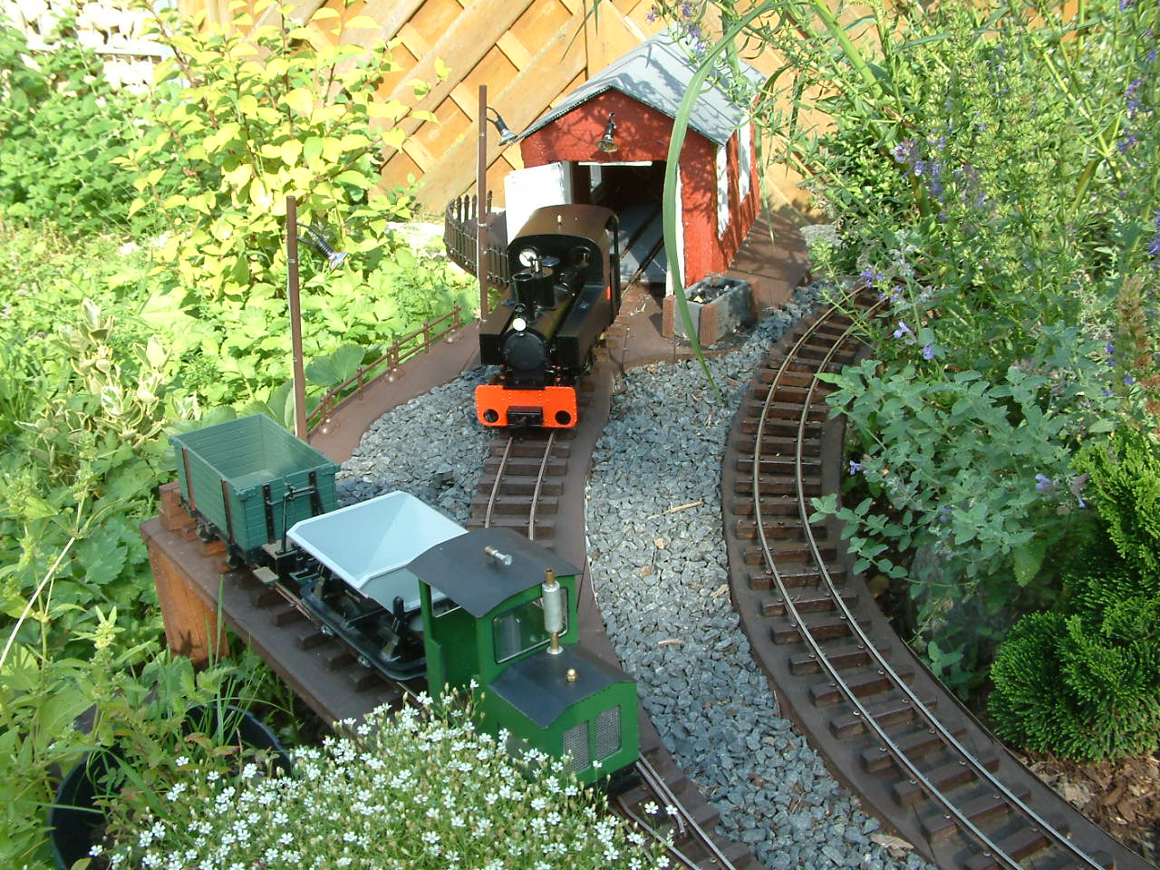

Buildings and other stuff
The loco shed is home made from a material that is available in hardware stores and used for thermal insulation of buildings. It's brand is "Styrodur". Fitting the walls together is easy and durable with hot glue.
The station building is an old "Playmobil" "Kindergarten" that has been re-painted, equipped with real windows and lighted with 2 bulbs inside.
The lamp posts outside are made from wooden sticks and equipped with small 6V bulbs and reflectors. All in all I have about 10 light bulbs paralleled. Currently I am projecting a microcontroller equipped solar power charger to charge the 6 V lead acid battery automatically to its maximum and then switch on the lights in the evening and switch them off when battery voltage drops under the critical border of 6V so that the battery will not be damaged by excessive discharge. This will be accomplished hopefully before fall. Let's see. :-)
Track
BTW: Track is not powered because I only run either live steam locos or a Diesel engine that is battery powered.

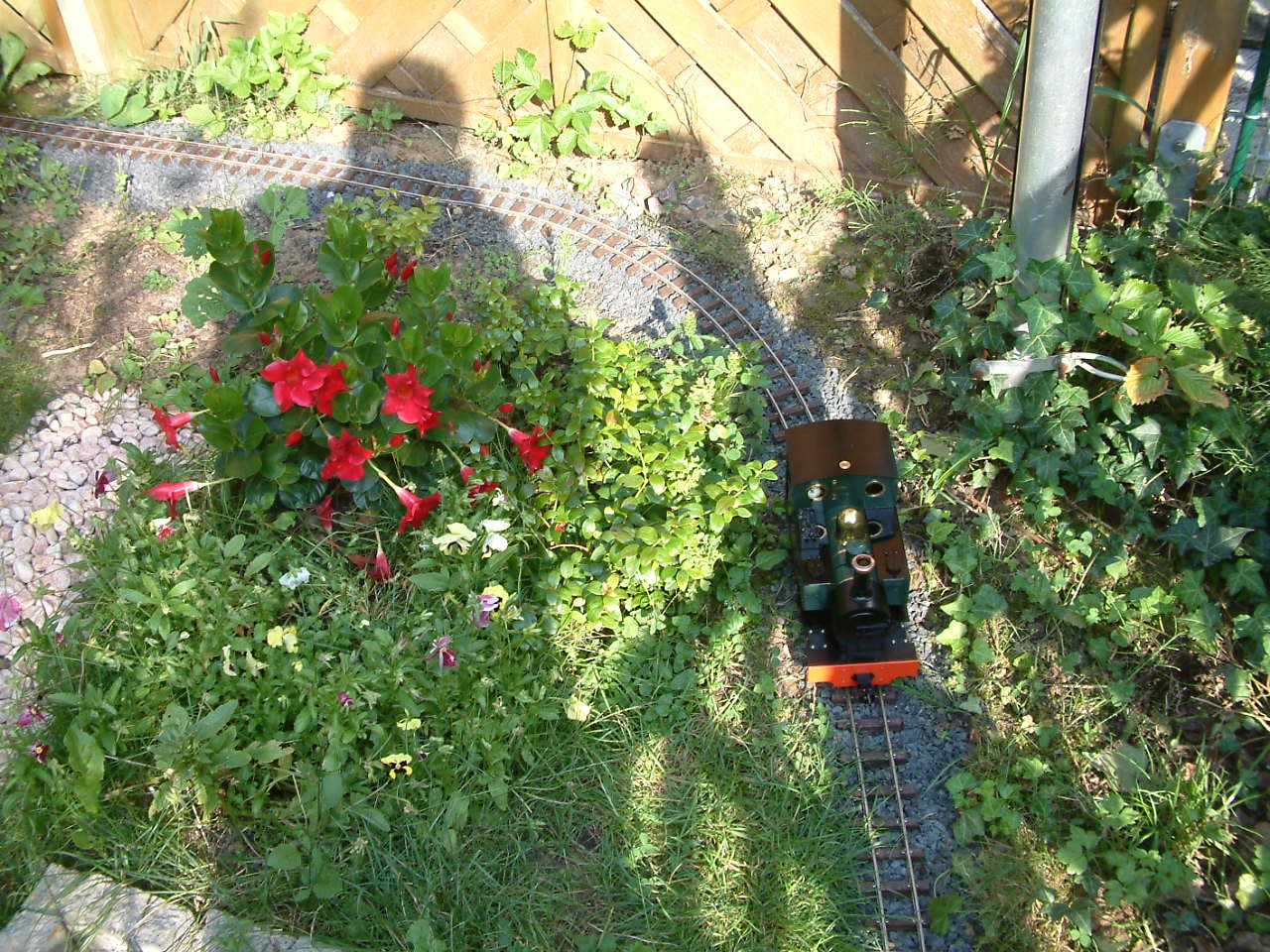

The last days were pretty chilly here and the weather has not been that fine. But yesterday we had a relatively warm and sunny day where I got the opportunity to take some more pictures.

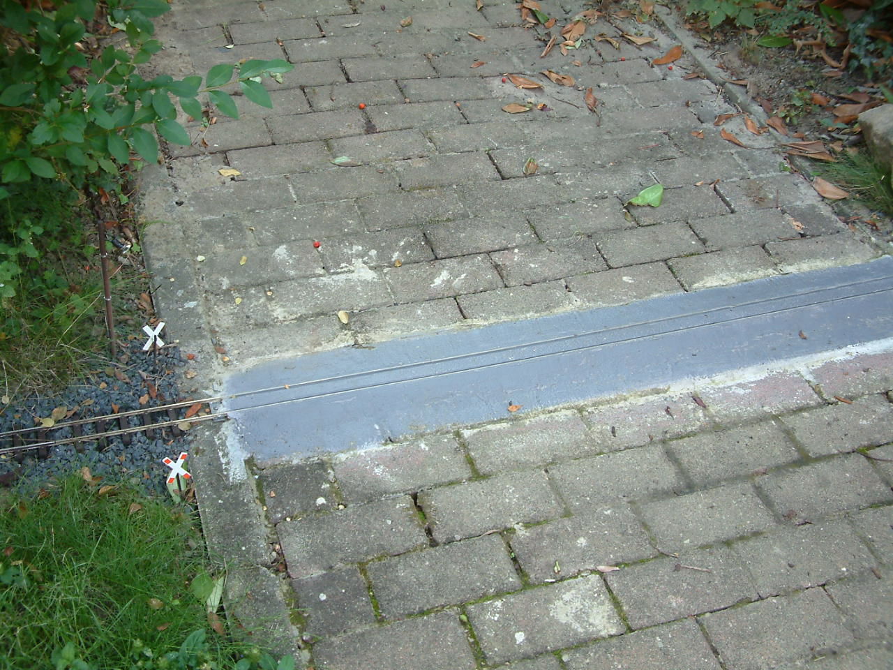

The rear part of our garden is the place where I could put the rails right into the ground because its the highest part of the terrain. The ballast for my track is made from basalt that I had purchased for the foundation of the dry wall and since I had left about 1 ton redundant I decided to use it for track laying even if it seems a little bit overscaled as you can see from the pictures. With still having about 900 kg "on stock" I don't fear the usual vanishing of ballast for the next few years.
Let's turn back to the "front part" of the layout...
Behind the station after the curve the track is still on the elevated section but I tried to camouflage it with herbs and a flower box close to the track to disguise the construction. For next spring it is planned to place some rocks close to the construction and have something like a railway dam. OK, I think I have to cut herbs a little bit by now, it obviously looks more like a "jungle railroad". ;-)

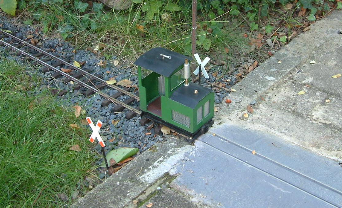

A final word concerning the railroad crossing at the rear end of the garden. It crosses a small path leading to the rear entrance where we leave and return with our bicycles. Thus a rugged pathway had to be built. The tracks for this section are made from Maerklin Gauge 1 material (Code 200 as the rest of the track) which is made from nickel silver which can easily be soldered (in contrast to aluminum). I had cut sleepers made from copper covered PCB material for electronic circuits and soldered the rails directly onto these sleepers. The sleepers have been fixed with bolts into plastic screw anchors to the stones of the pathway.
Since I don't use track power I did not isolate the rails from each other.
After the track has been found OK and 100% correctly gauged I used rapid-hardening cement, filled the center between the rails and the outside, cut out the space for the wheel flanges with a screwdriver's tip as long as the cement had not become dry. That worked fine.
So, that's all for today. And, by the way, thanks for this interesting forum. I have come here because I found the link (iirc) on one of the "Mark Found Garden Railway" videos in the comment section on YouTube. These great videos gave me a lot of inspiration to set up my railroad.
Bye, Peter
