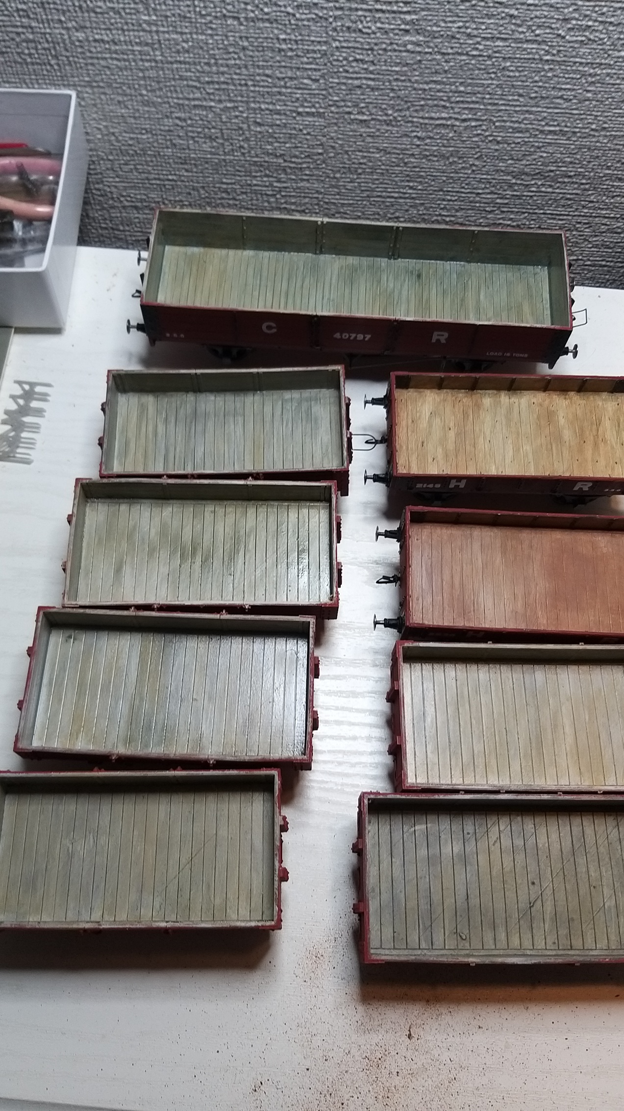

Some Highland Railway wagons I painted using life colour paints, the bodies are resin, I lined the floor with a thin piece of ply to give the real wood and grain effect.
David
David

They look nice
