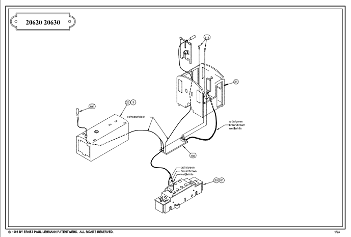

The exploded circuit diagram is not particularly helpful. The wiring to the socket mirrors the wiring to the motor block in terms of colour coding which would imply that two of the terminals ought to connect to the motor - or maybe not?
LGB20620 wiring.png (33.29 KiB) Viewed 8147 times

This loco appears from the linked diagram to have a 3-wire motor - block.
This means that on one side the motor and track connections are tied together within the motor-block.
You would normally isolate the motor and track connections from each other.
This means adding an extra wire for the second motor connection.
Apologies if this is an insult to your knowledge-level.

As Phil said there are 3 wires on the motor block, white and green are for the motor, and brown is not connected to the motor, so I assume as Phil said, for the track connection.
Now, I soldered wires that link to the motor and connected them to the remote control system. The locomotive runs smoothly now. It's a good experience, thanks.

Have you connected wires directly to the motor, and have bypassed all the other wiring?
I ask as the LGB wiring convention is that white and brown are track, and green and yellow are motor.
You do not want any connection's to the wheels or skates (if fitted). - You do not want power to get from the track into the loco, or your battery-power to get out to the track.
