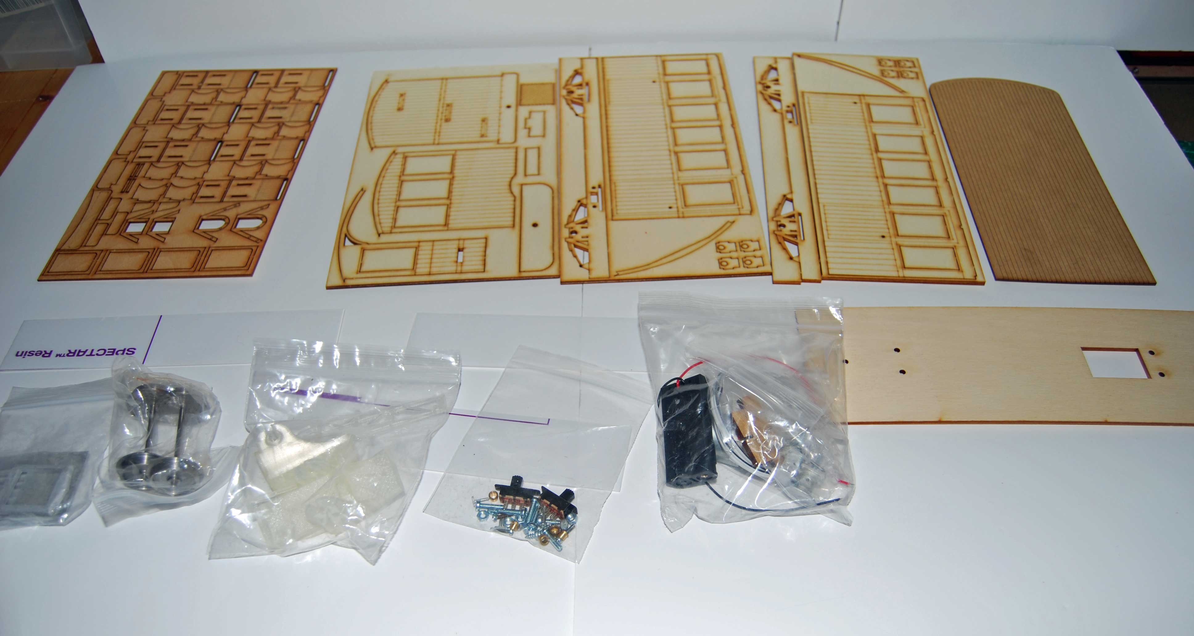

So below is my Kit of Parts for the Railbus, and the instructions they look very comprehensive.
I have a question for builders of these "wooden" kits, the instructions talk about using superglue or two-part epoxy, I would have though a good water proof PVA, thoughts please:
I will keep you updated, but only significant photos, but a full account will be on my blog, which I will link to.

Jimmyb wrote: Sat Feb 13, 2021 12:50 pm
I've never actually built one although i do have a couple in stock to do and PVA would be my first thought. OTOH, superglue does set faster, IF you can keep it under control ( something I always find difficult).
Peter B is the expert with mdf kits.
Posts: 5713
Re: IP Engineering Rail Bus
Post by Peter Butler » Sat Feb 13, 2021 2:57 pm
philipy wrote: Sat Feb 13, 2021 2:18 pm
I have a question for builders of these "wooden" kits, the instructions talk about using superglue or two-part epoxy, I would have though a good water proof PVA, thoughts please.
Expert.... no, experienced..... yes!
Like all simple questions there are numerous possible answers. I am a strong supporter of PVA adhesive and whenever I can I do prefer to use it. True it takes longer to set and needs to be held in position whist drying, it gives a stronger joint over its entire contact surface and is less likely to fracture if impacted. It may also help to dull the sound of hollow vehicles. I see no advantage in using waterproof PVA unless you are planning to completely seal your model both inside and out. MDF and thin plywood may be effected in humid conditions so I never use my stock in the rain and always store them in boxes.
Superglue does work very well on wooden kits and I frequently use it on kits from Jerry Irwin following his instructions on-line. It makes for quick and strong joints where mortise and tenon type fixings are located. It is also easy to remove excess adhesive by simply wiping away. A combination of the two adhesives is often the most suitable method but may take some experience to identify where to use either one.
I would not choose to use epoxy adhesive on wooden kits.
Useful tips .... do NOT use superglue to attach window glazing.
If painting overlays separately first, use 'Canopy Adhesive' to attach to the body panels.

Peter Butler wrote: Sat Feb 13, 2021 2:57 pm
Philip and Peter, many thanks, I will stick (pun wasn't intended) with PVA, I have some craft PVA that has worked well, and because of the relatively slow setting it gives my fat fingers time to "adjust" and clamp the work.

Posts: 5713
Post by Peter Butler » Sat Feb 13, 2021 4:03 pm
Canopy adhesive is described as a.... 'flexible, clear, fast drying adhesive designed to bond plastics to almost anything'.
To my way of thinking, 'almost anything' incudes MDF or ply overlays when applied to a sealed or painted, smooth surface, plastic or not. I use it frequently, and it works.
It allows sufficient time to apply adhesive to even the largest overlays before drying, any excess can be removed with a damp cloth when wet, or by rubbing when dry, without leaving any residue.
If superglue is used for overlays, any excess cannot be removed without damaging and permanently marking painted surfaces.
