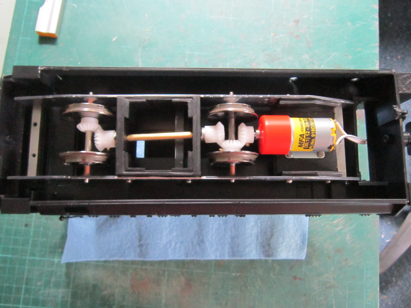

Post by Peter Butler » Mon Dec 21, 2020 6:30 pm
I don't know how much space you have overall in the chassis length but I have used this method which is a strong 4WD link using a similar motor to yours.
If you want more info about gear supplies let me know.......

Interesting Peter. However the architecture of the chassis I am using would probably preclude that layout. Not averse to bevel gears but I am looking for a vertical motor mount and a very positive locating of the gears in relation to each other, i.e. within a yolk with bearings pressed in for the axle and to limit side to side movement of the gear within it fixed to the axle and the motor in a fixed position perpendicular to the axle. I also want to retain the chain and sprocket 4WD, it is sort of related to the prototype.
If push came to shove and I had to replace the chassis too I would stump up for a complete PDF Baguley unit. But thanks for your input, Max
