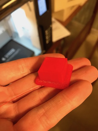

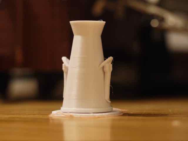

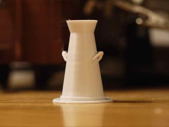

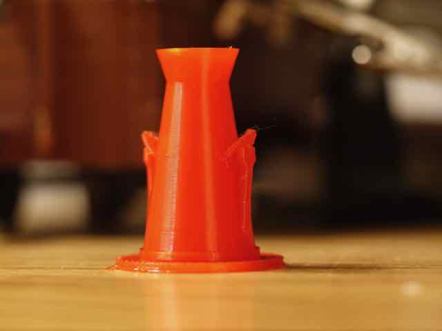

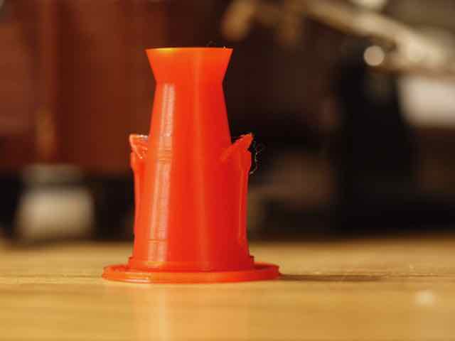

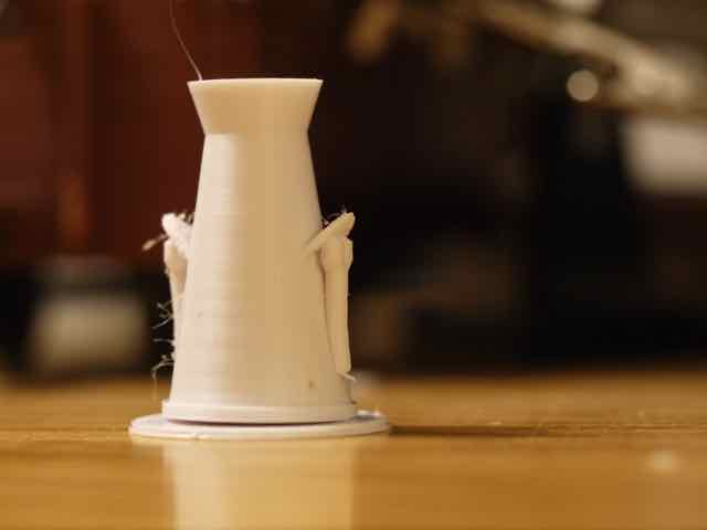

I printed the churn out several times with different settings to try to get a sense of the printer and what difference these made - standard resolution vs high (or even ‘hyper’), with/without supports, different types of filament (PLA/ABS). Fortunately they were all usable (as I need some milk churns!) though with noticeable minor differences. Probably too minor to photograph well until I put some primer on them, but anyway, here’s what they look like straight out of the printer:
Standard resolution (PLA layer height 0.18mm) - print time 40 minutes
Hyper resolution (PLA layer height 0.08mm) - print time 1 hour 57 minutes
Standard resolution (ABS layer height 0.18mm) - print time 47 minutes
High resolution (ABS layer height 0.12mm) - print time 1 hour 39
High resolution (ABS) no supports

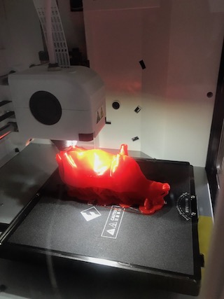

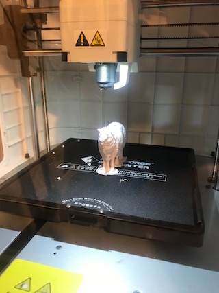

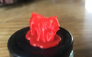

As you can see, I wasn't able to resist downloading some livestock from Thingiverse...
Still no CAD work required, just a bit of scaling to make things suitable for 1:19. (Hence my Google history mainly now being queries like "how tall is a chicken?"...)
The white ABS is the perfect colour for a sheep...
- Posts: 7967
Re: Adventures with a Flashforge
The quality of those prints certainly lends weight to the argument that you get what you pay for. Actually, I was surprised at how reasonably priced the printer seems to be.

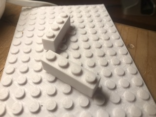

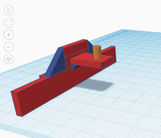

I've been working on a 'lego wagon' for my sister's children. I bought them the Tesco trainset last Christmas in a not-so-subtle effort to get them into garden railways (I'm just waiting for them to persuade my sister we should build a line in their garden) with a couple of open coaches for Playmobile people made from The Works boxes. I thought I'd make them flatbed wagons this Christmas, with a Lego top, so they could build their own superstructure. So I've been playing with Lego from Thingiverse, which has lead me into discovering parametric 3D designs and downloading OpenSCAD... and also into doing a little bit of designing of my own in TinkerCAD in order to create buffer beams with Tesco-compatible couplings.
TinkerCAD I am hugely impressed with. It has an extraordinarily well designed interface - I'm used to 3D drawing packages having a steep learning curve, but this is a remarkable piece of software which has clearly not just been through many iterations of user testing but some very focused development. It's incredibly quick to get going and produce something I can throw at the slicer and get printing. I will say I did buy a cheap graphics tablet at the same time as the printer, as I find doing these things with a mouse virtually impossible (hats off to those who manage it) but even so it really has a low threshold for actually producing something! Just as well, as I need to get these wagons sorted before the last post goes...
I think I'll start a separate thread for the Lego wagon, and the tribulations arising...

Hi SimonSimonWood wrote: Tue Dec 15, 2020 6:08 pm TinkerCAD I am hugely impressed with. It has an extraordinarily well designed interface - I'm used to 3D drawing packages having a steep learning curve, but this is a remarkable piece of software which has clearly not just been through many iterations of user testing but some very focused development. It's incredibly quick to get going and produce something I can throw at the slicer and get printing. I will say I did buy a cheap graphics tablet at the same time as the printer, as I find doing these things with a mouse virtually impossible (hats off to those who manage it) but even so it really has a low threshold for actually producing something! Just as well, as I need to get these wagons sorted before the last post goes...
You might find my most recent blog post useful. I've walked through how I drew the parts for a Southwold open wagon (nearly 200 screenshots). Rather than ploughing through the whole thing, I've indexed some of the more useful techniques at the end.
Though, as you say, TinkerCAD is remarkably intuitive.
https://riksrailway.blogspot.com/2020/1 ... -with.html

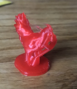

Meanwhile I've moved on from printing livestock to people... When Trevor's 4415 driver came through, I was already printing my first human, and a knight of the realm no less.
But can you guess which one?
"Great men are forged in fire. It is the privilege of lesser men to light the flame."
Then I threw Trevor's pre-sliced driver at the printer. In this case I did break off most of the supports before I put him in the cab of 4415, but otherwise he is as-printed.
Look at the fingers!
There are several hairy filament bits that need tidying up, but that shouldn't prove tricky.
