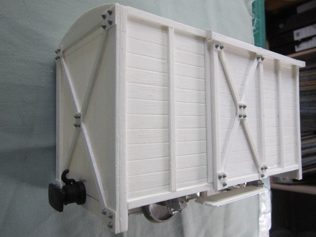

The only thing I'd add to what Peter and Philip have said, is that I use a specific tool for scribing boards, door frames etc. onto polystyrene sheet....
I do all my scribing with an Olfa P-cutter that I bought 40+ yrs ago. It is still using the original blade as I keep it just for scribing plastic. These days the tool is called an Olfa PC-S and the handle shape has changed, but it does the same job......
https://www.olfa.co.jp/products/product ... ail/32/270
Tamiya also sell a badge engineered version under their own label as a 'Plastic Scriber II'.
In use the hook shaped blade of a p-cutter removes a long spiral piece of swarf leaving a clean v-groove in the surface of the plastic.

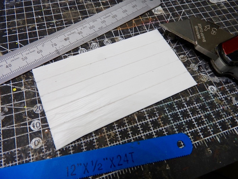

This is how most of us do the scribing on Plasticard mate.
1. Mark 10mm lines spaced equally apart. Don't worry too much if the last one is smaller in width. Just place the smaller width at the bottom of your build all around.
Also there is no need to buy expensive tools to mark the grain. Just use an wide toothed modelling saw or like I and others do, a hacksaw blade with a short tooth by inch blade, eg: 14 (tpi) 18 (tpi) etc. Even the junior blades are ok, but I find them hard to hold. The more pressure you put on the blade will dictate how deep the grain is. I start with a deep grain, then less pressure for lighter grains. You can also use the back of safety blades, but I prefer small flat screwdrivers heads. I also actually use the bigger hacksaw blade to mark the 10mm lines first, then use the same blade for the grain. And yes you can smooth the rough bits that will appear in the scribing and marking out the board lines especially for the edges, sometimes I will leave them to get a more "rough wood" look.
2. Depending on how much you want to "stain" the piece depends on how much base coat you put on.

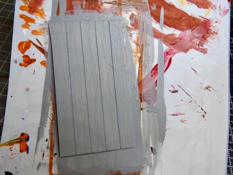

Light Base Coat ...
= Light Stain
Also wipe your brush first before applying the paint. Too much and you won't get the effect you want. I also use an old sponge to wipe the excess off if I have put too much on.
3. Medium Base Coat...
= Medium Stain
4. Dark Base Coat...
= Dark Stain
I tend to go for light to medium stain, it's the same for whichever colour you use. But remember the lighter or darker the finished effect. the lighter or darker the finish is.
It's all about practice until you get what you what to achieve. Good luck and hopefully you will end up with some very impressive model builds.

Rod the planking wood grain effect is really great looking, a couple of questions, the base I assume is your favourite acrylic or enamel paint, however for the stain, this actual wood stain or a further coat of "brown" paint.
Re: Scratchbuilding a 'Rye & Camber' style coach
Hi Tom,
The base coat can be any colour you like. I do like to use grey, but I also use white which is good for the brighter colours. It can be "stain" or again whatever colour you what to use. If it is grey of course for the top coat, then just use that.
If I want a grey top coat, I use a thin black and wipe it off before it dries for in-between the planks scribing, it gives and makes them standout more.
Stain can be a wash or proper stain, but I really only use stain's for bare wood. It's all practise and fun really to see what works for you. I generally use off cuts and bits of what ever material I am using to see what effect I can achieve. Sometimes I do get it wrong.....
Try things out and have fun Tom. Thats what our hobby is about isn't it, having fun and enjoying what we do hey.
