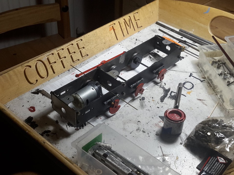

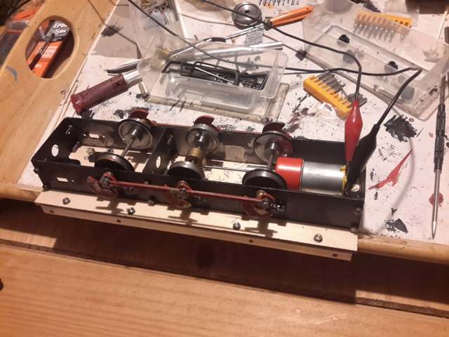

Well, Time flies. I have progressed my little loco on a bit. I have asked around, and IP tin shunter bits seem to be like the proverbial rocking horse poo. I will therefore, have to put a body of my design on it. (Possible disaster alert.) I am now trying not to let it cost me anything but I will probably have to buy some Plastikard, MekPac and (definitely) screws. Brass Tom, is a bit scary for me. But you never know!
So far, I have removed the gearbox as it was not up to the job. The wormwheel is fitted with a 12BA x 1/8” slotted head grubscrew, tightening this with any force at all results in the screw slot splitting and it still not being tight enough to attach the wormwheel to the axle to drive six wheels. I did consider Loctite (the blue stuff), but you risk gluing the lot solid as the wormwheel is captured by the 3D printed gearbox. What I mean to say is that the assembly would have to be glued in situ, therefore there is a (high for me) risk of getting glue on the bearings in the gearbox. I will find a railbus or some light duty vehicle to use it in. I managed to get one of those Indiana Jones Lorries (you know, the German thing with the “canvas” (plastic) cover on the back) before the prices on EBay went potty. It might be a fit in there for its use on rails.
Instead of the proposed gearbox, I have used my usual method of a Slater’s wormwheel assembly, 4mm/2mm coupling and a MFA 15:1 Motor gearbox. (Yes, these were in my bits box, for a long abandoned idea.) I thought I had a sheet of Aluminium to make the footplate, but I couldn’t find it, so I have used some 3mm Plywood, braced with 10mm x 10mm x 1mm Aluminium angle iron (the (6BA) screws are in temporarily until I can get hold of some shorter ones). The angle iron is predrilled to accept the, yet to be made, body on top.

- Posts: 5713
Re: IP Engineering 0-6-0 chassis build
Really interesting project, let your imagination run with this. Good start with sturdy chassis and great motor, they are reliable and powerful and used in many of my own locos.

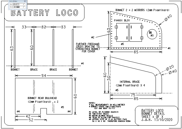

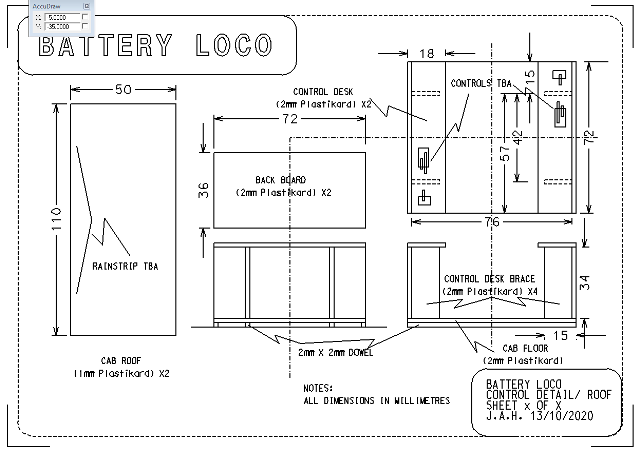

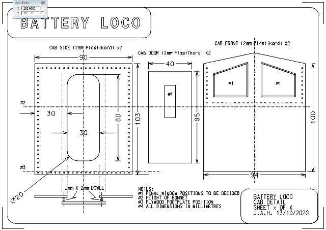

Cheers Peter, I have always liked IPs tin diesels, for all their quirks. And there are a few. There was a chap on 'tube who had mounted a motor in the bonnet, driving a huge gear on the middle axle. I nearly copied him but the bonnet appeared so full of motor, he only had room for a small battery. Which probably leads us on to LiPo or the like. I am a bit apprehensive about these. Anyway, who would have thought my favourite lesson in school was Technical Drawing? It was. So heres three drawings. Bonnets, Cab inside and out. The mists are clearing. I have even sussed out how to make a (non working) pantograph. But thats still in my head.
- Attachments
- BONNET13102020.PNG (50.91 KiB) Viewed 24253 times
- CAB13102020.PNG (48.04 KiB) Viewed 24253 times
- CONTROL13102020.PNG (44.87 KiB) Viewed 24253 times
- Posts: 1184
Very professional drawings there, it's always good to have a plan. Again, looking forward to seeing your progress.

- Johnnie1000
- Posts: 67
- Joined: Tue Oct 09, 2018 8:53 am
- Location: Staffordshire
Thanks Old Man Aaron, I have been doing diagrams like this for longer than I can remember

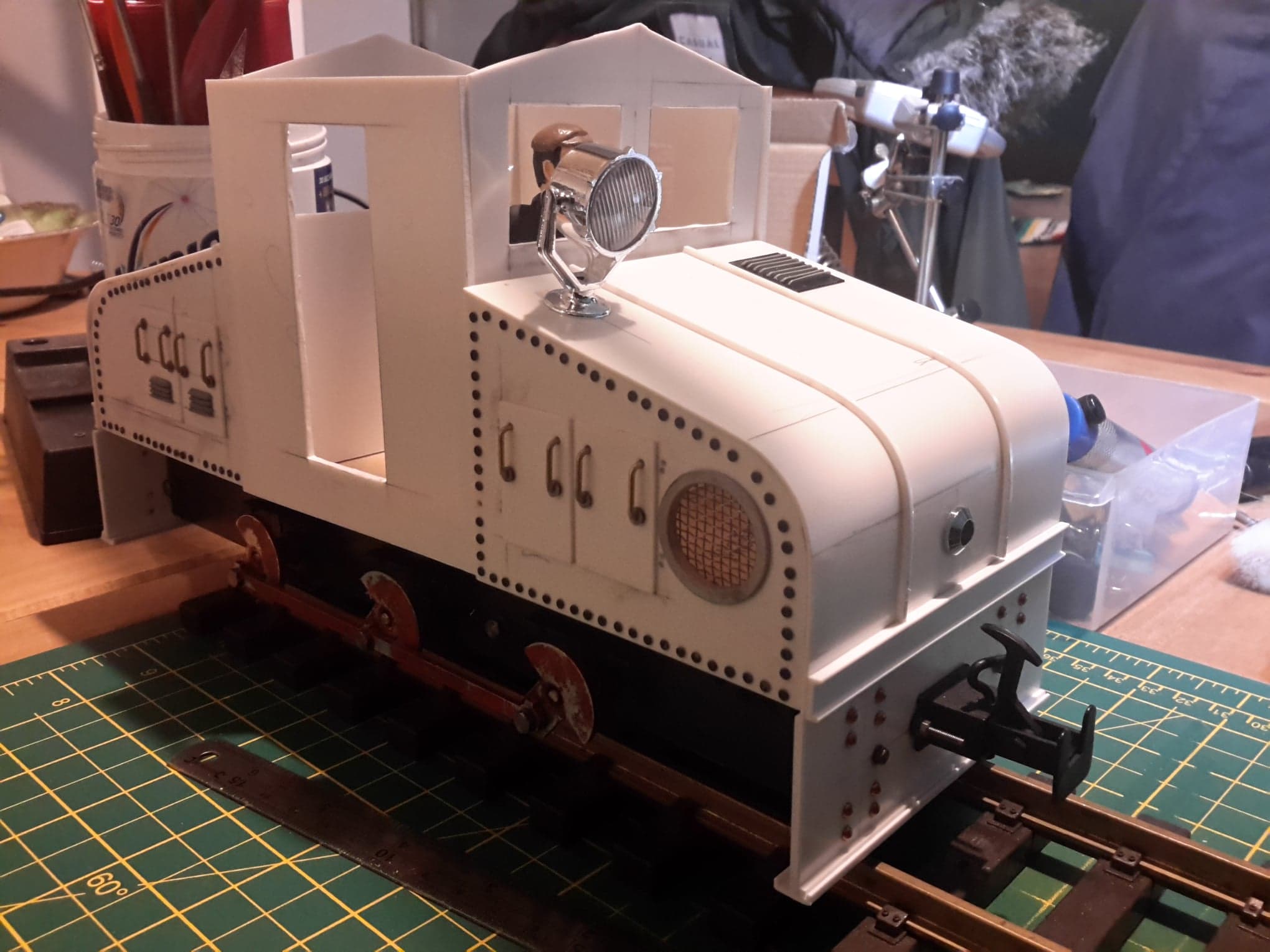

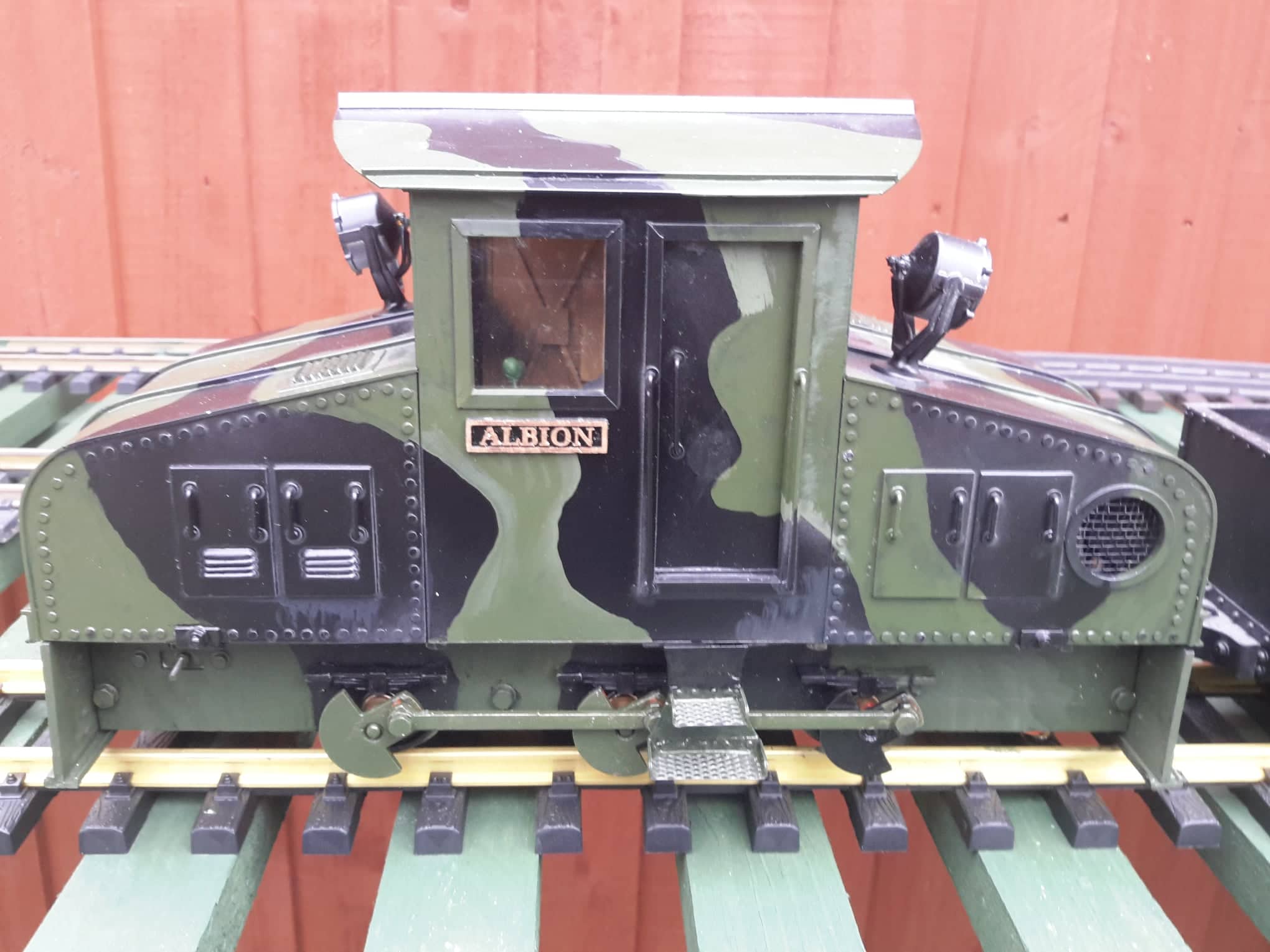

As my semi retirement slowly morphs into retirement, I found a little time to continue with this. The bonnets are done apart from one or two little bits, filling my hack marks and painting. The cab is just mocked up with Sellotape to see how it looks, it requires a lot more fettling before its good enough. The Jury is out on the addition of windows in the side of the cab, I am 60/40 yes at the moment. Looking through my drawers (oo er missus) I think I can cobble together enough bits for radio control. ahh well we will see! There is still a lot of work to do, but it keeps my brains working, which is good, in these times. If I am not back before Christmas, I would like to wish you all seasons greetings and a happy new year, I do enjoy reading about all your escapades.

- Posts: 5713
I do like the look of that, nice detailing.
- -steves-
- Posts: 2473
That looks really really good and thoroughly impressed with the drawings.
If that is plasticard for the body, how on earth did you get that nice rounded effect on the bonnet?

- Johnnie1000
- Posts: 67
Hello Steve and Rik, thanks for the comments. I am a bit of a newbie at succeeding with bending Plastikard. I remember my first effort whereby I used a paint stripping heat gun, with predictable results. I should have kept it as some sort of artwork. For these bends however, I borrowed SWMBO and her hair dryer. I marked a pencil line where the bend starts and finishes from the measurements off the drawing. Then using a steel ruler I got SWMBO (bless her!), in oven gloves, to hold down the Plastikard trapped between the ruler and the table. Switching the hairdryer on full, I wafted it over the portion of the plastic to be bent, while cajoling the plastic to bend. You will feel it "go", when it is hot but not melting (!) Dont go mad, just carefully tease the plastic. Stop and turn the it around and start again from the other end of the bend. Finish off by asking SWMBO for further assistance by holding the dryer on maximum and bend the plastic in your hands. Do this by warming the plastic, then placing it in the bowl of your hand and bending it with your fingers. Stating the obvious that you will stand a very good chance of burning yourself if you're not careful. Further to this it is not bent to fit, I bent it to a place that I estimated that the glue would hold it in position. Fingers crossed, it has.-steves- wrote: Sun Dec 13, 2020 11:22 am That looks really really good and thoroughly impressed with the drawings.

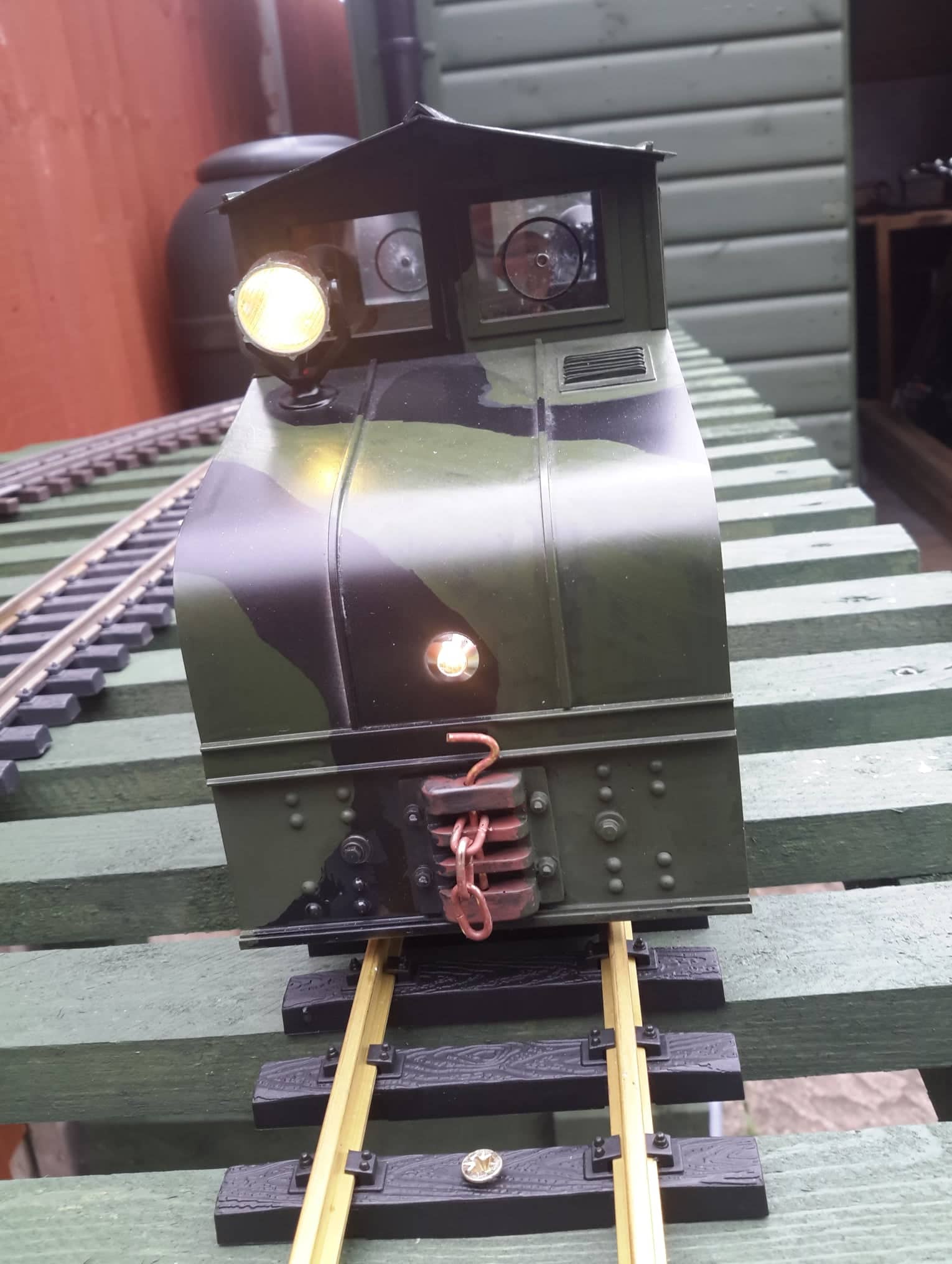

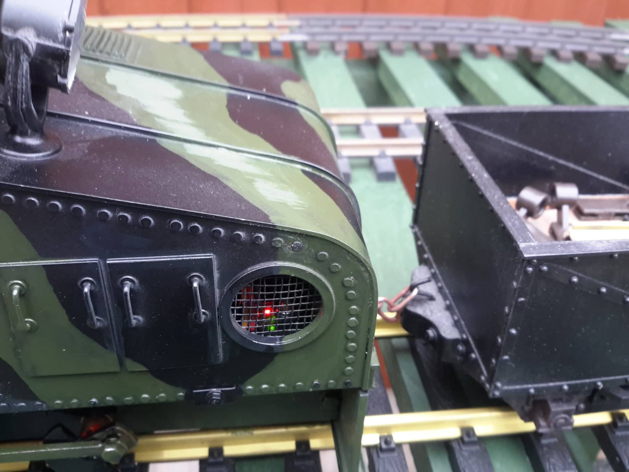

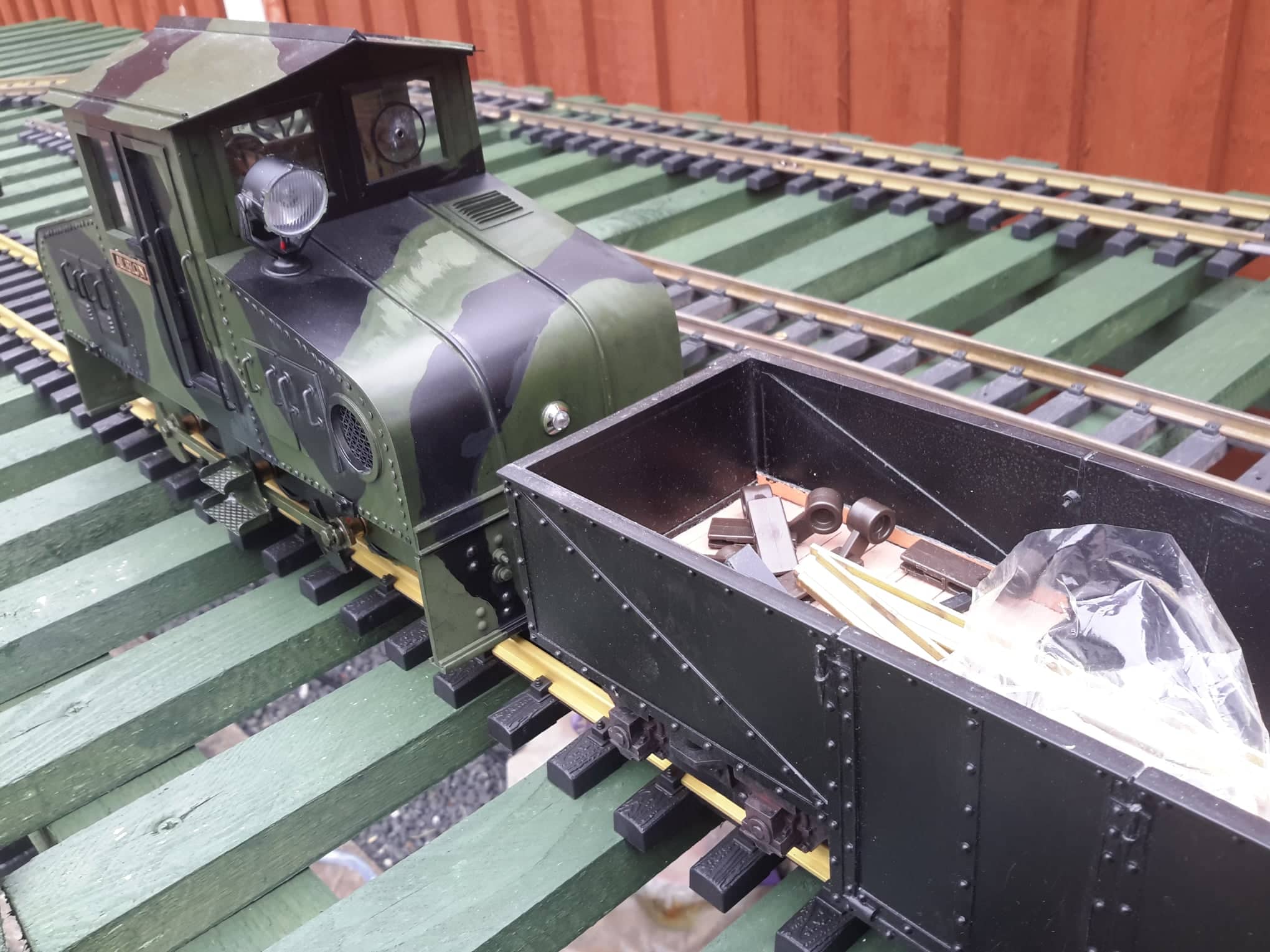

Blimey. Where does the time go? I relaise now I am not very good at keeping these threads up to date. Anyway, I took some good advice re: the cabside windows, I think it makes it looks wise. Anyway I'm calling it finished. So heres a few phots of Lockdown Locomotive No.1; a battery electric loco that is actually a battery electric. I still need to tweak a few things but it is essentially finished.
