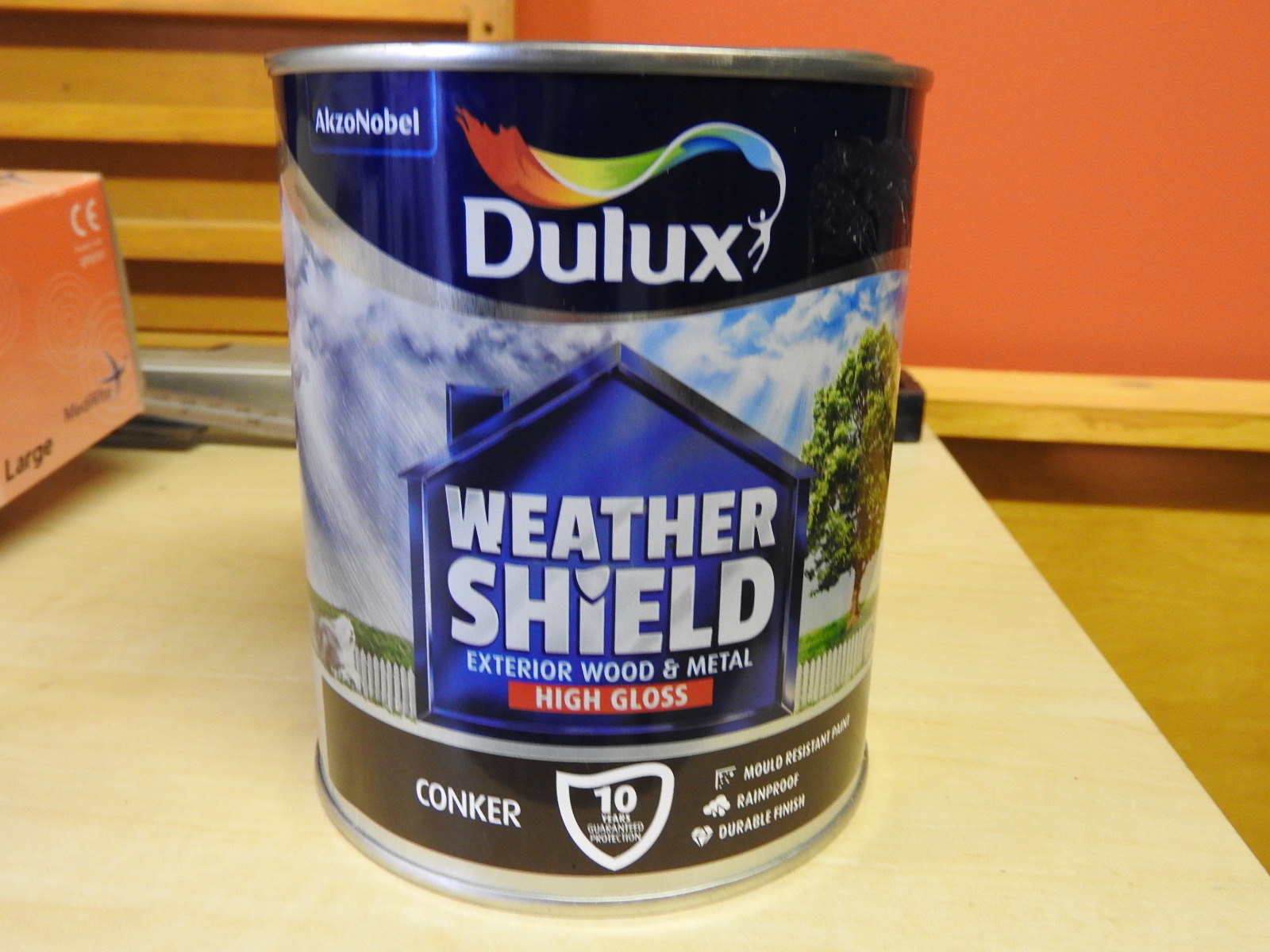

This one I used on my bridge and this is great stuff also, you can get this in different colours.
Unfortunately for some reason I can't load the photo even though I have before in my NEW FWLR thread..
