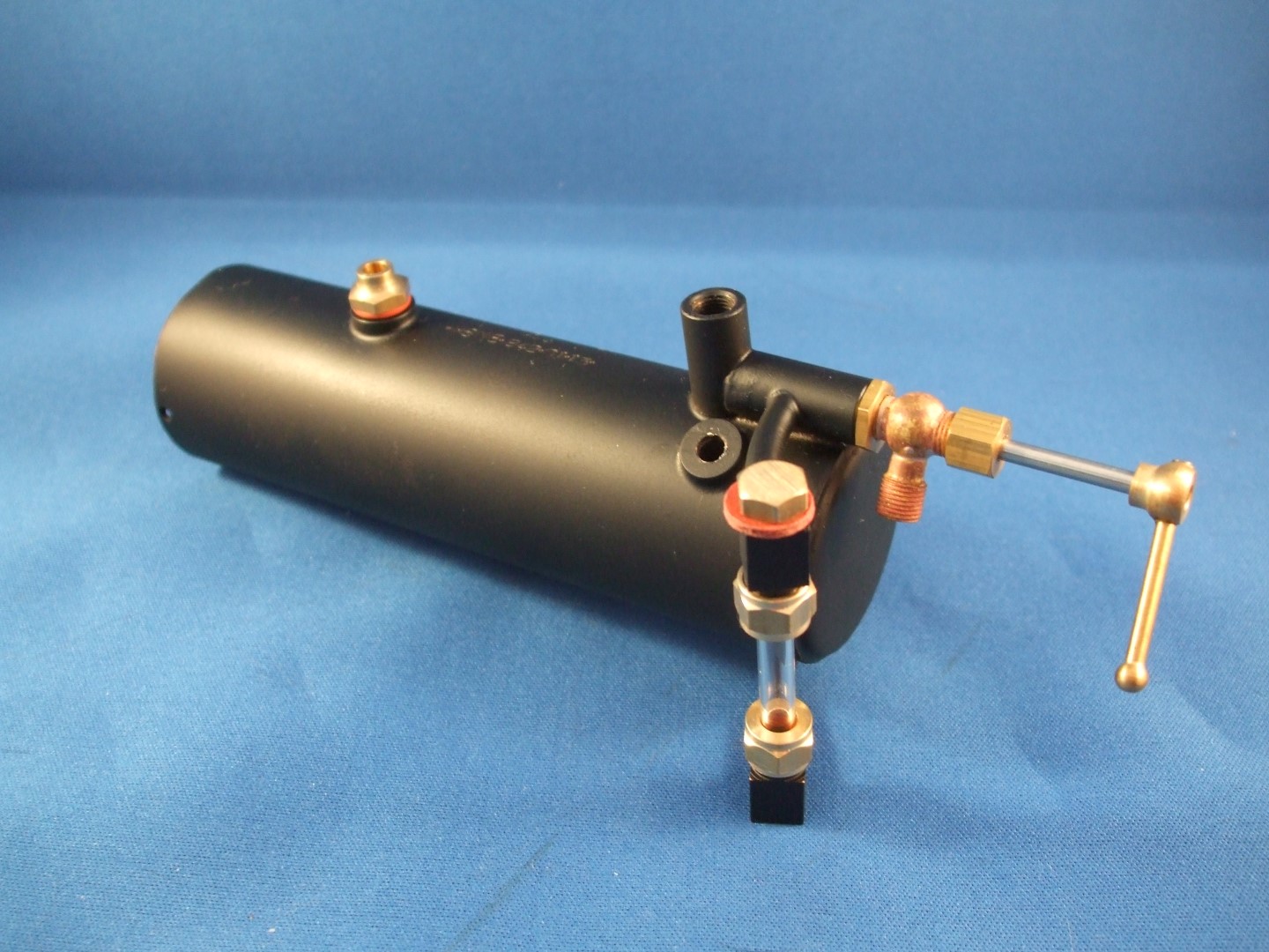

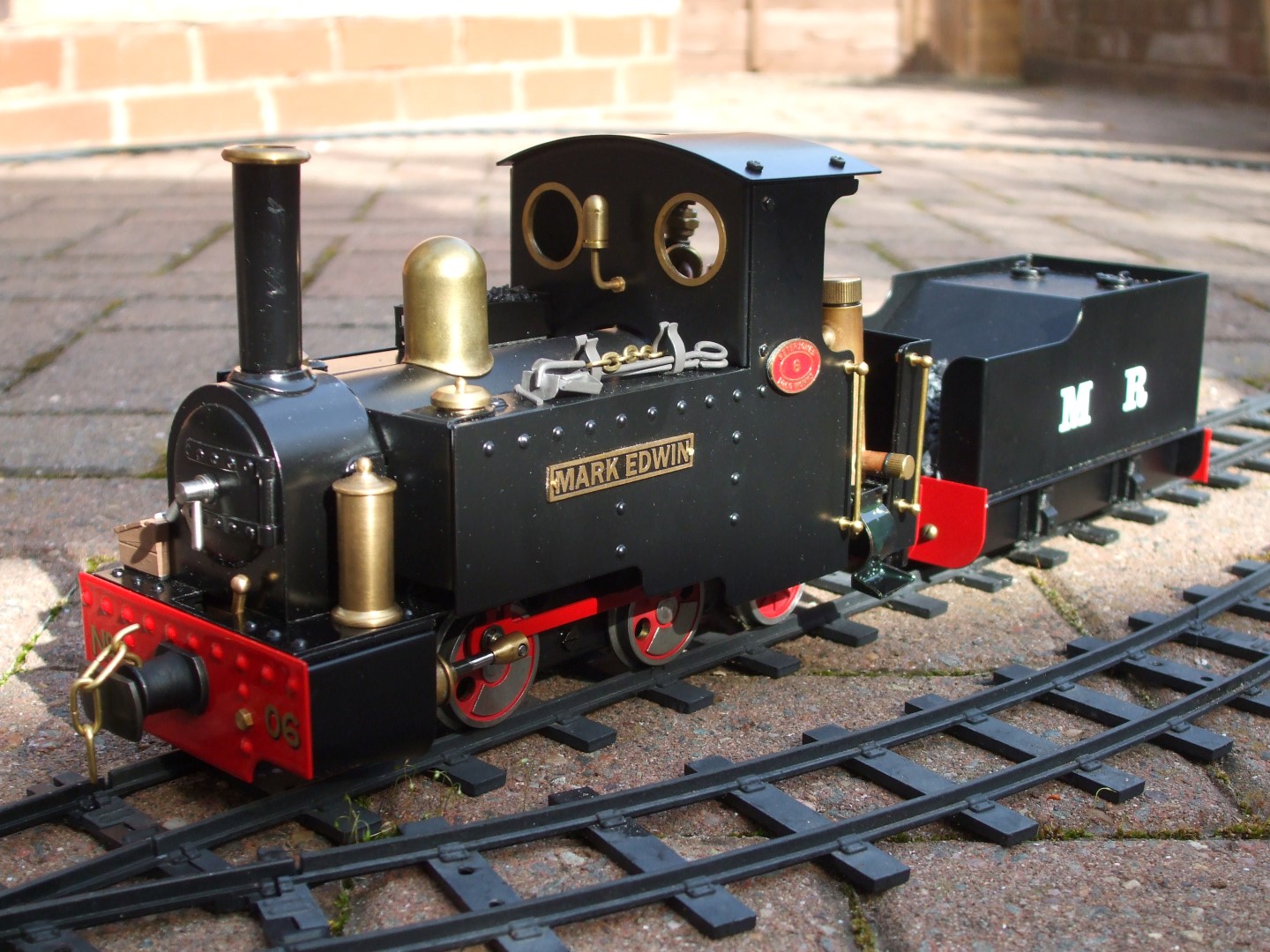

Here is an example of a 'Janet' type boiler with extra boiler insert for the installation of a pressure guage:
Here is an example of a Mamod loco using the same design of boiler:
Cab view showing pressure gauge:

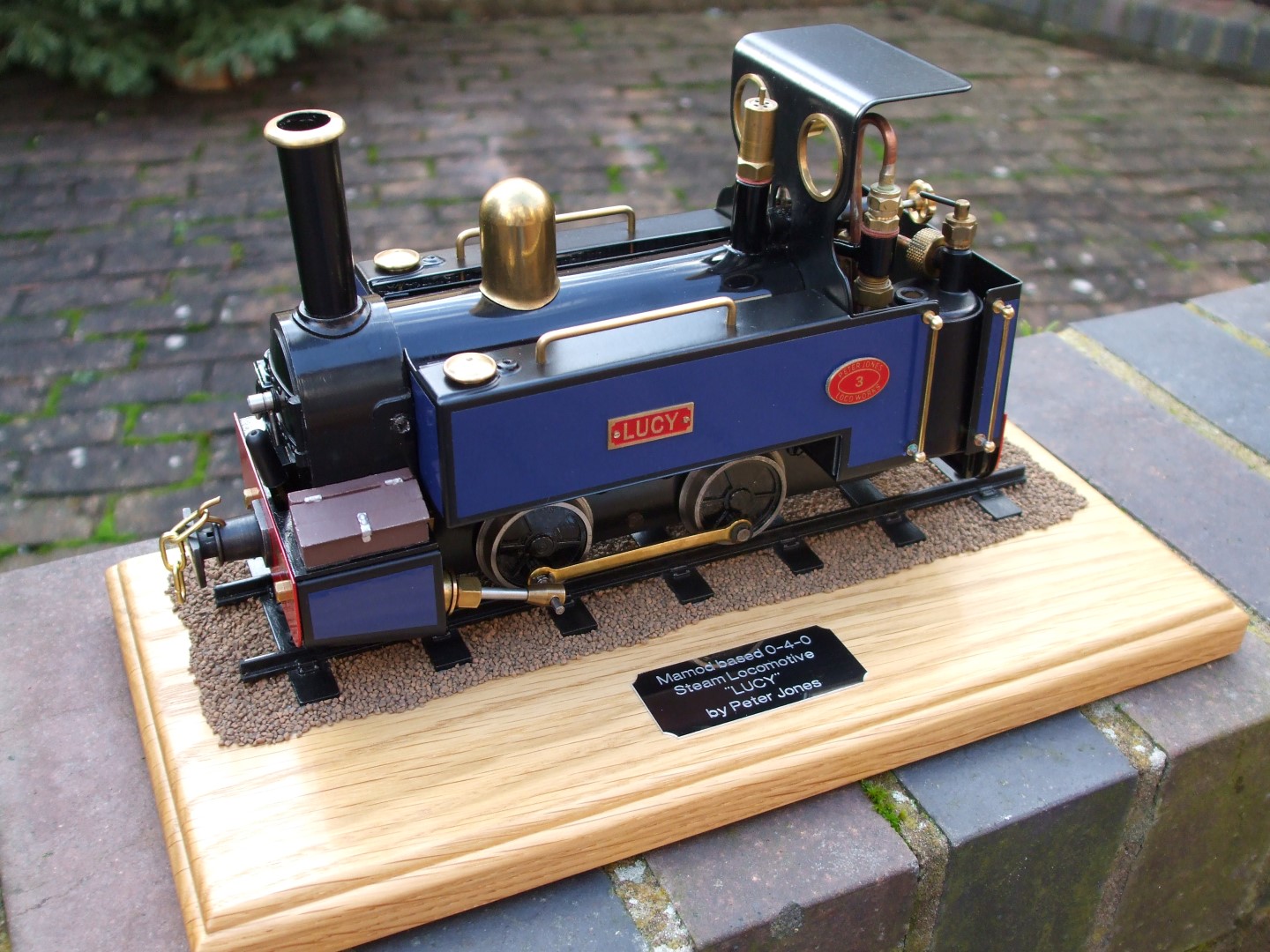

Here is an example of a loco with an original IP Engineering Jane boiler (same design as Dream Steam type boiler):
This image shows the pressure gauge position as fitted using a syphon type arrangement from the top of the sight glass:
