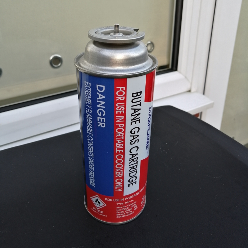

I teased the Kiwi group guys who because of their adaptor used screw-top gas cans, with this Bunnings advert. In contrast, 220g cans are more widely available. Since I sold my commercial gas steam loco I don't do gas filling anymore

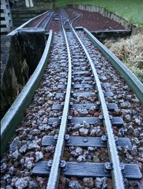

I'm also too soft to go out in the cold. This photo shows how only the raised line ices up

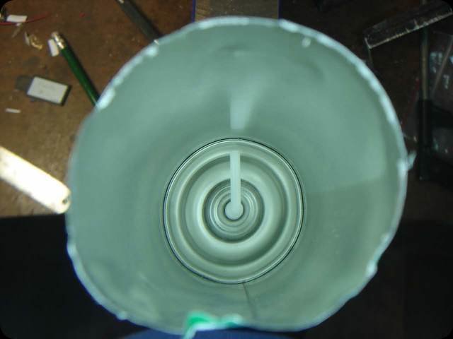

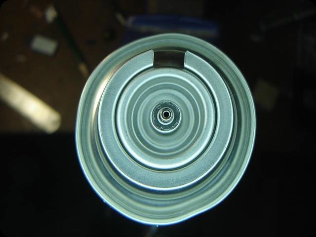

These images are worth seeing again to show the internal arrangement of the 220g can

The 220g cylinders are great Jimmy, but you can't get the last bit of liquid out when filling
gas tanks, due to that little internal plastic pipe - these cylinders are designed to be used on their side
