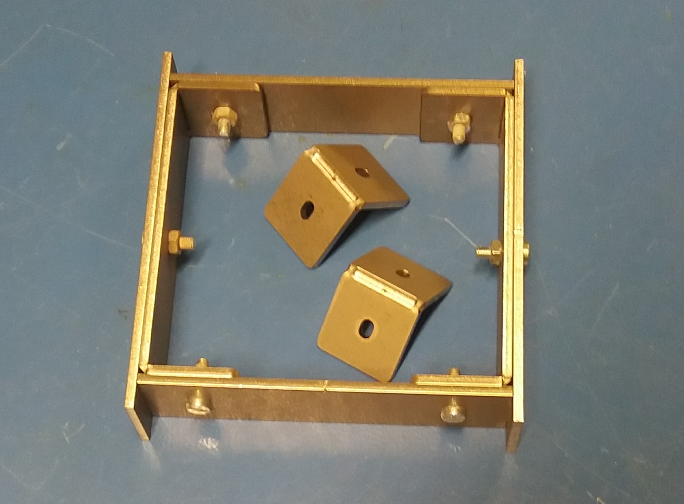

I cut a lot of decorative items from 2mm mild steel for one of my customers. Some of the items are irregular shapes and even when nested there is a fair amount of leftover material. I thought I might as well put that to good use so at long last I've started playing around with designs that utilise the capabilities of the laser. The aim is to make a chassis where parts can be bent by hand and bolted together. No need to machine frame stretchers, thread holes etc. This is the first proof of concept I have done. The frame parts are aligned using slots and tabs. The stretchers have slots cut in them so they can be bent by hand. Works well so I'll take that idea further.

The cut width (kerf) varies with nozzle size, gas pressure/type, stand-off etc. but generally tolerances are within +/- 0.1mm. If I want to ream a hole to 3mm I cut it 2.7mm.
Bend allowance is more tricky - there are formulas for that. Nothing to do with the laser really. However when I cut slots to aid bending, the final width is pretty much spot on distance between center of slots + 2 X material thickness.
