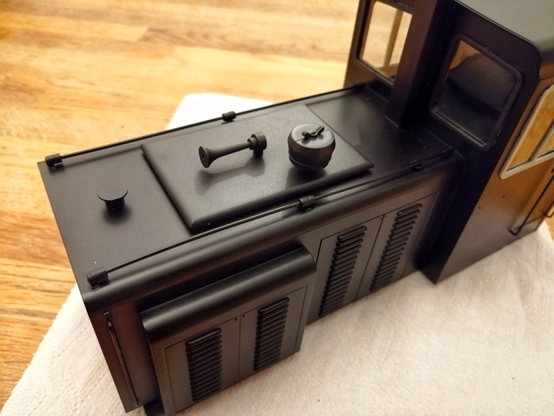

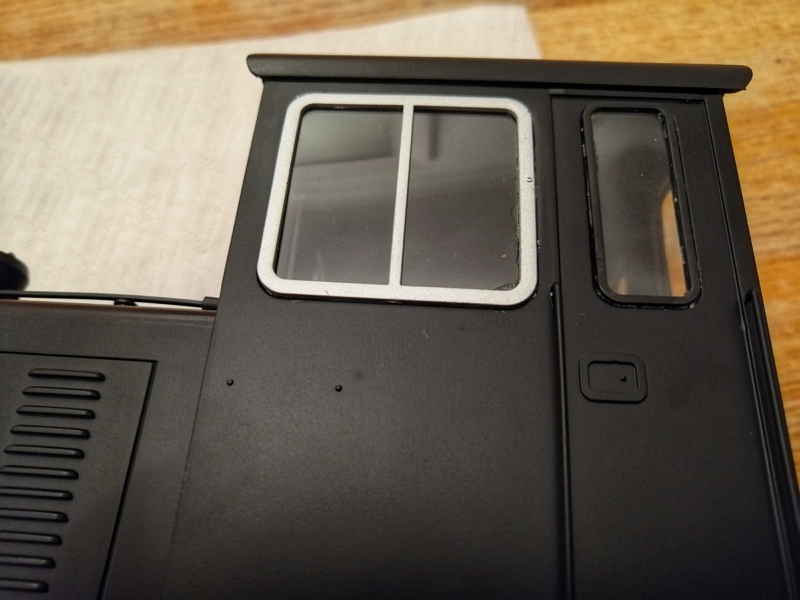

This time around I bought a brand new one, however, when I opened the box the body was damaged (bent grab rail, paint work scratched and a crack in the bodywork). Most of the windows have been glued in poorly as well:

I now have the replacement body, it isn't perfect (looks like it's been stored for ages as it was filthy with marks on the body) but hey ho time to move on with more exciting stuff like smoke units!
I drilled out the exhaust on the body and set up the smoke unit to test, no issues with air flow as you can see.
