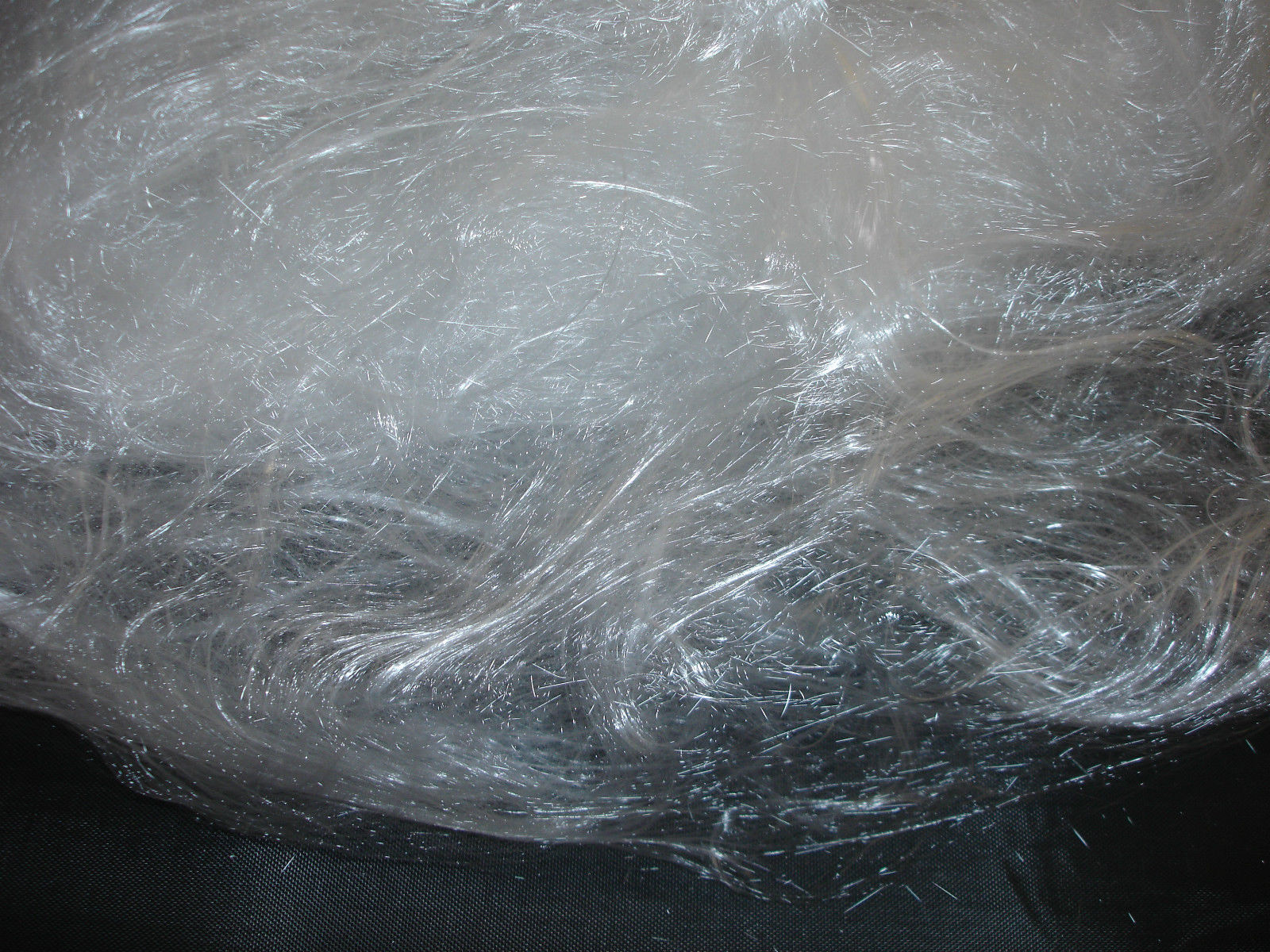

I'm wondering ifa GRP one might be a longer term answer, but I don't want to end up with a smooth glossy top surface, so I'm thinking that:
1) laying a chopped strand mat right on top of the resin might work? The problem is that the fibres will run in all random directions, which is the one thing that real thatch doesn't do.
2) I've found this long strand insulation and I'm wondering if it might be possible to comb it out into moree or less parallel strands and lay that on top? ( Yes I know that glass fibres are nasty and I'd need skin and breathing protection). https://www.ebay.co.uk/itm/A-Glass-Long ... 0891458078
I know that there are boat builders etc amongst us, and I wondered if anyone could offer advice on these thoughts or any other suggestions, please?

Sorry Philip, although far more familiar with GRP than I would prefer, I can't see your idea working I'm afraid,(hoping I'm wrong!) as to preserve it all you would have to wet out the glass' and I would imagine it will just become a very low relief surface albeit with straight striations instead of the criss-crossed ones.
