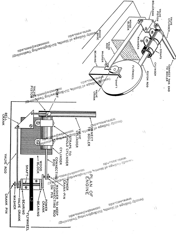

Post by Hancockshire » Sun Apr 26, 2009 8:00 pm
I found this cylinder design on the internet.
I can see that this cylinder could work BUT, i'm worried that if I build it and test it with steam, I think that it could just go BOOM! :cry:
SillyBilly
Post by SillyBilly » Sun Apr 26, 2009 8:06 pm
Should work if you get the dimensions and quartering right, doubt it'd go boom, just leak steam everywhere.

Post by mhlr » Sun Apr 26, 2009 9:05 pm
As what William said, it probably would if you got it all correct. It wouldn't be much use though!
