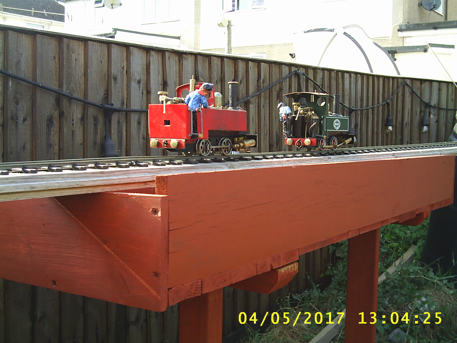

S2020152 (1).JPG (320.11 KiB) Viewed 139573 times
Aaron,
These are my two SL1s that I purchased April & May 2017. The red loco is only a Mamod because it retains the original frames, drag bar & smokebox. The rest is Janet specification. The green loco retains the original boiler, cylinders/pistons & wheels. The RWM regulator, lubricator & SV (set at 40psi) have proved very worthwhile in both cases. I've not had problems with loose wheels on the green loco, but the new RWM cylinders/pistons fitted to the red loco increased the piston thrust so much that the Mazak wheels moved on the axles & locked. As for hauling capacity, ten loaded Mamod wagons are no problem. I'll post a video sometime soon.
All the best.
