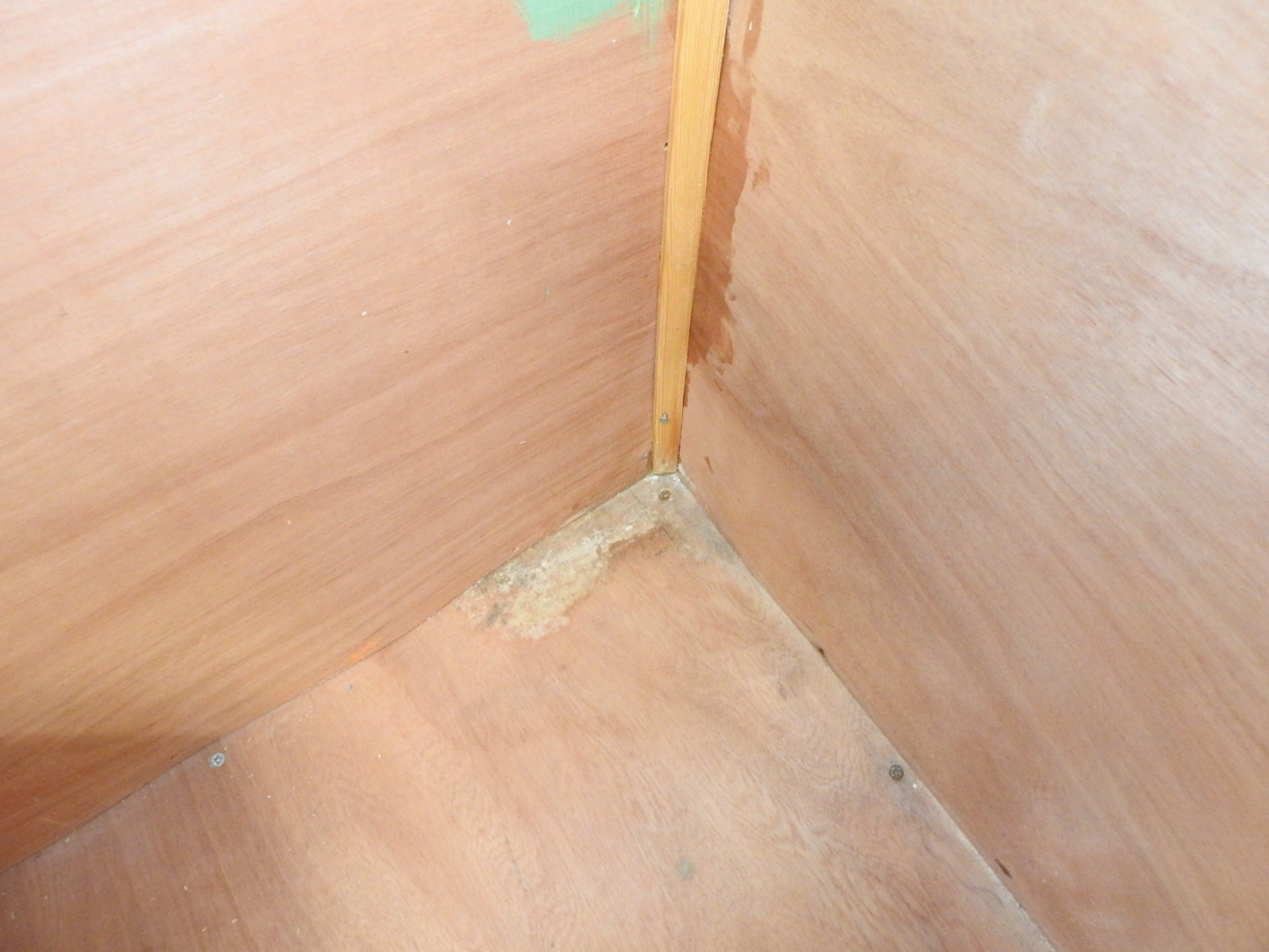

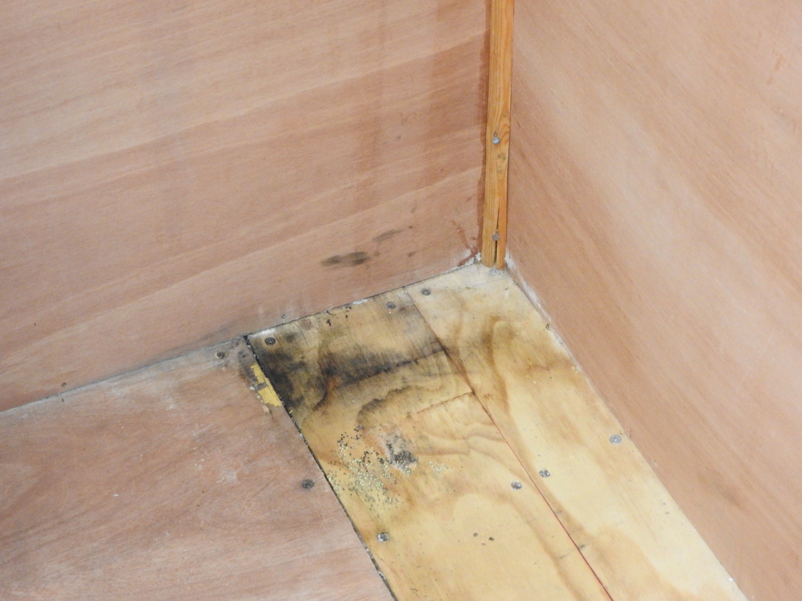

Not garden related, but i would like some advice on this please.
After selling this board and all the rest of my N Gauge stuff, save for some locos and wagons and some coaches for when the grandkids come round...
I found this in the left hand corner at the rear of the shed,
And this in the right hand corner.
The help I am wanting please is, can I use PVA watered down a bit to help keep it at bay and not encroach in to the shed, or would I need to buy the stuff that is far more expensive like the damp-prove stuff that I think is not really user friendly. Thinking about myself and the grandkids when they visit.
Any advice would be most welcome. :thumbright:

Got to say I would go unfriendly and use one of the cuprinol (or Thompson's?) Product. Something that has rot inhibitor.

First thing to do is identify the source of the dampness that is causing the problem. Until you cure that, anything else is a waste of money. However in answer to your original question, PVA can go mouldy itself, so it won't cure the problem and may make it worse.

The floor (and walls) appear to be made of plywood which will de-laminate if the source of the damp isn't treated first. I fear you will have to squeeze in the limited space you have to fix the problem before you, and your grandkids all fall through the floor!

As others have said, curing the source of the damp is essential. That in itself may be enough to solve the problem but I'd adopt Phil's suggestion and blast it with one of the cuprinol products. Once applied they present a very low health risk. (so long as you don't lick the walls!)

Peter, the shed is a proper wooden shiplap, the plywood is just covering the insulation on the walls and the floor is covered with marine ply, so I don’t understand why it has the mould.

Rod, your pictures appear to show damp ingress at the corners of your shed. Although the exterior is a shiplap construction, which is usually good at doing its job, there are joins at the external corners and that looks like the affected parts. Perhaps there are small gaps which could be re-sealed?
