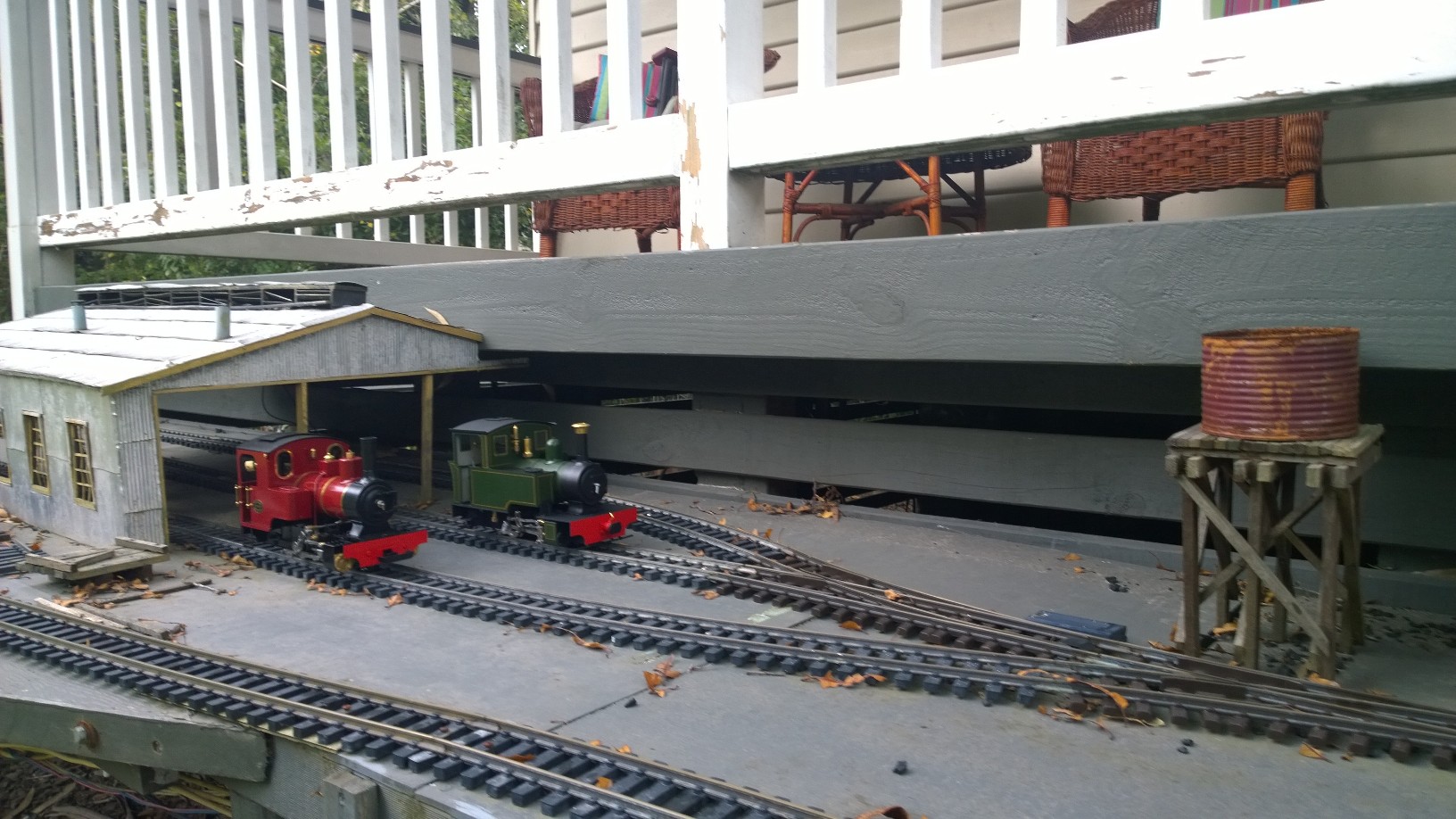

I currently have two locomotives, a handful Accucraft wagons, as well as a bit of European rolling stock.
There's my Roundhouse 'Billy', named George after its former owner. This loco was bequeathed to me by a friend. And there's my yet to be named Fine Line Models 'Alfie'. It's the only one in Australia (and the southern hemisphere!).
Unfortunately the weather outside is rotten at the moment so I can't go out and get any photos of the line for you so this is the best I've got.
IMG_3468 (1).JPG (203.42 KiB) Viewed 12088 times
I hope you enjoyed that, I shall post more photos of the line as soon as I can.

Sorry cancel that about the pics., they just showed up. Wow, that engine shed and water tank look superb. Think I know where your inspiration is coming from.

Sorry about the pictures I had trouble uploading them to the forum. Also the shed and the water tank aren't mine unfortunately they belong to my friend around the corner on his railway.

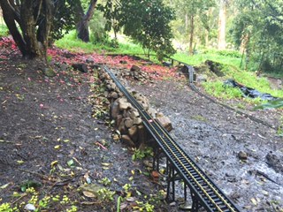

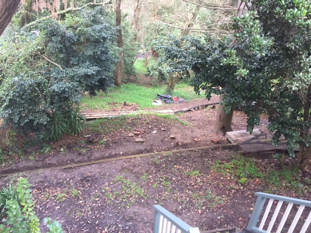

I was able to get outside today and get some photos of my railway today. So here they are:
Above: The rather large yard at Black Hill. On the right are two roads for arrivals and departures. On the left is a siding for the goods shed and in the middle is a through road for trains going straight to the balloon loop.
Above: To the left the mainline down the hill heads off through a cutting and to the right the line to the quarry.
Above: The line on the other side of the cutting. The cutting ends just before the bridge at the bottom of the photo the line then heads along the rock wall and into another cutting (currently covered in flower petals). Originally we were going to have a switch back, but the gradients were to steep. So to solve the issue we built a loop to gain height. The steepest gradient on the line is to the extreme right of the photo before the bottom of the loop.
Above: The other end of the line to the left just out of shot is where the line other terminus will be and the river port. To the right the line can be seen beginning its climb and to the extreme right the lines only intermediate station can be seen along with the bottom of the gradient up to the loop.
I hope that gives you a good idea of what the railway looks like at the moment. I'm hopping to finish off some of the rock walls around the loop this weekend, if the weather stays sunny. Work is often restricted here because whenever it rains the whole backyard turns into a slippery slide (one of the unfortunate things of living on a hill).

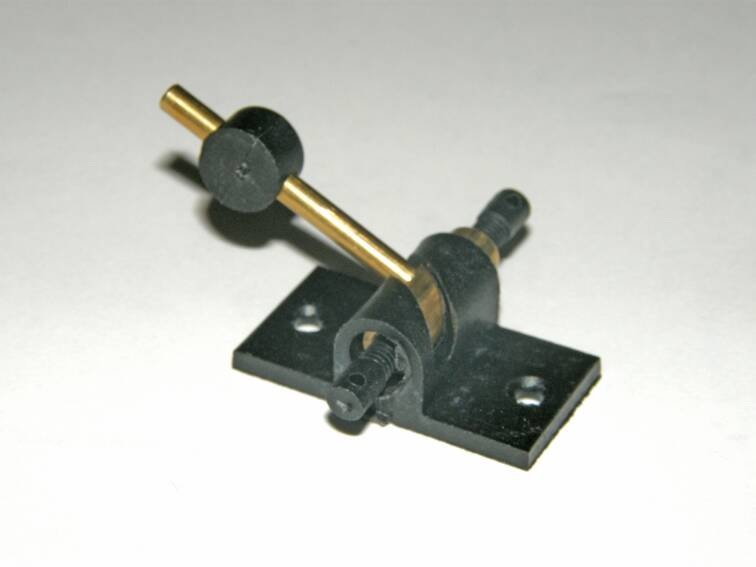

I'm currently trying to work out how to make point levers. As I don't want to have to buy them (which means shipping them from the UK). Does anyone have a good method to make point levers?

I have seen little brass bolts used as point levers. Cut short with a diagonal cut made in the tube.
I will see if I can find a picture.

Since you are going to the GSSU, have a look at the ones used on the GSSU portable track. They were made by Gordon Watson, based on the TenMille design.
The basic principle of the TenMille type goes back a long way in model railways. As the handle is thrown over it moves back and forth in the slot, so the push rod has to be able to rotate relative to the base of the handle. Throw adjustment is usually by forming a z bend, or an omega loop, in the point rod. The TenMille one is part plastic and this photo comes from their website.
What sort of workshop tools and skills do you have? A mill would be useful, but not essential, to form the slot, but the rest of it could be made with hand tools and soldered up from various bits of K&S brass tube and rod. Painted white they would vaguely resemble a VR quadrant lever.
Argyle sell a simple all brass point throw from Sunset Valley in the US, but it doesn't look much like any real point lever I've seen. A friend uses them and I find they work OK.
As Jim indicated, a small barrel bolt from the nearest Bunnings, or Mitre 10, could be shortened and modified to work in much the same way as the TenMille one.

I have decided to suck it up and spend some money on Tenmile point levers rather than make my own. But I will have a go at making some in the future. Thanks for the suggestions Graeme and Jim. I will remember them for when I do get round to making point levers.

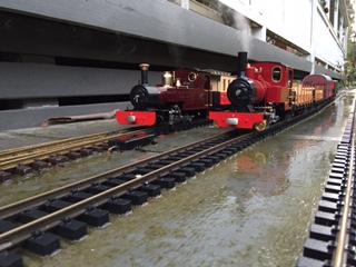

All went well today at my friends house. We had his new 'Silver Lady' and my 'Billy' (George) running around. I got some video which I will edit and upload this weekend, I also found some video of my 'Alfie' running which I will also get uploaded.

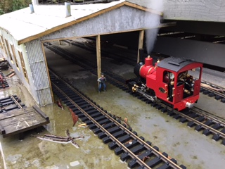

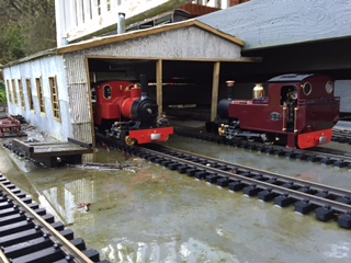

Here are the photos from my friends railway today:
Above: 'George' is seen raising steam outside the shed. Below: 'Silver Lady' is seen taking coal at the coal stage.
Above and below: The bridges on this railway have all been scratch built. As you can see there are a lot of them! The railway took about 18 months to build.
Above: Ready to go! George's safety valves have just lifted and his crew are ready to take the loco out. Below: 'Silver Lady' and 'George' wait to depart with their trains.
Below: Back at base. The locos cool down outside the shed after a few laps around the railway.

Nice pictures.
The rain makes it look like darkest Wales.

The SL looks good in that colour (FR Victorian Maroon I believe?). Mine is just 'Maroon' but looks red in bright sunshine.
