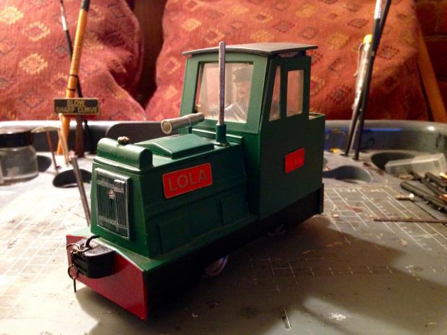

Hi - I love the topics on here that take you through the story of developing a layout or building a loco.
Sooooo I thought I'd do one - it's going to be about fitting my line's original engine with a new chassis.
The Castle Hill Light Railway's original loco is called Lola - for the history of the loco visit http://chlrailway.blogspot.co.uk/p/locomotive-dept.html

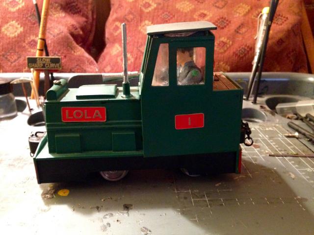

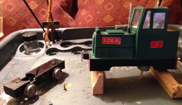

She has already been re-chassied once but I find she lacks adhesion and only being 2WD, find she easily grinds to a halt - i've tried various tyres including mini rubber bands but with no success.
She is RC using a Deltang unit from Peter Spoerer and I want her to work and be relied on to work all trains on the CHLR - so its time for a new chassis.
First job is to separate her from the original chassis (which will be recycled on another project - its the CHLR way!)
Here she has been separated and blocked up - but thats not the end of the destruction - more posts to follow

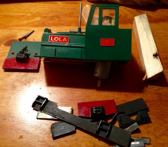

Post by markoteal » Mon Feb 06, 2017 1:47 pm

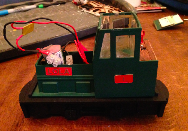

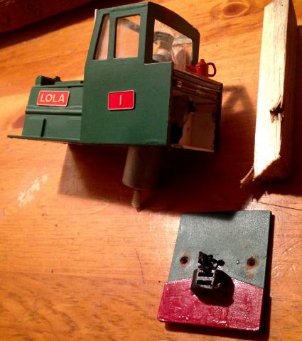

So the next step was taking all the items below the footplate off - a big gulp and off we went
Having done this I also realised the back would need to come off to be shortened
I had hoped to avoid having to go further is dis-assembly but realised that the motor location on the new chassis was going to require a different entry point on the body - so a pencil was used to sketch out the larger hole that was going to be required
The body was then moved to the cutting area of the workshop (kitchen table) where the dremel was careful applied and after some deep breathing a new hole in the base of the body was achieved
So Lola was now ready for the chassis - where was it? (cue East Enders end of episode music)

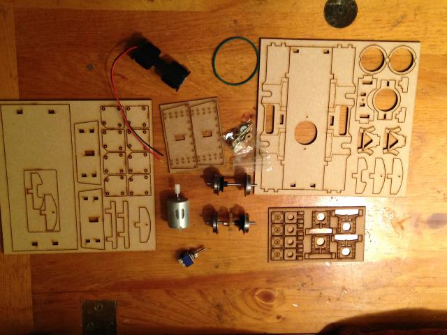

Ok - here we have the chassis build - I've built a HGLW standard chassis before but knew it wouldn't be long enough for this project so after checking some dimensions with David, opted for the new Gordon chassis

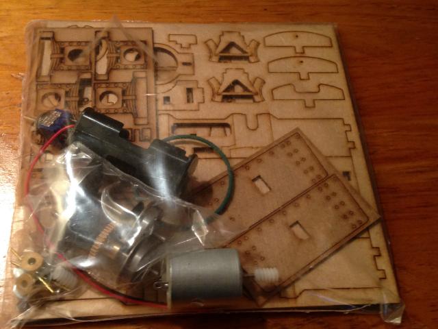

All very exciting when the box appeared through the post
And when you open it up, all the materials are well laid out both in the bag
and out of it bag, its all looking good

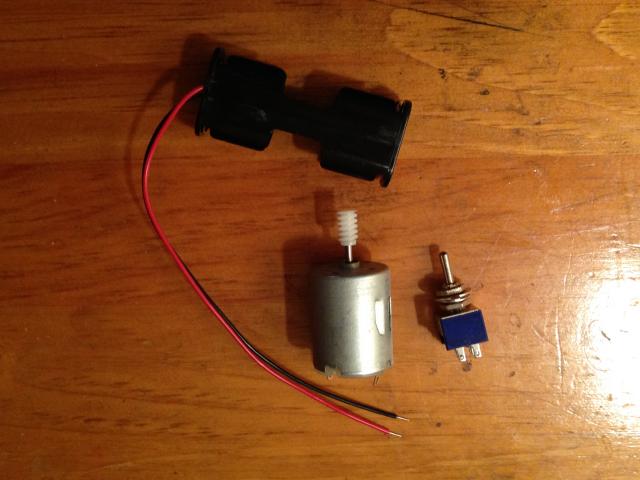

So I sorted through everything and Id'd the bits I wouldn't need because of what's already in the body, so the motor, switch and battery box were sent off to the spares box
Now when it comes to building the chassis, I'm not going to clog up the forum with build by build photos - its all documented and pictured in the great manual you can download when you get the kit and can be found other website

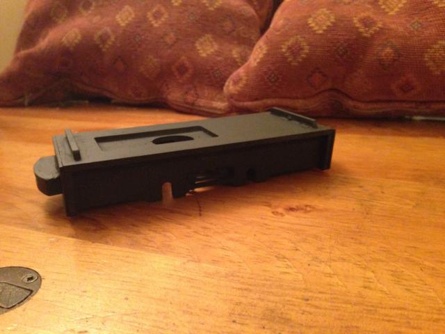

So after a couple of nights of steady building, you end up with:-
In my next post we'll start to bring all the parts together!

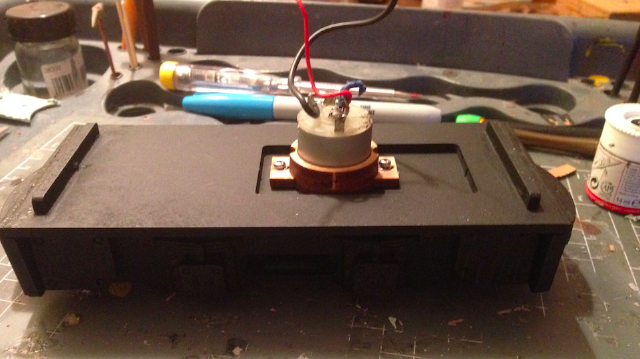

Post by markoteal » Sat Feb 18, 2017 8:51 pm

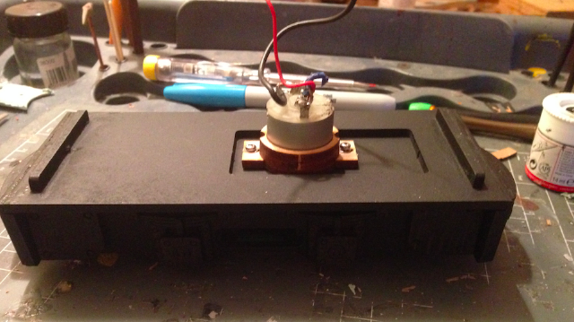

Ok - here's the next instalment - bring together - first fit the running gear as per the instructions
Then fit the motor - all looking good so far
[/img][/code]
Now the challenge of getting all the working back inside the body with the motor now sitting in a different position

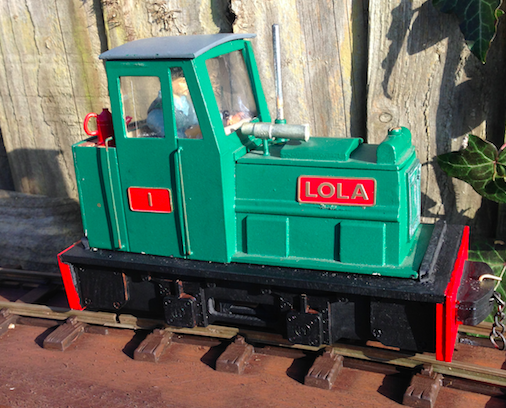

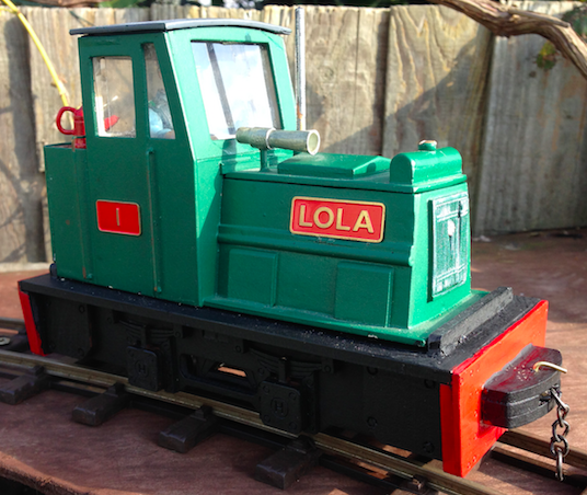

So after much fiddling ( and I mean much), we manage to get it all back in and tested and today Lola made her first in on the line - here she is for her official photographs back on the line.
She needs more clutter around the footplate and lamps front & back but I'm pleased with the new chassis - but of course the acid test is 'how does she pull?" - a video is in production to demonstrate - to follow soon

Post by markoteal » Sat Mar 18, 2017 10:14 am
Yes, she's settled back into the rosters on the line well - she can now hold her own against the other locos in terms of power and scale speed and will become the timber trains ideal loco.
I took this photo last weekend when she was running timber down to the new station at the new terminus station - pleased I got her to sit in front of the 1:1 background
