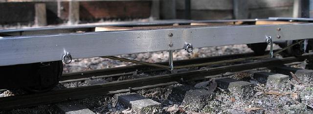

In need of at least one more bogie open, and another van (probably a cattle truck) I thought I would start putting together two new underframes. Workshops had taken delivery of 4 completed Fox Trucks.
So today two new underframes (one with lashing rings, one without) were given a test run through points etc. and deemed satifactory.
Next stop paint shop, well after I add hand-brake wheels and gear, which I've just noticed are missing.

Nice! Is that aluminium angle?

ge_rik:117603 wrote:Nice! Is that aluminium angle?
Sorry - just re-read your other thread. I see it is alu - do you spot-weld them somehow?
Posts: 1887
Post by LNR » Tue Apr 19, 2016 9:45 am
Hi Rik,
The first one I bolted together, the second lot thought I'd use 1/8th iron rivets. These two are riveted with copper rivets, you can see them in the last pic. in the lower left hand corner. The aluminium just keeps getting thinner and thinner, (used to be 1.6, now 1.4mm) and it's getting harder to rivet flush into such a shallow countersink.

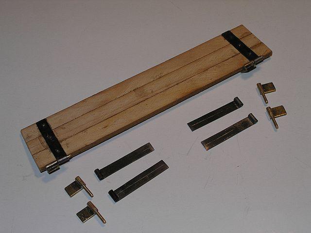

Today was spent in the blacksmith shop making the metal work for the opening side doors.
Two doors fitted with hinges, two to go.

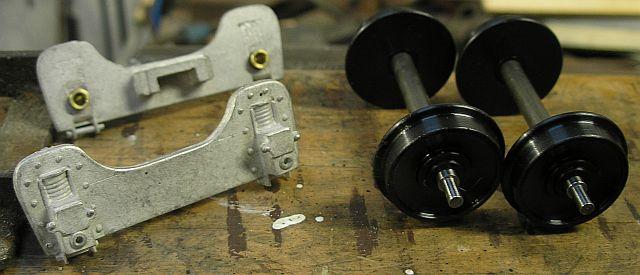

Are those trucks plastic or metal?
Posts: 1887
Post by LNR » Fri Apr 22, 2016 11:53 pm
KN03
The Fox trucks are white metal, with brass bearings, and a steel bolster. Sierra Valley wheels.

Post by KNO3 » Fri Apr 22, 2016 11:59 pm
Thanks! The fox trucks are from sierra Valley as well? Can't find them on their site.
Posts: 1887
Post by LNR » Sat Apr 23, 2016 12:09 am
Sorry, no the fox truck castings are from Argyle Loco Works here in Victoria, as well as the wheel sets. I don't think they are available as castings any more, only as complete trucks.

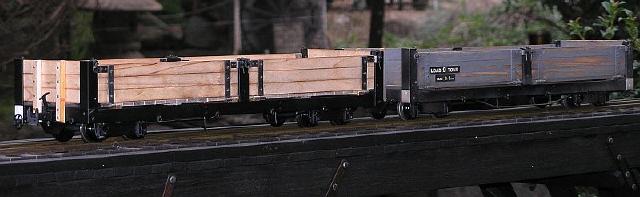

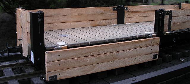

Finally got all the steel work for the NQ wagon done and riveted in place today. This includes time spent on hands and knees looking for so many pieces I have dropped on the floor.
Pictured here with the older one.
The sides open and are removable, as are the centre posts and end bulkheads, just leaving the four cornerposts to carry anything long.
Next stop paint, Grant.

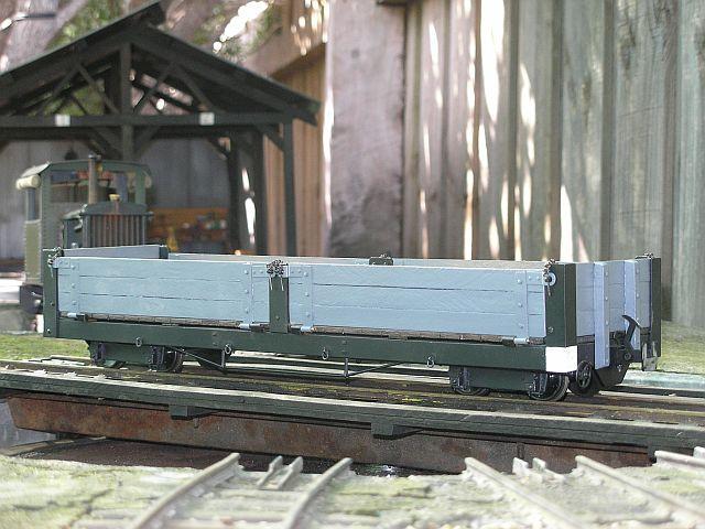

Finally got some paint on the wagon, working on a format for a data panel for all my stock. Here it is on the turntable at Leawarra.
