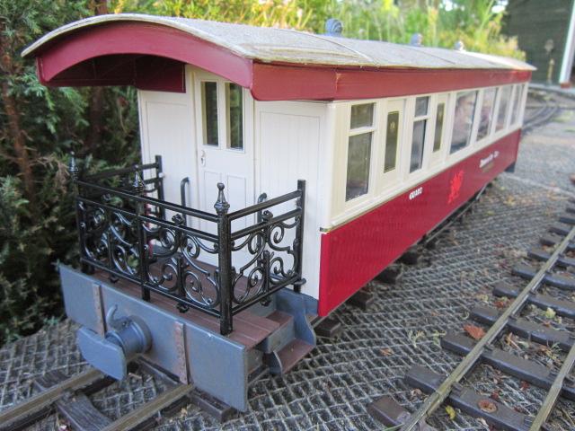

Post by Peter Butler » Fri Nov 20, 2015 11:47 pm
Brilliant conversion... well worth all the effort.
For balcony railings I used plastic moulded fencing panels from dolls house suppliers. They give added character to the coaches and are kind of British, rather than European in style, I think.

Post by dougrail » Sat Nov 21, 2015 9:32 pm
Brilliant stuff, may resort to it if GRS cannot sort out their spares depot.
Do you have more on this coach, Peter?

Posts: 5720
Post by Peter Butler » Sat Nov 21, 2015 10:00 pm
My coaches started life as Bachmann clerestory stock which I 'Anglicised' and made into three variations....
