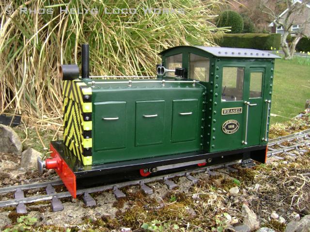

My big diesel loco accelerates away and coasts to a stand, but it is all done electronically rather than with anything mechanical. It is powered by a sealed lead-acid 12V battery driving a Como Drills motor with a worm drive to the rear axle. The wheels and axles came from Roundhouse Engineering.
The two black buttons either side of the dummy horn provide On/Off and Forward/Reverse control, and speed is governed by turning the exhaust pipe. Control is provided by an I T Electronics (Ian Titford) speed controller which gives acceleration and deceleration effects. The latter often catches out unfamiliar operators as pressing the Off button while the loco is in motion causes it to run several feet before gently coasting to a stand. The speed can be controlled right down to an almost imperceptible crawl.
Tony Willmore
