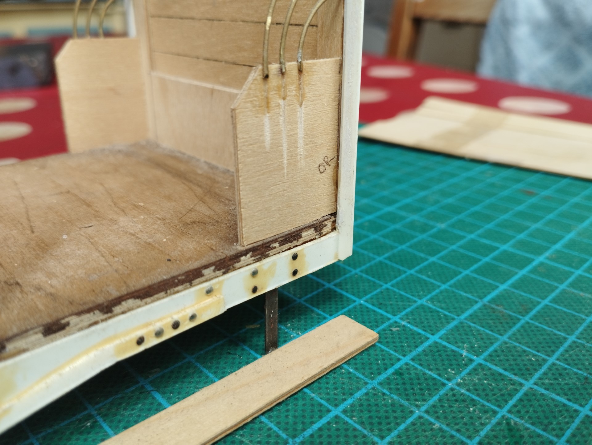

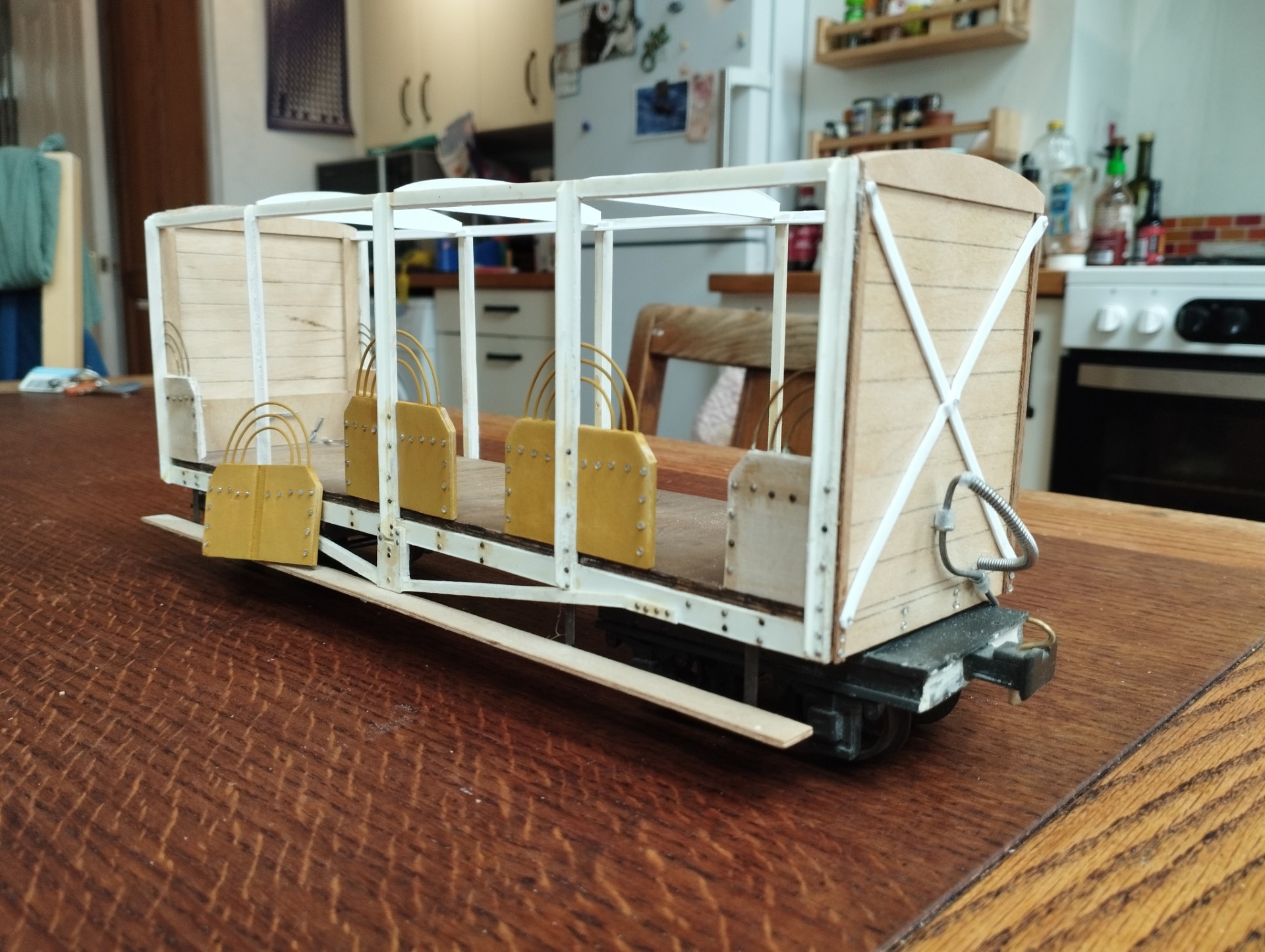

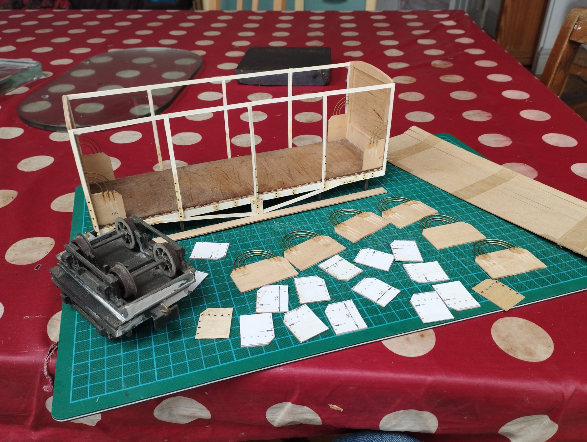

Toastrack bits 1.jpg (587.38 KiB) Viewed 49869 times
Toastrack bits 2.jpg (850.68 KiB) Viewed 49869 times
Toastrack bits 3.jpg (442.51 KiB) Viewed 49869 times
That's got to be at least half finished?
There are various bits that don't come up to my current standards, and some bits that have suffered in storage, but I think I should be able to pick it up quite successfully. The first task will be to attach the bogies and give it a test run, then I think I'll work on those side panels.

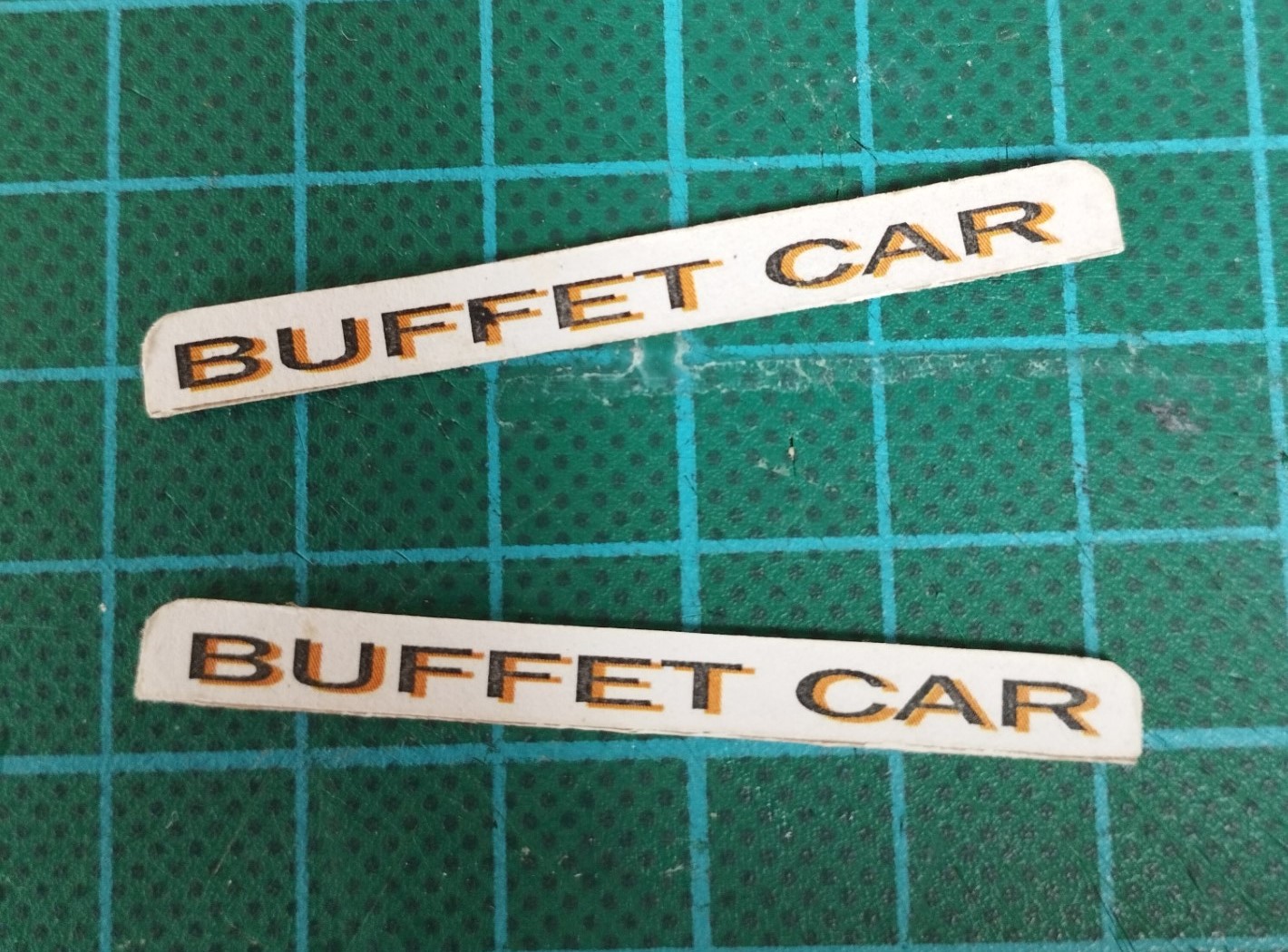

As a bonus, in amongst all the bits of toastrack I found the little Buffet Car signs I made at about that time but never got round to fitting, so finally my model of that carriage can stop being anonymous. You never know, it might attract a few more customers...
Toastrack bits 5.jpg (403.94 KiB) Viewed 49869 times

Looks pretty good to me, Andrew. I do like those curved handrails, very neat and even.
Re: (WH)WHR Rolling Stock
Post by Andrew » Fri Jul 07, 2023 12:13 pm
philipy wrote: Fri Jul 07, 2023 11:25 am Looks pretty good to me, Andrew. I do like those curved handrails, very neat and even.
Thanks!
As I recall, I bent them round various carefully-chosen paint pots etc! The panels you can see with the paper drawings still stuck to them will go on the front, to hide where they're attached.
They'll go behind the uprights, whereas really they're quadrants (rather than semicircles) that should meet in front of them, but I generally think that a neat finish is more realistic than a botched attempt at accuracy. I noticed that one set of handrails (one of the end ones) are distinctly wonky and don't match the others, so I'll need to re-do those - IF I can find the right size pots etc again!
