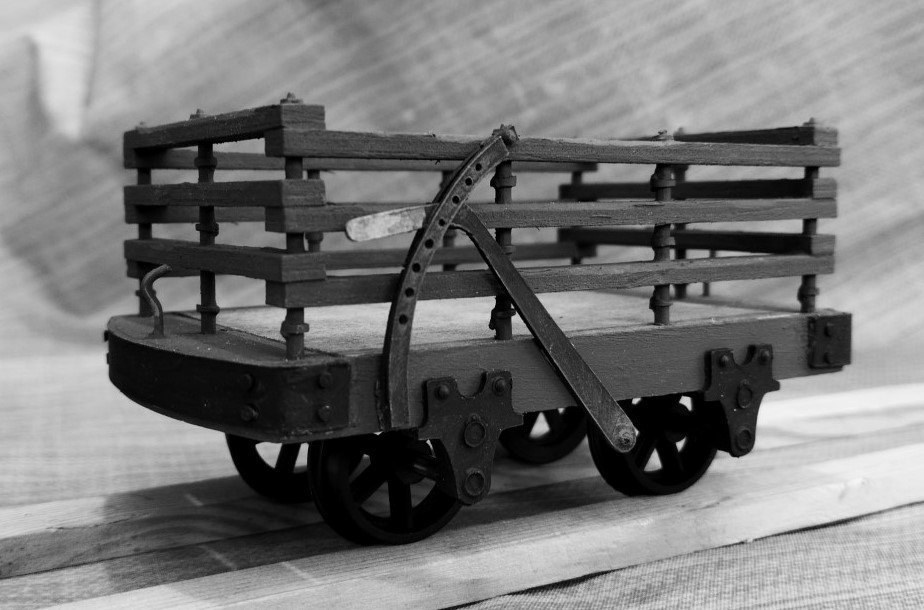

Famous last words, of course, but I thought I'd try to squeeze in just a quick little project before Christmas.

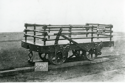

Inspired by JMORG of this forum, indeed by his words on this very thread, I'm having a go at using a couple of Lineside Hut slate wagon kits to recreate a pair of the NWNGR's wooden slate wagons, as seen in this builders photo (courtesy of Gloucestershire Record Office, D4791/16/1):
Gloucester slate wagon A.png (160.07 KiB) Viewed 16536 times
At first glance, it's pretty similar to the Ffestiniog's wooden slate wagons, so my first attempt at a model used the classic Binnie kit. The problem is it's clearly too narrow, so Take Two involves Lineside Hut's wider wagons intended to run on 45mm track, as suggested by JMORG. LH kindly made me a special version of the kit, with an extra chassis piece, so I can use larger wheels of the correct pattern.
So far, I've made up the kits, with various minor modifications along the way, including biro inner tube slices on the uprights to represent the "bobbins", extra planks along the sides, and Binnie axleboxes. I've pinched the distinctive brake handle from the original Binnie version, which will revert almost to its original FR guise as art of the project.
Before I undertake lettering and weathering, I thought I'd temporarily put it together and try a quick recreation of the works photo - and here it is:
Gloucester slate wagon B (2).jpg (133.21 KiB) Viewed 16536 times
You can clearly tell that it's an approximation rather than an accurate model but it (and its unbraked twin) are turning into quite attractive models, I think...
Cheers all,

Looks very good Andrew. As you say "approximation", but the curved brake plate should have 2 rows of holes and a man of your perspicasity could surely knock one up from styrene?
Re: (WH)WHR Rolling Stock
Posted: Thu Dec 08, 2022 10:01 pm
by Andrew
philipy wrote: Thu Dec 08, 2022 8:49 pm Looks very good Andrew. As you say "approximation", but the curved brake plate should have 2 rows of holes and a man of your perspicasity could surely knock one up from styrene?
Ah, naturally I would have loved to make myself go cross-eyed doing that, but that's an optical illusion - the second row's on the rearmost plate. Phew!
Posted: Fri Dec 09, 2022 9:09 am
Very nice work Andrew, a fine representation.
Question..... on the 12" scale wagon, with 'bobbins' on the posts, how would the laths be slotted on and what then keeps them in place?
Posted: Fri Dec 09, 2022 9:29 am
by Andrew
Peter Butler wrote: Fri Dec 09, 2022 9:09 am Question..... on the 12" scale wagon, with 'bobbins' on the posts, how would the laths be slotted on and what then keeps them in place?
I don't actually know, but there are nuts on the top lath, so I think there's probably a threaded rod that runs all the way through, with the bobbins acting as spacers?
