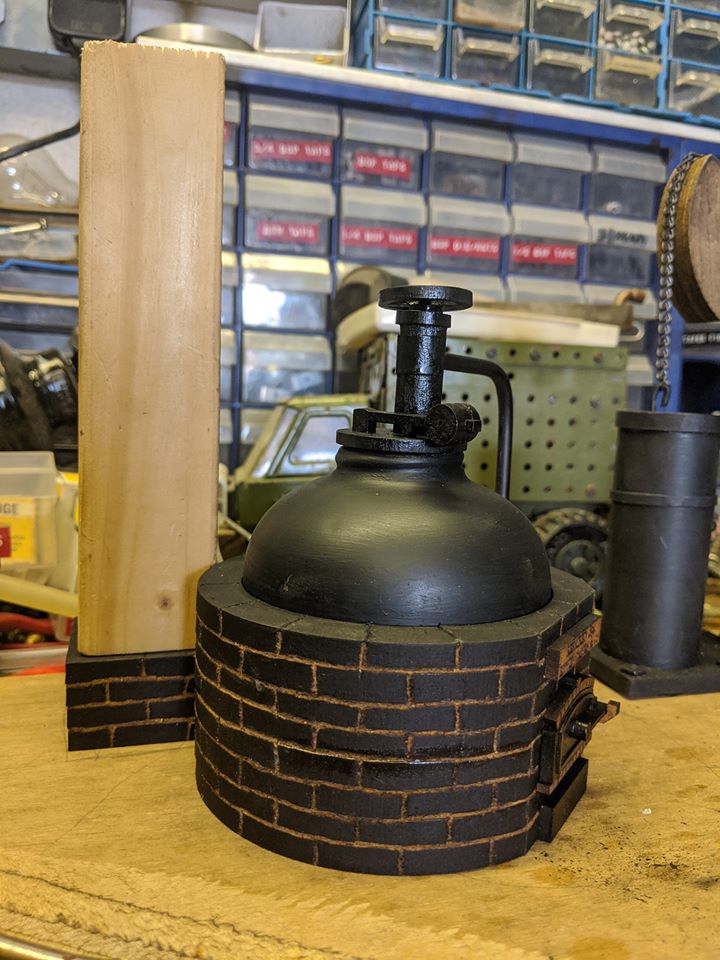

Instead of cladding the boiler with wood, which will be difficult, given the domed roof, what about cladding it with brickwork instead, constructing a brick dome over the boiler? That laser cutter really is a marvellous tool - I particularly like the moulding you've produced for the water tanks. :D

Lonsdaler wrote: Thu Jul 02, 2020 11:01 pm Instead of cladding the boiler with wood, which will be difficult, given the domed roof, what about cladding it with brickwork instead, constructing a brick dome over the boiler? That laser cutter really is a marvellous tool - I particularly like the moulding you've produced for the water tanks. :D

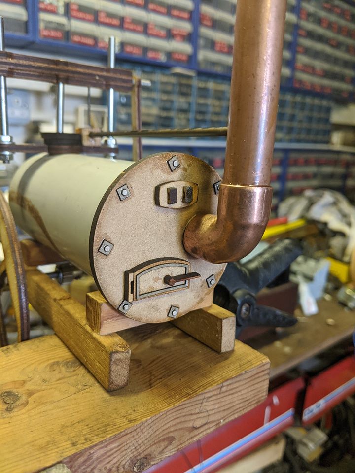

The boiler is where I've departed from the prototype in the picture, and gone for an uncovered domed boiler. The top is uncovered as per similar Georgian steam engines (take a look at the replica Newcomen engine at the Black Country Museum).

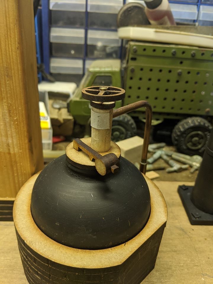

I had a bit of good fortune today - I started engraving the laser cut MDF boiler housing and realised that the burnt edges provided a lovely representation of blue bricks, when contrasted with the engraved away MDF showing through as light brown mortar. The top surfaces (which are un-burnt MDF) have been painted matt black and rubbed back before drying to try and give a similar effect. A bit of a conundrum now is how to achieve this finish on the chimney - the rubbed back matt black looks okay in small areas next to the nice burnt colour but I'm not sure it'll look the part all the way up the chimney. I guess I could just mix up a very dark brown and try to replicate the finish...?
The pattern I have engraved is over scale for bricks, as I was originally going to paint it as stone, but I like the look. In Bristol, there is the 'Black Castle', folly built in the 18th Century using blocks made from slag from the smelting of brass and copper so perhaps I'll say it's built from that!
I think the detail on the boiler top and the firehole door area here really shows how handy the laser cutter is - all built up out of 2d shapes...
A few other little details added such as pipes to the cooling water tank, and some weathering here and there.

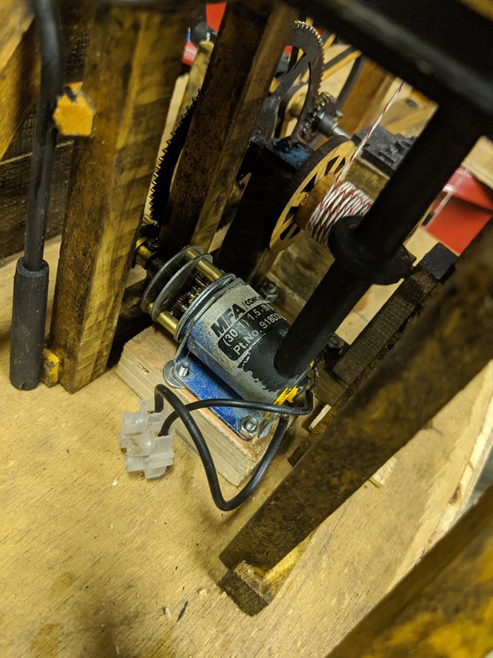

The motor is a 1.5-3v one, running via a 12v Hornby controller. The finesse of control just isn't there are I'm running so near the bottom of the power range. I think I shall have to hunt around for either a 6/12v version of the motor, or one with greater gear reduction - anyone have one knocking about that may replace this one? This is 30:1.

Thank you Peter! I like working with real wood, it saves a lot of hassle painting - I don't like hanging around waiting for paint and glue to dry, I soon get fed up and bored of the project then! To that end, I've always got plenty of quick drying matt black paint, quick drying oak stain, superglue, and shellac about - you can get by with most things with that!
I've had a look on MFA's website and they produce motors of the same footprint and mounting arrangement as this, but with different gear ratios and suitable for different voltages, so (although there are other benefits that you mention) I'm loathed to go away from this type - as you can see, it's all pretty tight in there, and a drop in replacement would be ideal! Re. noise and so forth, it probably won't actually get used all that often, more of a "yes, the coal mine does work" when visitors are around!

steamyjim wrote: Thu Jul 02, 2020 11:40 pm
I looked back at your earlier post and realise I've misunderstood about the cladding. The brick effect is very effective, and prototypical too. Been a long time since I've been to the Black Country Museum. I started my working life just up the road in 'Dudlay' - had to learn the local patois very quickly :lol: Now living in North Yorshire, it seems I haven't completely lost the accent, so my friends tell me anyway! :roll:

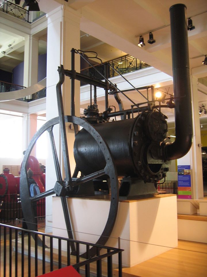

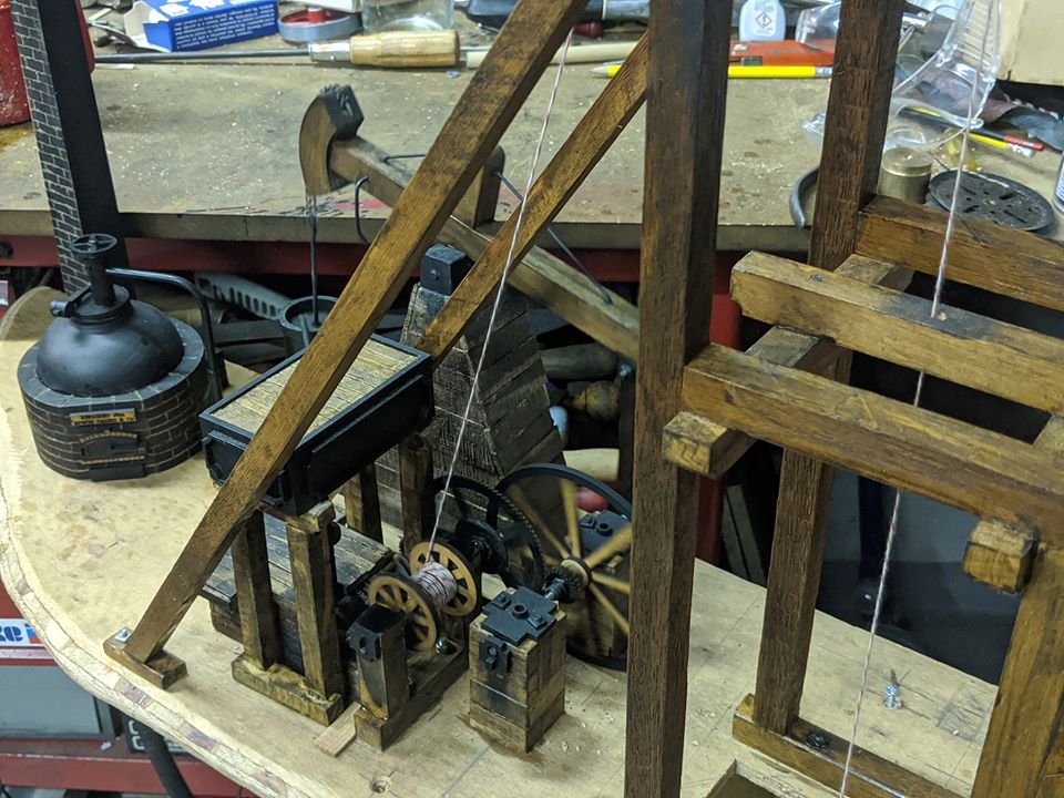

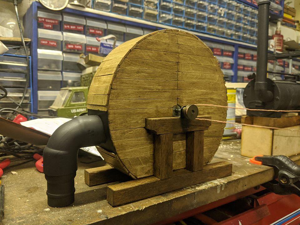

Next! The coal mine needs a ventilation system, so I've gone for a great big fan, and as it's a Georgian mine, it's going to be powered by a Trevithick dredger engine as in the Science Museum. Motor to be hidden either under the engine or in the fan - the design is still rather fluid at the moment!
The next logical step is to put a similar model on wheels and have a 16mm scale model of Catch Me Who Can?... (or indeed any sort of Georgian locomotive).
Currently the bearing surfaces are wood on steel (except the crankshaft) - not sure how well this is going to last, perhaps okay considering it won't get used very often. Certainly, if I was building a locomotive like this I'd enlarge the conrods a tad and add brass bushings.
The prototype...
It all goes around too!

Lonsdaler wrote: Sat Jul 04, 2020 11:36 am
I'm rather pleased with how the brickwork came out - I'd been fretting about it beforehand! The Black Country Museum is always worth a visit, although I believe their Newcomen engine is currently out of commission requiring work.

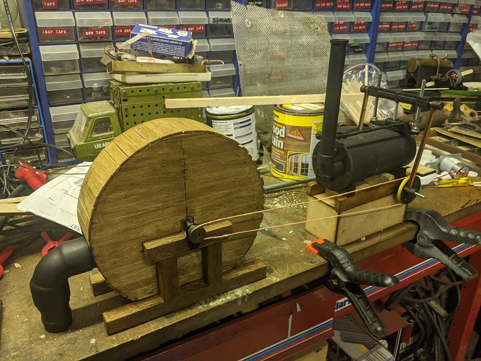

A bit more painting needed, quarter the crankshaft correctly and to sort out the drive system, but that's the Trevithick engine done for the coal mine. I've backed myself into a bit of a corner with motor/gearbox/drive options...
I think I'm going to use one of these: https://www.ebay.co.uk/itm/Miniature-12 ... Swvg9Xe8ac
But I can only fit gears of 1/2" dia or smaller in the space available, so still trying to track something suitable down. Rik, if you're reading this, where did you source the bevel gears for your railcar build please?
The easier solution would be to hide the motor in the fan and have that drive the engine, but think I'm going to build a version on wheels too so it's worth proving motor mounting out out with this. Should be able to knock most of it out pretty quickly now it's all designed!

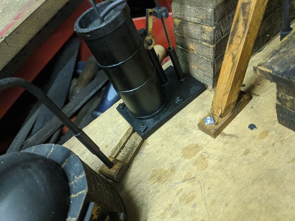

Didn't achieve a lot today - got this quartered up properly (the crank disk was slightly loose on the bush which was causing it to keep slipping) and with a drop of oil turns over lovely and smoothly.
And had a bit of a measure up of the available space to make a few modifications to the machine shop ready for laser cutting tomorrow...

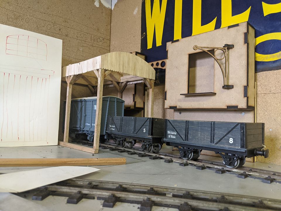

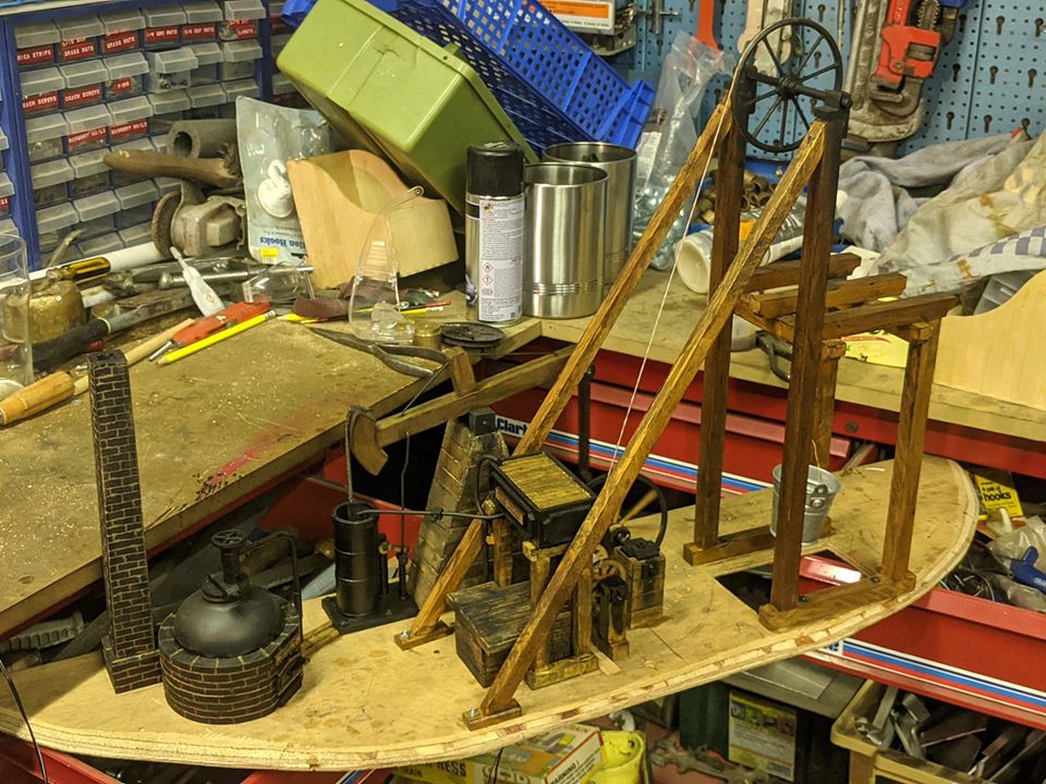

A bit of progress today. Had to tweak the permanent way a tad to get things to line up! I think the building that is still mocked up in card will be shortened an inch and narrowed by half inch to give a touch more clearance. I'm going to embed this section in cement like the engine shed so I want to be sure of clearances!
The tops of the buildings will stay removable with the roofs to allow lighting to be fitted. Talking of lighting, I'm planning to have the option to switch over to steam generated electricity to run the lights around the railway, but I need to clear the railway a bit further to get to that section of the line!
I wonder how you'd go about 'covering' the buildings. I'm probably going to do the lower section in blockwork like the engine shed, but I'm undecided on the upper section between wood panelling or blockwork.
Before I go making a set, does anyone have a set of level crossing gates they'd like to sell?

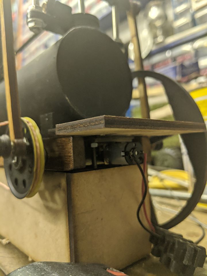

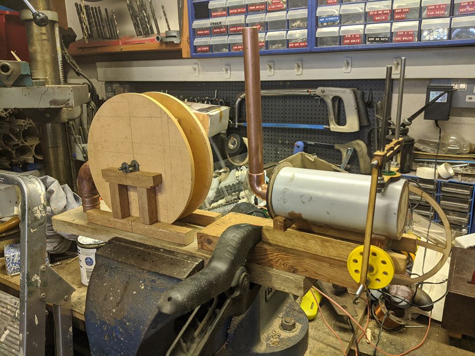

A productive day - major work on the mine ventilation engine and fan done. Detailing to be added tomorrow.
I may yet replace the motor with a lower geared one so I can run the motor at a higher speed. The counterbalance on the flywheel is 180 degrees out - perhaps positioning this correctly and adding some weight to it will help too.
