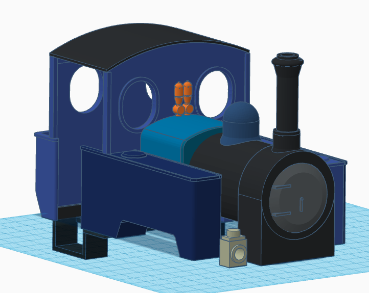

Doing a test fit of all the parts in TinkerCad. A lot has changed with this model since I started it in February! :happy3:
Screenshot 2023-10-17 at 09-39-22 3D design Thornas Tinkercad.png (132.92 KiB) Viewed 14125 times
Also making some much-needed improvements to the chassis to address some issues that have come up with splitting along layer lines. This was originally just meant to be a push-along toy, so the motor mount is also a bit of a bodge.

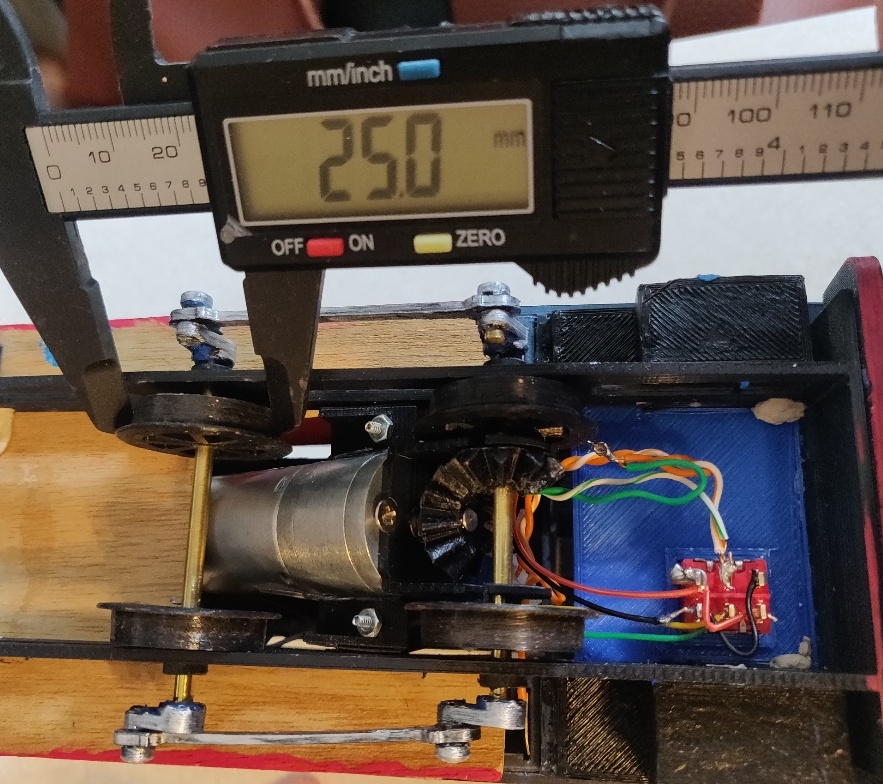

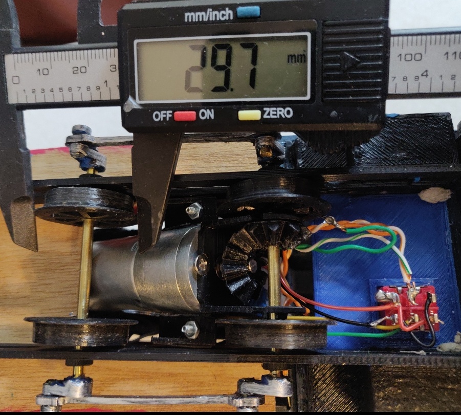

Post by drewzero1 » Wed Oct 18, 2023 6:21 pm
philipy wrote: Wed Oct 18, 2023 4:54 pm OK, don't worry to much, I just need the wheel diameter.
I can never remember whether wheels are measured on the flange or the tread. 29.7mm on the flange and 25mm where the tread meets the flange, though depending on how you cut the running board they could be a bit bigger.
These images also give a bit of context for the way the motor, gears, and rods all fit together.
29.7mm on flange
29.7mm on flange
25mm on tread
25mm on tread

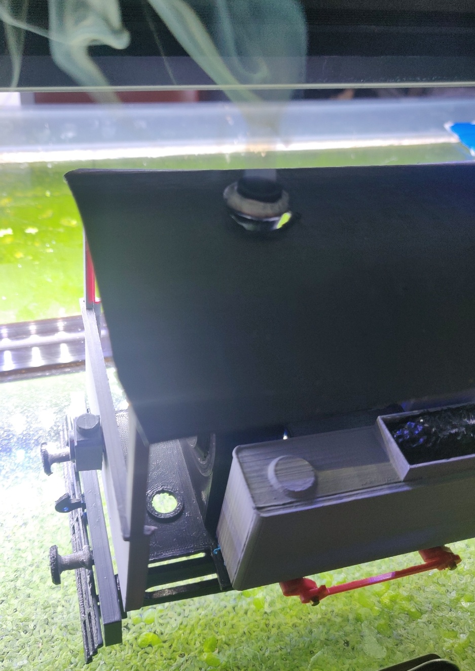

Post by drewzero1 » Wed Oct 25, 2023 8:35 am
From the smoky mists of the Duckweed Works emerges a new project:
Details are similarly hazy but it appears the Thornas chassis I was building as a test has been completed in a manner somewhat contrary to the instructions. I suppose it was about time for the Nolwyn Valley Tramway to get its first tram!
Still needs power, one side's crank pins, front cab steps, and a final livery, but for now it's serving its purpose well as a test and demonstrator for the construction of a Thorn-class loco. The Small Controller has nicknamed it 'Toby' for now but upon completion a suitable name will be chosen.

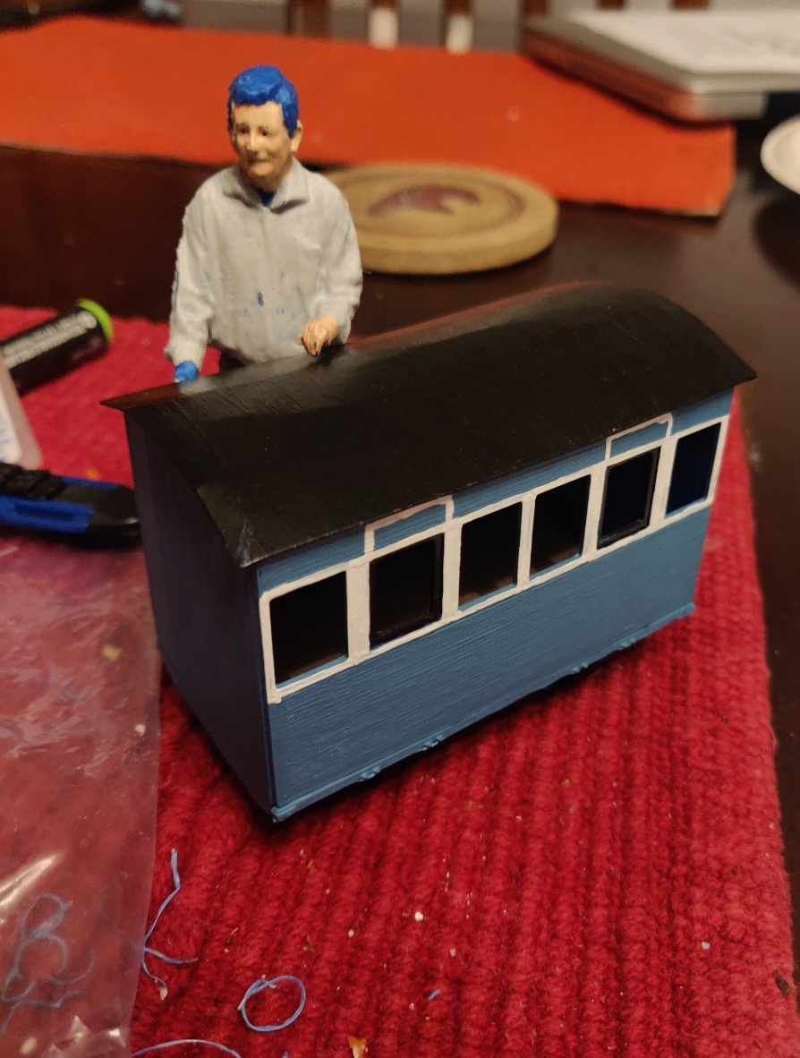

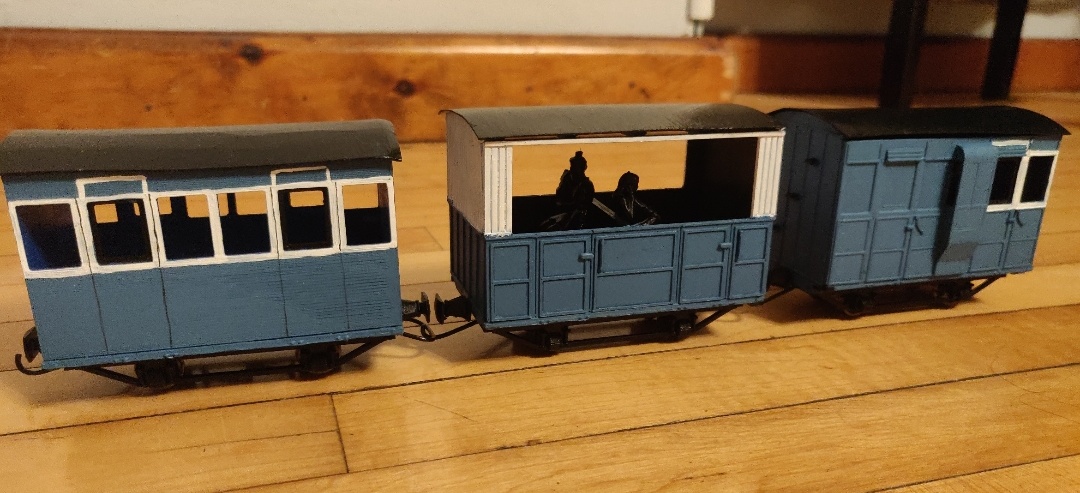

Yes, this has been a very valuable resource for populating the Nolwyn Valley. I've also used a few on the yet-unrevealed "mini Nolwyn" in O-16.5, since the GVT open coach looked a bit lost without any passengers. I've been using the smaller scale for testing models and paint schemes that I'm not ready to commit to yet in 15/16mm :roll:
Thornas' driver posing with the smaller-scale coach. This one suffered a failure mid-print but I finished it anyway.
