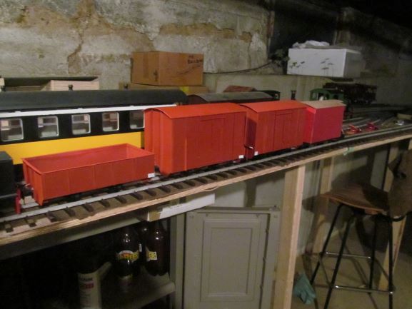

The wagons have received a few improvements. Dummy handbrake gear has been fitted, and the location marked for the benefit of shunters and brakemen by the strategic use of white paint.
The wagons
The wagons
Wagons
Wagons

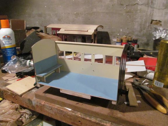

For once I am actually getting on with the interior... The 'lino' and the seat covers are shelf paper scrounged off the Missus.
Interior 1
Interior 1
Interior 2
Interior 2
So how do the passengers fit? The figure is a bit small being LGB, but there is enough room there that a proper 5/8th scale person would fit.
Interior 3
Interior 3
Having established that it is time to glue t'other side on. The three clips are holding the top rail in position whilst it dries. The rubber bands are holding the side on whilst it dries. This side will have short handrails thanks to the floating pool of bits theory of narrow gauge railway maintenance - or the lack of it!

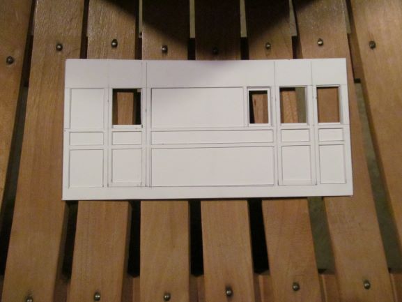

This one is another mésalliance between a KSR prototype and one from the DHR. As usual the body is Bristol board, and as the interior is relatively hidden I decided just three layers - panelling, and then two laminations for the body itself.
Here we have the three layer. Drop light layer (top); outer layer (bottom right) and panelling (bottom left). Ready for painting between services on Sunday, and lamination on Monday.
The three layers
The three layers
When finished the side should look like this, but in brown and cream, with a red panel for the TPO end's post box.

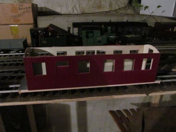

I am a long way on with the van with the partition between the mail and guard's compartments in position, and the roof rolled. Lots of little finishing jobs at this stage - handrails, roof stretchers, maybe a basic interior, and of course, the essential letter flap.
3Q view
3Q view
19Mar trains2.JPG (41.12 KiB) Viewed 19241 times
Here is a three-quarter view showing the guard's end windows. The Kalka-Simla influence is winning at the moment, so it will also need some brake pipes when I can cobble some up.

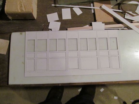

Stage 1 is to draw out the needed parts on 100lb Bristol board. Three laminations here - panelling, body, and then droplights. Then the cutting out begins.
Panelled side
Panelled side
19Mar trains3.JPG (31.69 KiB) Viewed 19241 times
In this case the panels and the main body have been laminated early on, as following KSR practice the body is going to be cream without the panelling being picked out in brown, though the window shades will be brown. I cut the windows and panelling before dividing the sheet into the three layers as that seems to make it easier for me to line things up.
