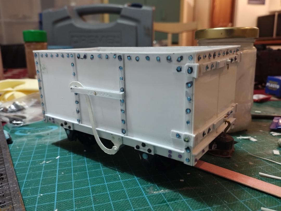

Morning all!
Here's the coal wagon again, braked, bejeweled, and awaiting a coat of paint. This evening maybe? That will be evening four of my one evening project, but still not bad going, I think...
Have a good day everyone!

Lovely job Andrew, looking really chunky now, the primer coat will make such a difference.

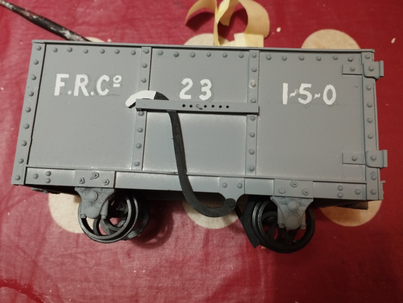

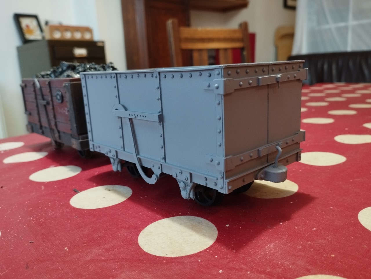

It did!
I'm not convinced my attempt at lettering has improved anything, but a heavy weathering should hide most of the imperfections, and the bits where the spray didn't reach too! The wagon should also carry instructions re the load, but I can't do lettering that small, so it'll have to do without.
I'll crack on with the weathering at the weekend - it's too dark after work to avoid working under artificial light, and I try not to do that when weathering because I can't really tell what it looks like...

Is the lettering hand painted? Excellent job!
Re: (WH)WHR Rolling Stock
Yes, it is hand-painted - thank you!
I used a strip of masking tape top and bottom, and to mark out the overall size of each block of lettering. I measured the original lettering from a side-on view of the real thing, then calculated the equivalent sizes on my wagon, although pretty roughly. I drew up the lettering with a pencil, then I got stuck in with the (off) white paint, before tidying up with some grey.
Looking at it now, without a picture of the real thing to compare with, I am quite pleased with it. This side works better than the other - the quality of the lettering is about the same, but on the other side there's no brake lever etc to distract the eye from the dodgy bits!

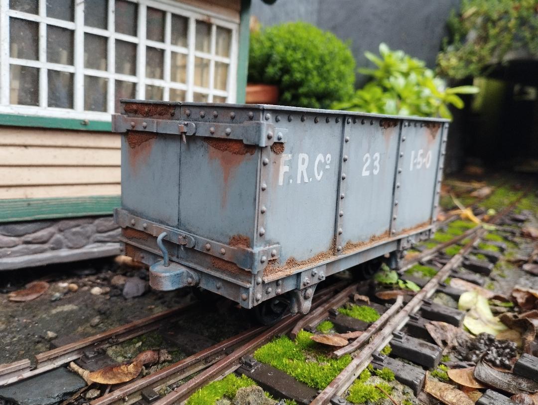

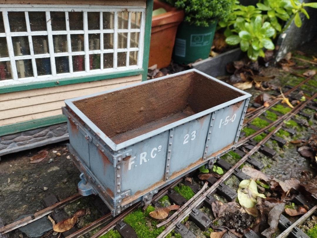

Work from home on Thursday gave me extra daylight time at home, so I finished the weathering on the Ffestiniog Coal wagon - and here it is:
It's not a perfect recreation of the real thing, but I'm pretty happy with it. I was hoping to give it a test run today, but the rain's put me off that idea. Unfortunately, it's less free-running than it was before I painted it. I sprayed it with the axles in place, having pushed the wheels to the middle of the axle to mask them. When I pushed them back they seem to have forced a "sleeve" of paint along the axle ahead of them and into the axleboxes. I'm hoping it'll sort itself out with a little running, because removing the axleboxes now will probably damage them/the body/the paint job. We shall see...

That rusting is absolutely fantastic!
When I first opened that picture I genuinely thought you had posted a picture of the prototype and expected to see your model below it.
