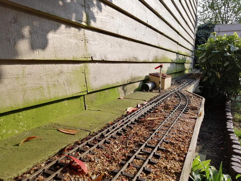

My outdoor servos (total 6) are all inside small styrene (plasticard) 'huts'. Three are larger servos operating turnouts, and three are the mini blue ones as in the pic you posted on 3/4 ,operating semaphore signals.
mela 3rd signal.jpg (127.26 KiB) Viewed 14071 times
I have had 2 failures of these mini ones stripping gears and locking up. Not sure why.
