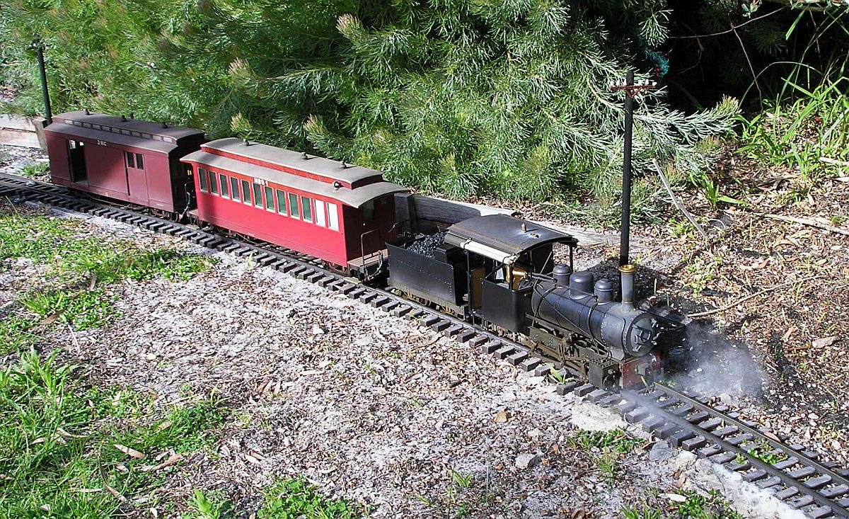

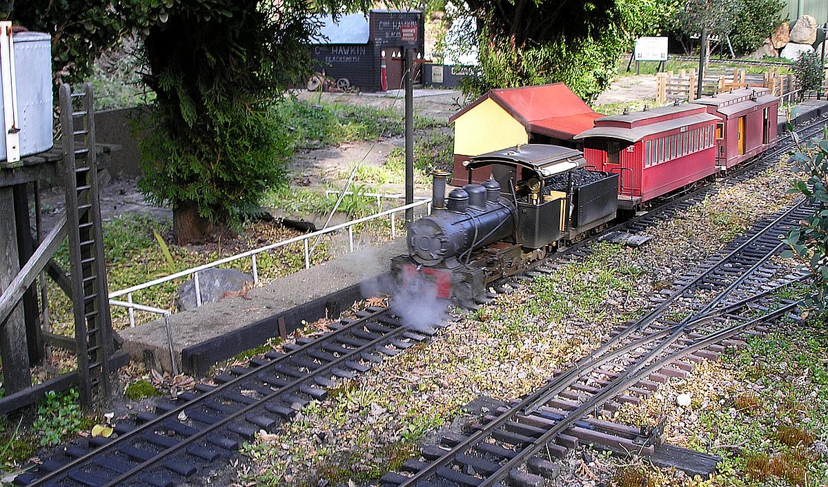

With a watery sun and cool temperatures, I decided to give the new Fowler it's first revenue test. All the usual procedures (faffing about for the battery boys :lol: ) completed, signals off, drains open :lol: off we go. Very pleased with the effects, even to the point of being able to pull the drain lever half way out and get steam up the stack and from the simulated drains.
Pulling out of Warringine.

And running through Nayook.
1st Revenue test 4.JPG (369.12 KiB) Viewed 28819 times
Definitely worth the extra work put into this loco.
Posted: Sun Aug 04, 2024 10:10 am
The loco looks amazing Grant, well worth all the extra work you put in.
It looks perfectly at home in the wonderful landscape you have created there too.
With the little wisps of steam it gives such atmosphere.

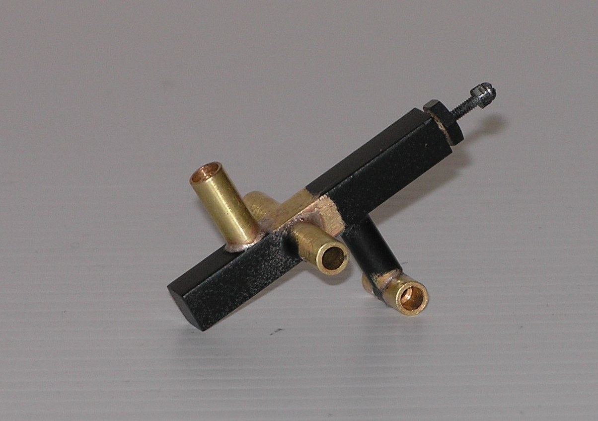

The exhaust steam around the cylinders is a great touch. Has that been deliberately engineered as I can't imagine it would be the product of leaky pistons on one of your locos? I don't remember seeing similar on other live steamers.
Posted: Sun Aug 04, 2024 2:00 pm
by LNR
Rik,
If you remember this device I posted a pic of previously,
Simulated Draincock Device 1.JPG (115.58 KiB) Viewed 28772 times
the piston inside diverts exhaust steam through a pipe (the "T" pointing down) which branches and comes out under each cylinder.
Posted: Sun Aug 04, 2024 6:02 pm
LNR wrote: Sun Aug 04, 2024 2:00 pm Rik,
Duh.. Yes. It all makes sense now.
Posted: Sun Aug 04, 2024 8:29 pm
by Andrew
Great pictures - I particularly like the one of the train rounding the curve...
Posted: Mon Aug 05, 2024 7:45 am
by FWLR
I love them all, in particular the first one. Brilliantly taken Grant.
Posted: Mon Aug 05, 2024 9:27 am
by drewzero1
The effect is just as effective as I imagined it might be! What a clever device. :thumbup:

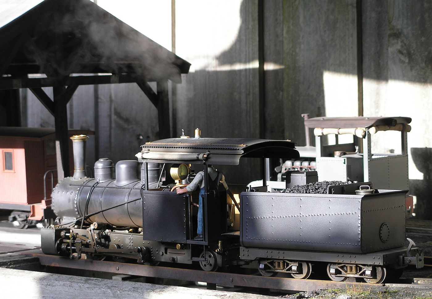

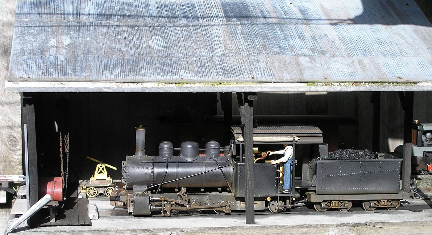

Posted: Tue Sep 03, 2024 9:40 am
by LNR
Well after three days of gales, the wind died and the sun came out. Time to boil some water and get more familiar with the new Fowler. With a slightly bigger gas tank a gauge glass, and being able to top up boiler water under steam, I could raise steam, and take my time to make up a train while the loco sat in the yard with the safety eased. Did the run to Nayook, topping up with water and running round, then back to Leawarra. Too much fun to take photos till the end.
About to head into the shed for the night.
After the Days Work 2.JPG (220.64 KiB) Viewed 27500 times
As the sun sinks in the West, shutting down on Shed.
After the Days Work 1.JPG (258.43 KiB) Viewed 27500 times
I did notice the loco was a bit slippery pulling out of Warringine with six bogies on the 1:40 shall have to investigate further.
