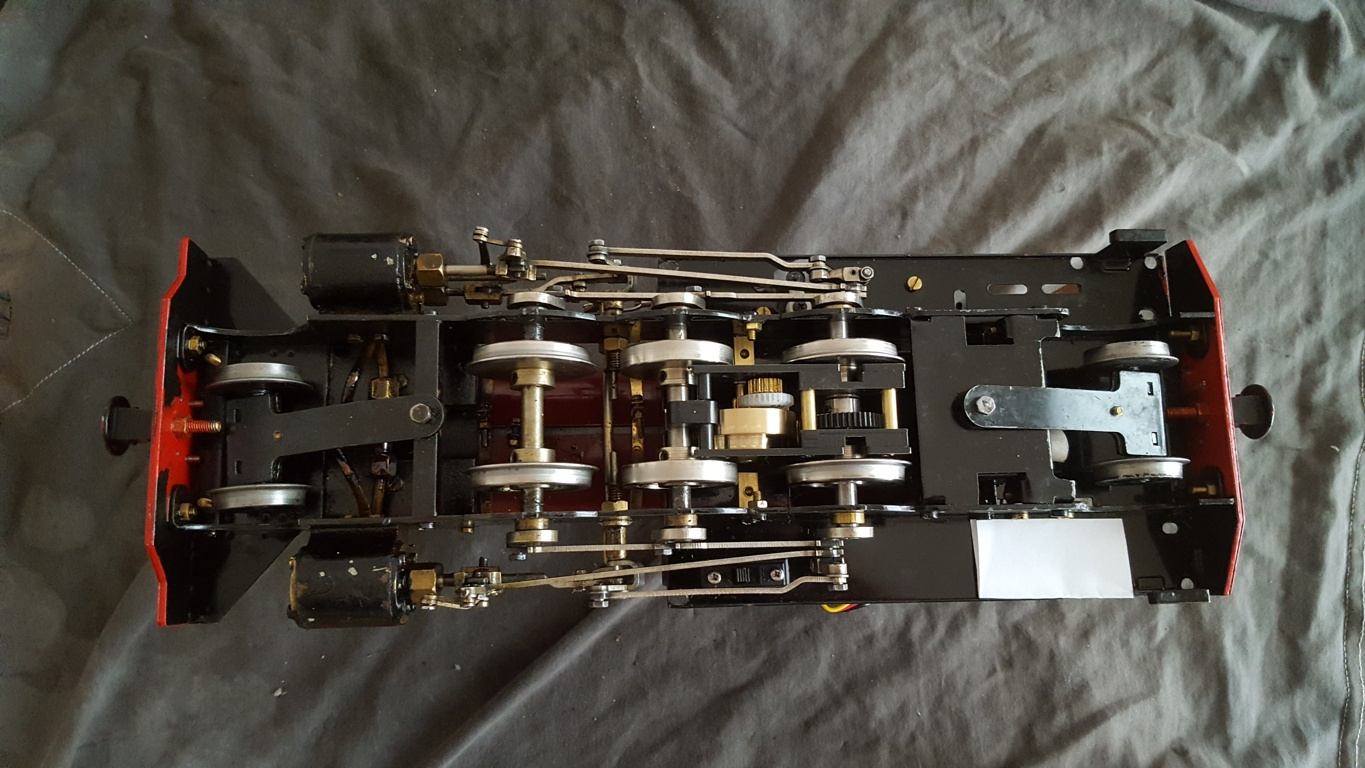

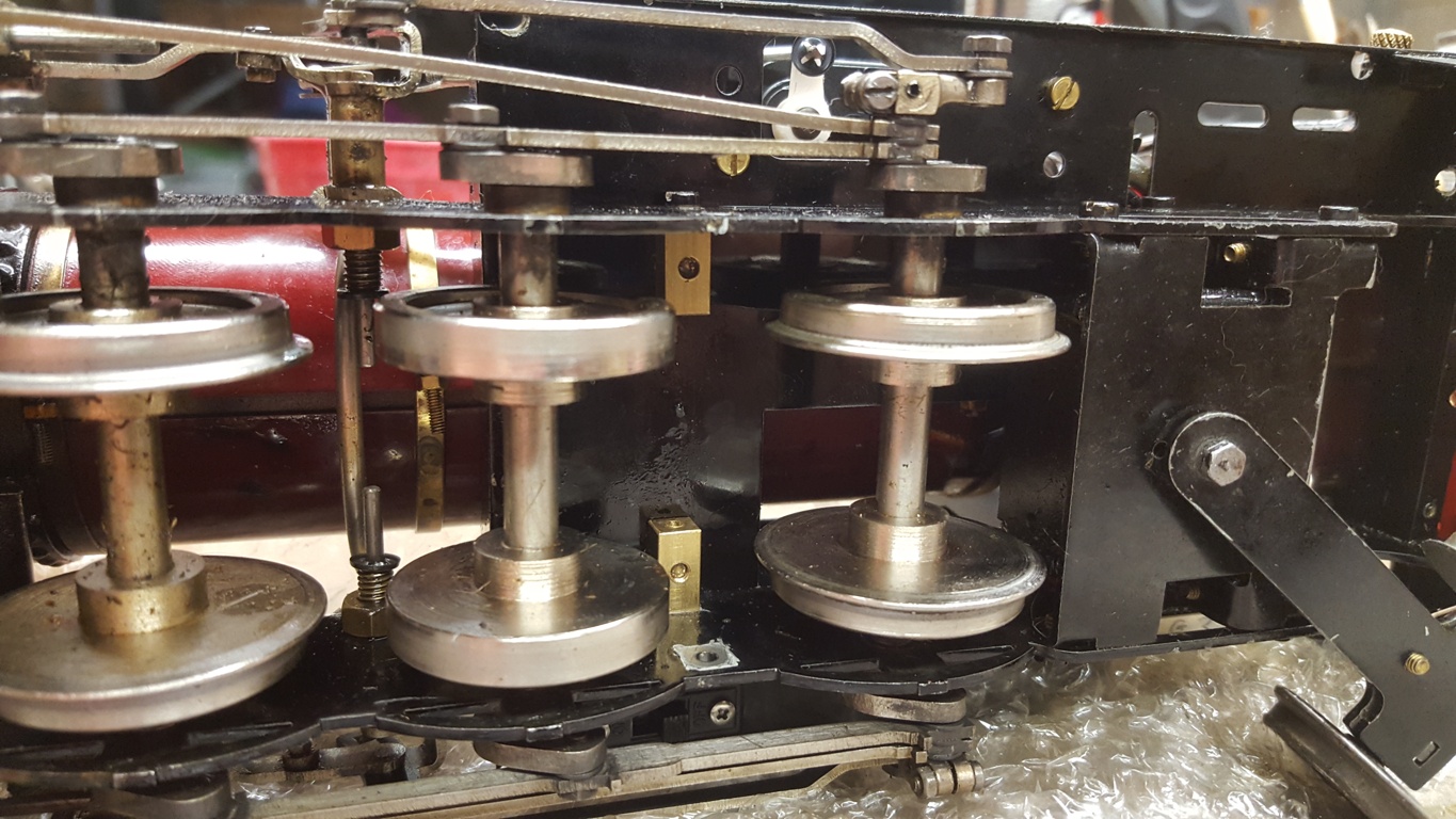

Andrew's Slomo should arrive today so I can get this fitted to his Russell.
I made a start on preparing the space for the device, frame spacers removed and smaller replacement spacers installed to retain rigidity of frame:

Nice and clean underneath there Tomβ¦..

Rather embarrassingly, I don't think it was anything like that clean when I sent it to Tom!!!

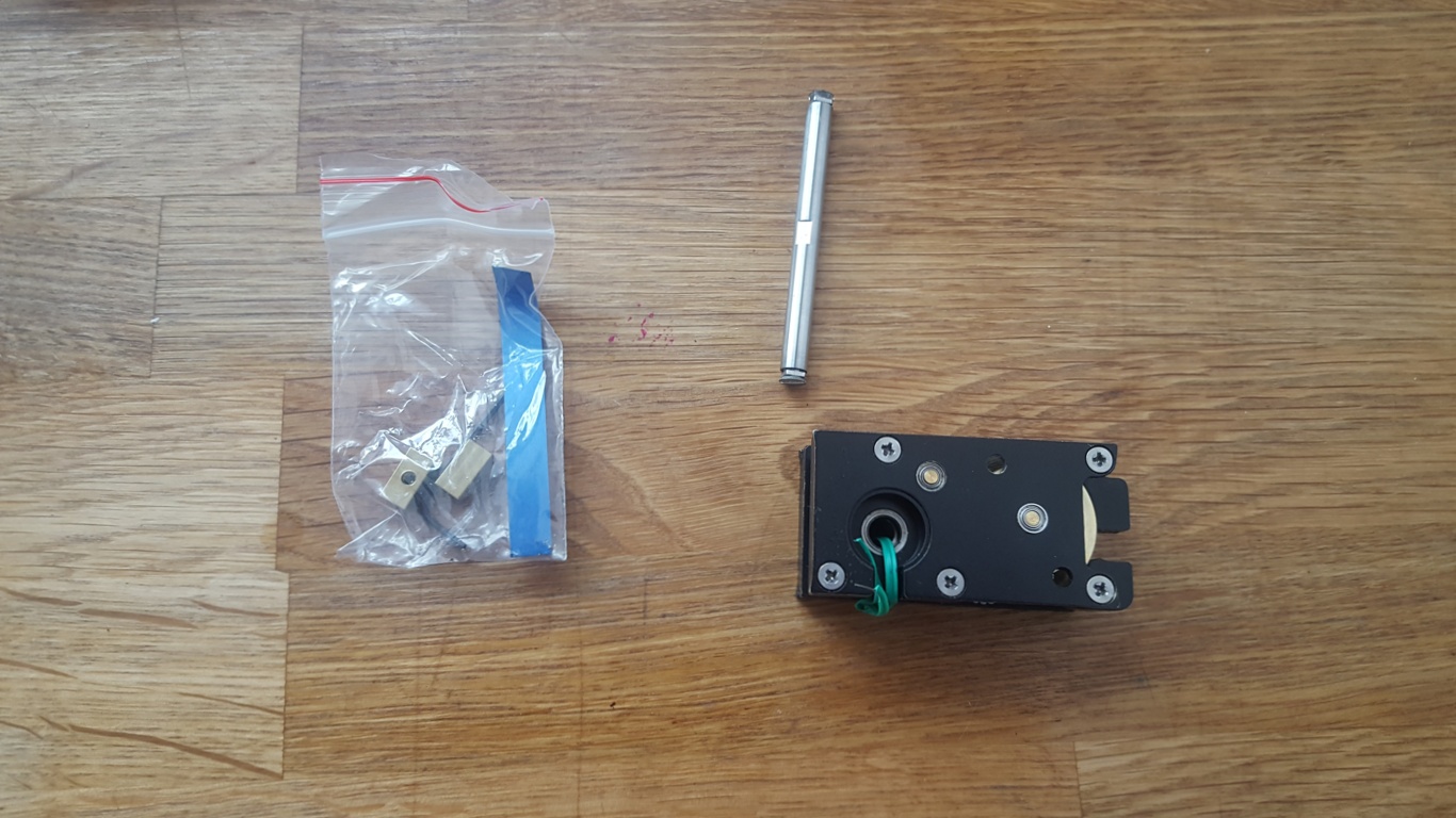

Terry (SSP Slomo) is always trying to improve his products. The latest Slomo comes supplied with an axle with a notch machined in place so the sprocket only requires one grub screw for a nice square fit on the axle.
Also, the Slomo housing now secures the axle bearings in place where as with the ones I purchased they were glued in with araldite (don't quote me, I am only assuming).

We ended up with a Roundhouse Russell fitted with a SSP Slomo, woo!
Test run next...

Andrew, I am going to find it very hard to send this back to you - it runs perfectly!
