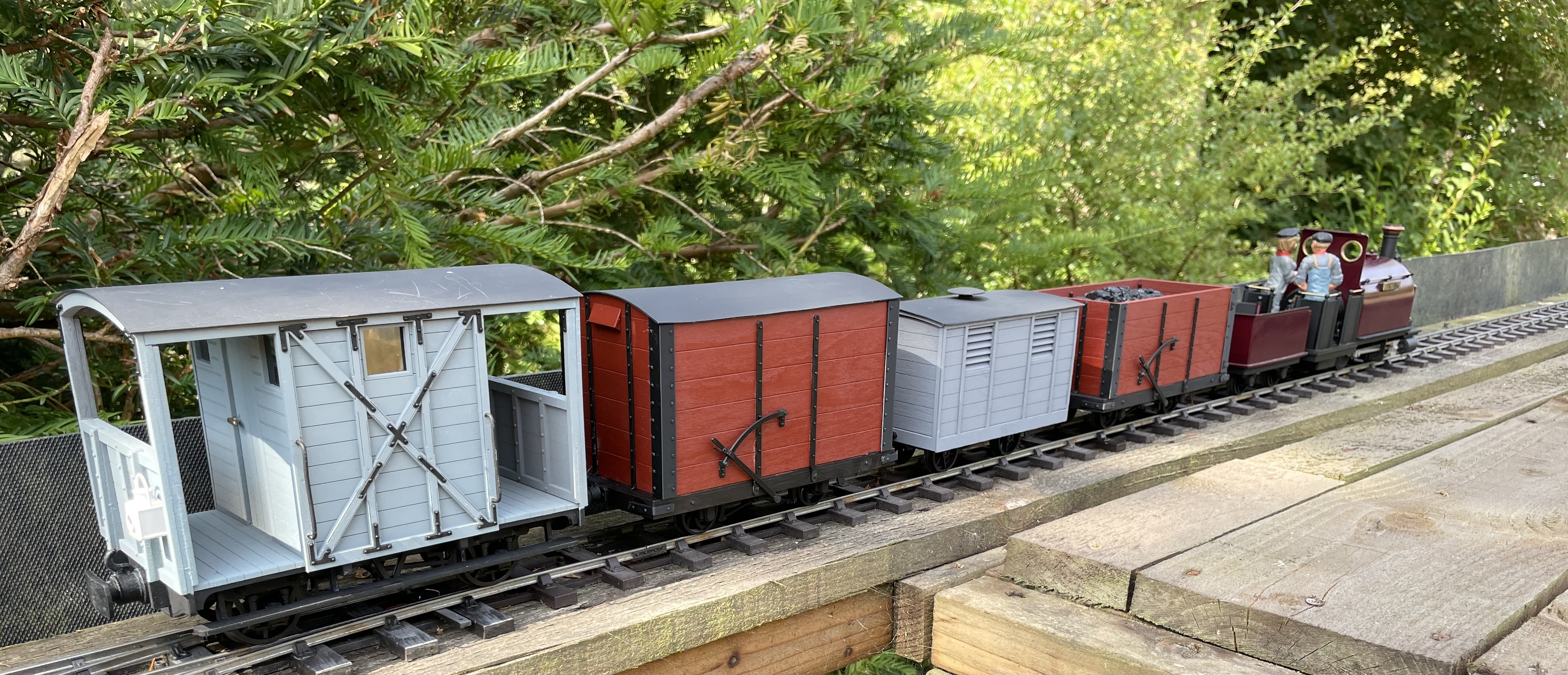

I have been building some Ffestiniog rolling stock from Huw Jones kits (https://www.hjonesengineering.com). Shown behind Bakewell are a four ton open wagon, a ventilated van and van 116:-
these were good kits to build. They have a 3D printed chassis and axleboxes, and the details are also 3D printed. The bodies are laser cut ply, roofs are plasticard - for van 116 I used a thicker piece than supplied in the kit

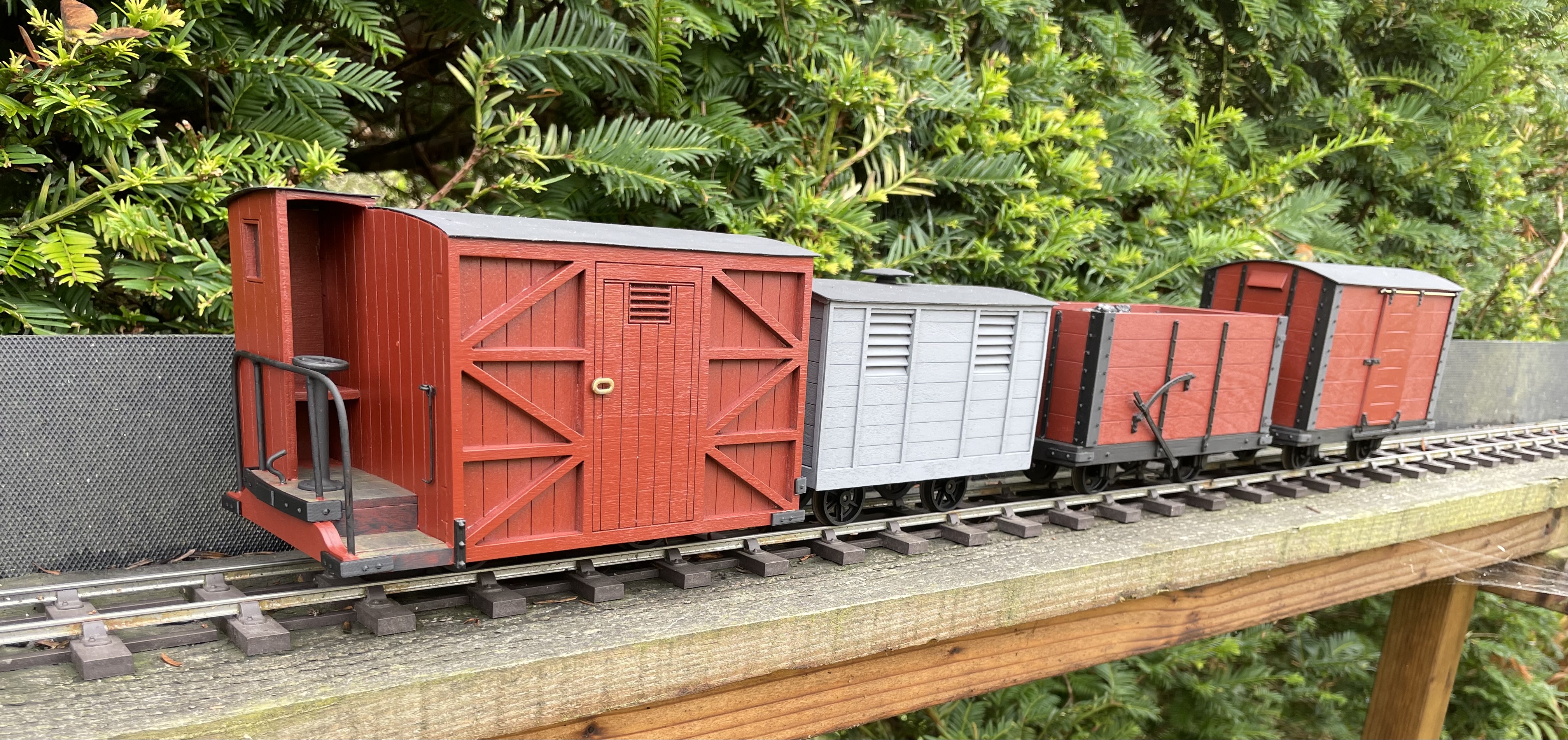

I have just finished the sentry box brake van. Here it is with the other three wagons from Huw:-
