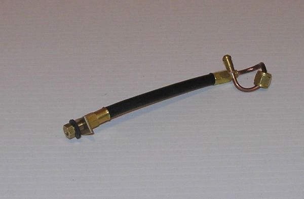

This Item caused much deep thought, consultation with experts Gordon Watson and GTB of this forum, and several mudmaps on various scraps of paper.
Very happy with how this turned out, and tested OK too.
And it is ???
Posted: Fri May 17, 2024 8:00 am
Not sure why it would need a flexible length of pipe - something to do with a steam whistle?
Posted: Fri May 17, 2024 9:52 am
I don't do live steam and have no idea how it works, but I love to see the wonderful work of Grant so will be watching with interest.
Just to join in with the guessing game, I see a flexible connection between two articulated units... e.g. loco and tender?
Posted: Fri May 17, 2024 12:13 pm
by Phil.P
Flexible link of some sort..
Steam feed on an articulated loco, perhaps?
Posted: Fri May 17, 2024 12:32 pm
by LNR
Sorry about this. I just posted an answer to Peter's comment but it didn't load.
So, another cupee doll to Peter, it is the flexible gas connection between engine and tender. I'm building a Roundhouse Fowler and don't want the gas tank perched up in the roof of the cab. I'm using a bigger gas tank in the tender which will also carry water.
