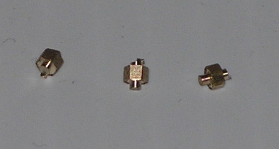

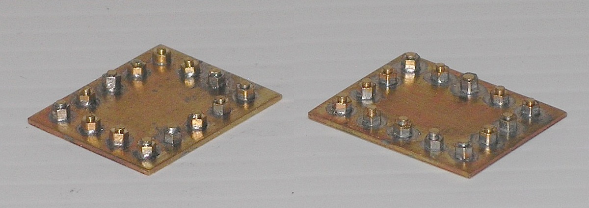

Twenty eight hand filed (in a jig) nuts from 3/32" brass rod. I've said before "you don't have to be mad, but it helps"
To decorate the valve chest covers.

Looks like a Sten gun.
Edit: That's what I get for replying before reading all responses.
Beautiful job. Those dummy valve spindle guides give it away.

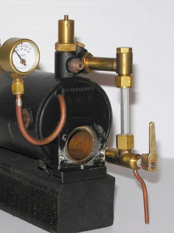

Well this Pic. really gives the game away.
I wanted a boiler gauge glass that really worked. I did have some theories but the first iteration worked, so I didn't continue. I've made the upper passages as large as I could (all 3/16th diam.) but I think the main point is the blow down. On several steam tests
snapping the blow down open and closed causes the water to drop to the bottom of the glass then snap up to the correct level. Happy chappy! The sharp eyed may notice another boiler bush hiding behind the pressure gauge. Not sure I'll go into that.
Neat that. Brilliant...

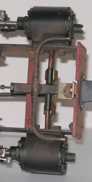

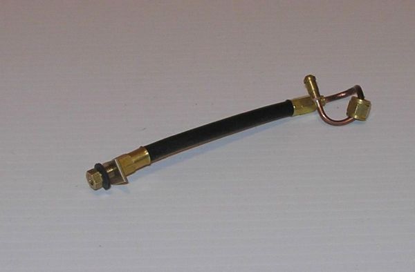

This Item caused much deep thought, consultation with experts Gordon Watson and GTB of this forum, and several mudmaps on various scraps of paper.
Very happy with how this turned out, and tested OK too.
And it is ???
And it is ???
- Posts: 7958
Not sure why it would need a flexible length of pipe - something to do with a steam whistle?
- Posts: 5711
I don't do live steam and have no idea how it works, but I love to see the wonderful work of Grant so will be watching with interest.
Just to join in with the guessing game, I see a flexible connection between two articulated units... e.g. loco and tender?
- Posts: 728
- Location: Staffs. UK
Flexible link of some sort..
Steam feed on an articulated loco, perhaps?
- Posts: 1884
Sorry about this. I just posted an answer to Peter's comment but it didn't load.
So, another cupee doll to Peter, it is the flexible gas connection between engine and tender. I'm building a Roundhouse Fowler and don't want the gas tank perched up in the roof of the cab. I'm using a bigger gas tank in the tender which will also carry water.

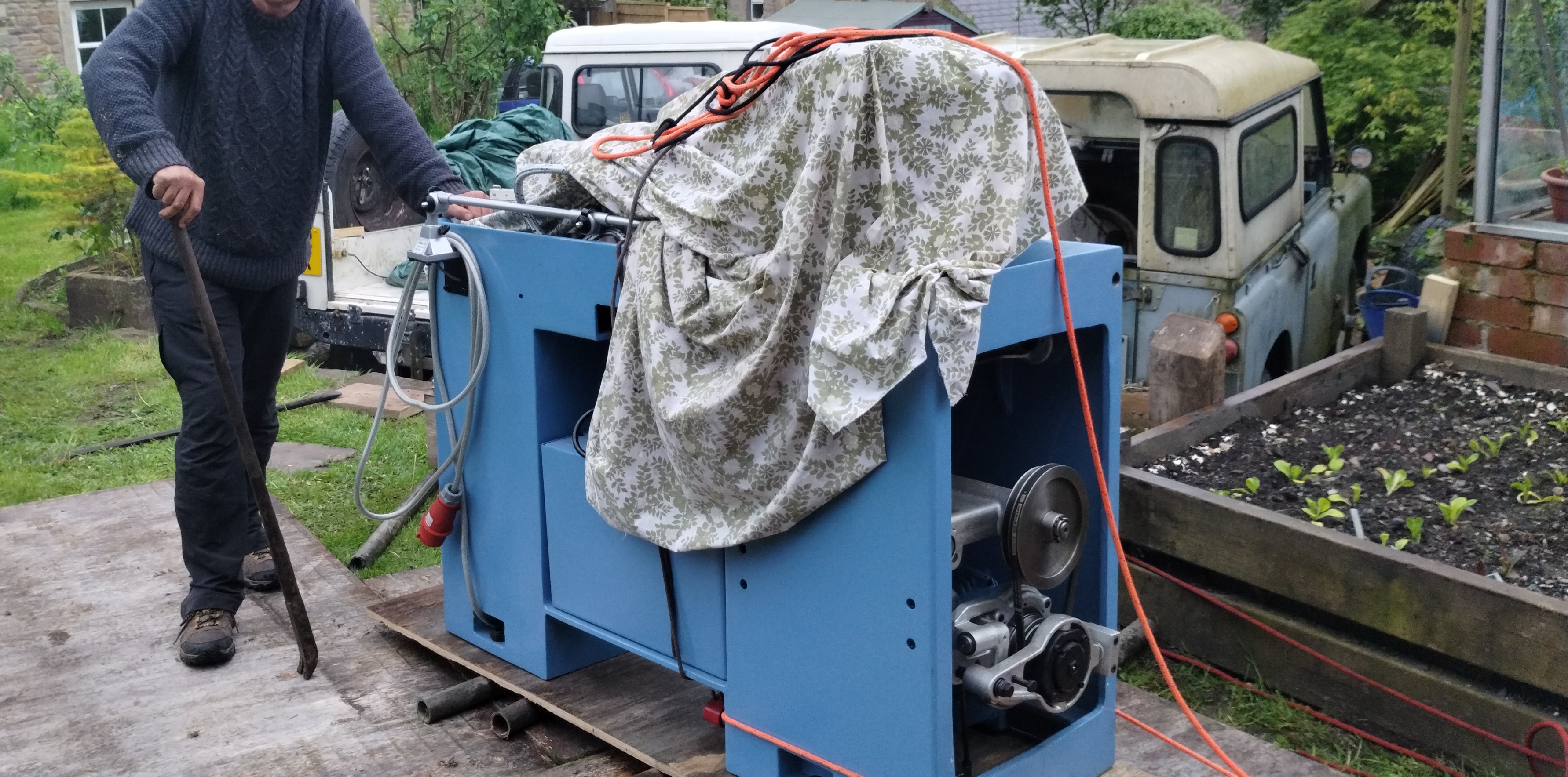

I've left it far too late in life to learn model engineering skills of your calibre, so am very envious of your skill. The nearest I've come to engineering is helping a friend last week to unload and install a 3/4 tonne Swiss lathe, previously owned by an aeronautical firm and used for making precision valves for Eurofighters. He is making clock parts, and a gauge 1 loco with it.

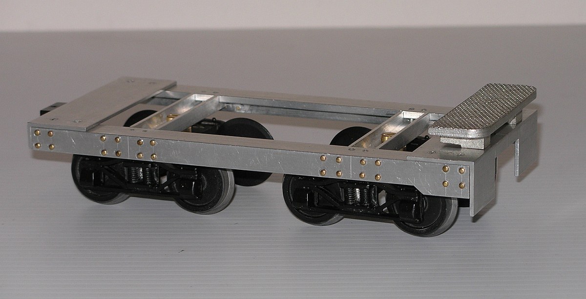

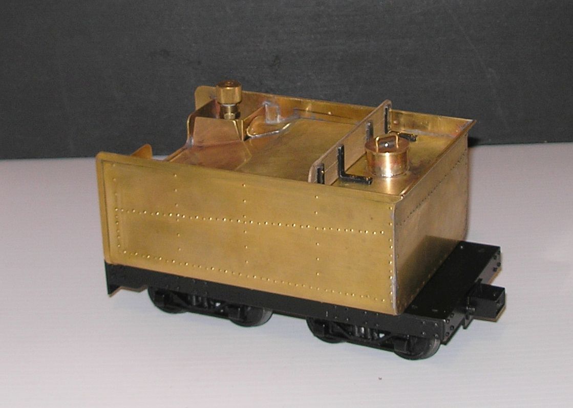

On the Fowler build, I was unhappy with the white metal frame casting provided. Apart from not liking white metal for something structural, the mold Roundhouse use is obviously well past its use by date, and according to the blueprints the rivets were wrong anyway.
A new under-frame was constructed out of aluminium, the correct rivets added along with proper bolsters to support the bogies. Even the step casting at the front had been drilled poorly and was eventually done away with.
After impressing more rivets to the tank sides, soldering closed 13 holes in the tender tank and with a new top deck I finally had something to hold water. More on the siting of the gas valve later.
Excellent build there Grant, very neat way of making your own wagon.

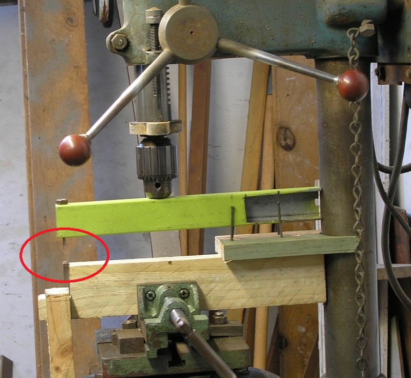

A certain Mr. H. Robinson recently stopped by my workshop.
This affair was required to adapt my rivet press vitals to be able to get inside the Fowler tender and add the extra rivets between those already etched in but too far apart for a water holding tank. I know it looks Heath Robinson but it worked and looked funny enough to take a piccy. The green bar goes up and down using the drill press and nails to guide it, and the mandrel and punch are circled.

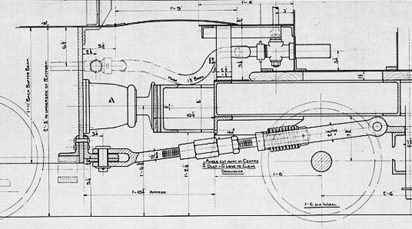

The extra tank rivets really sell it as a water tank. Wish I'd thought of that. Will have to check my Victory Decauville etches against the prototype (coincidentally, on the same storage road with the Fowler at Woodford) before before I assemble them..
My tender frame casting wasn't too flash, either. Didn't realise the bolster rivets were wrong until after I'd replaced the cast-in blobs with sewing pins!
I don't think the tender has that step at the front anymore. I'm not sure it ever did - then again you'd know better than I, you've got the drawings!

The blueprint does show the step. Big difference in height between cab floor and tender, fall plate would be running downhill. Just as a heads up on etched rivets, I set mine up on the line inside only to find when looking at the outside they were a little out of line (luckily so are the real ones it appears). It appears inside doesn't always match the outside of the etch.
And once again thank you for access to your pics. You make an apology about some of the pics. but your method is exactly the same as mine and does require a little interpretation along the line.

That's ingenious. How did you ensure that the pressure applied was the same each time? The end result is very good.LNR wrote: Thu May 23, 2024 7:14 am A certain Mr. H. Robinson recently stopped by my workshop.
- Posts: 1884
Thanks Phil, the pressure doesn't come into it as the punch is pressing the metal into a sized depression so when you hit bottom you're there.

Ah, I see. Job done, then.LNR wrote: Sun May 26, 2024 2:30 pm Thanks Phil, the pressure doesn't come into it as the punch is pressing the metal into a sized depression so when you hit bottom you're there.
