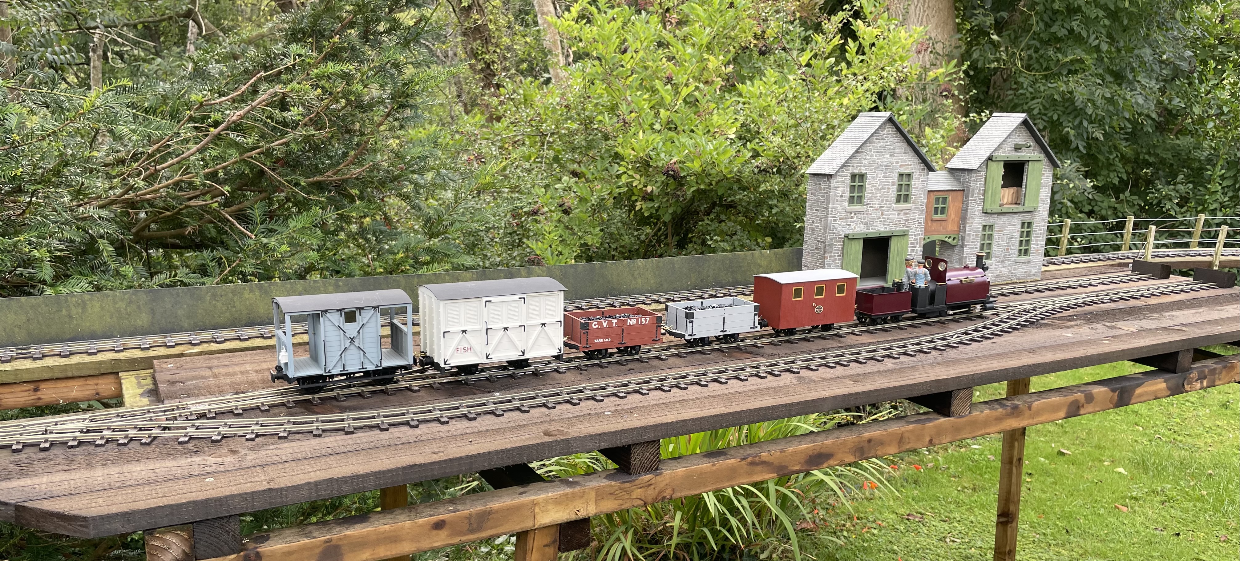

Having dismantled the boards which were previously used to link the two scenic modules of the thread title I had around 20' of usable Peco track and being pleased with what I had achieved in the new version of Yr Orsaf Newydd I decided to do a similar thing at the other end.
If a major play day happens the shunting puzzle can easily appear as a separate entity (though that would deprive the replacement version of its buildings). In between showers last week I built the new table surface and got a right hand point installed leading onto the new board. I had ordered two left hand points from a source advertising them at £10 each less - only to find they had none in stock at the end of the week. Two left hand points arrived at lunchtime today and the heavy showers which had occupied the morning gave way to sunshine so this afternoon track has been laid:-

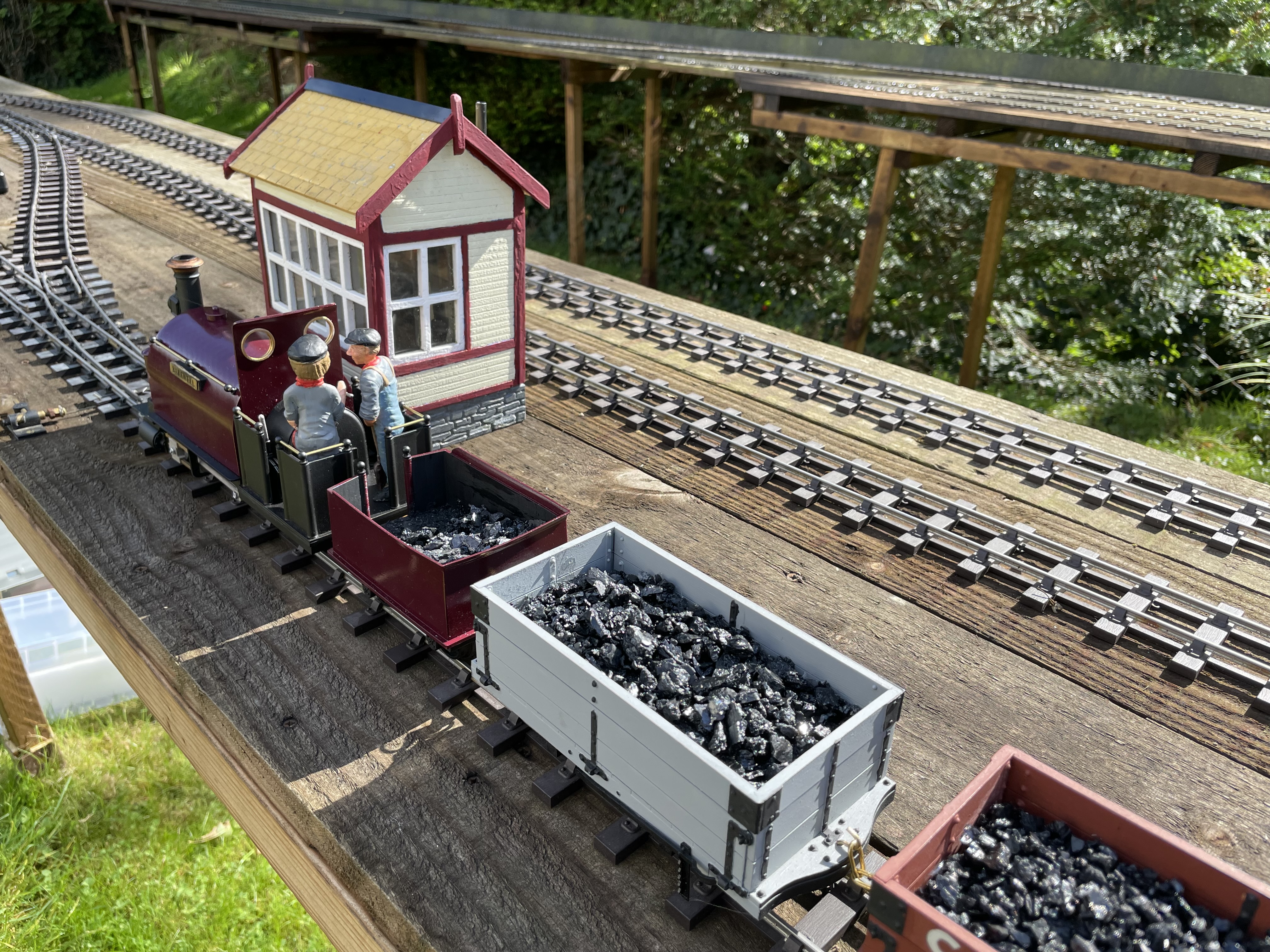

Bakewell did take some coal wagons back so that she could pose by the signal box in its recently changed livery:-
Unfortunately a few drops of rain fell so all timber based rolling stock was rapidly packed away in.

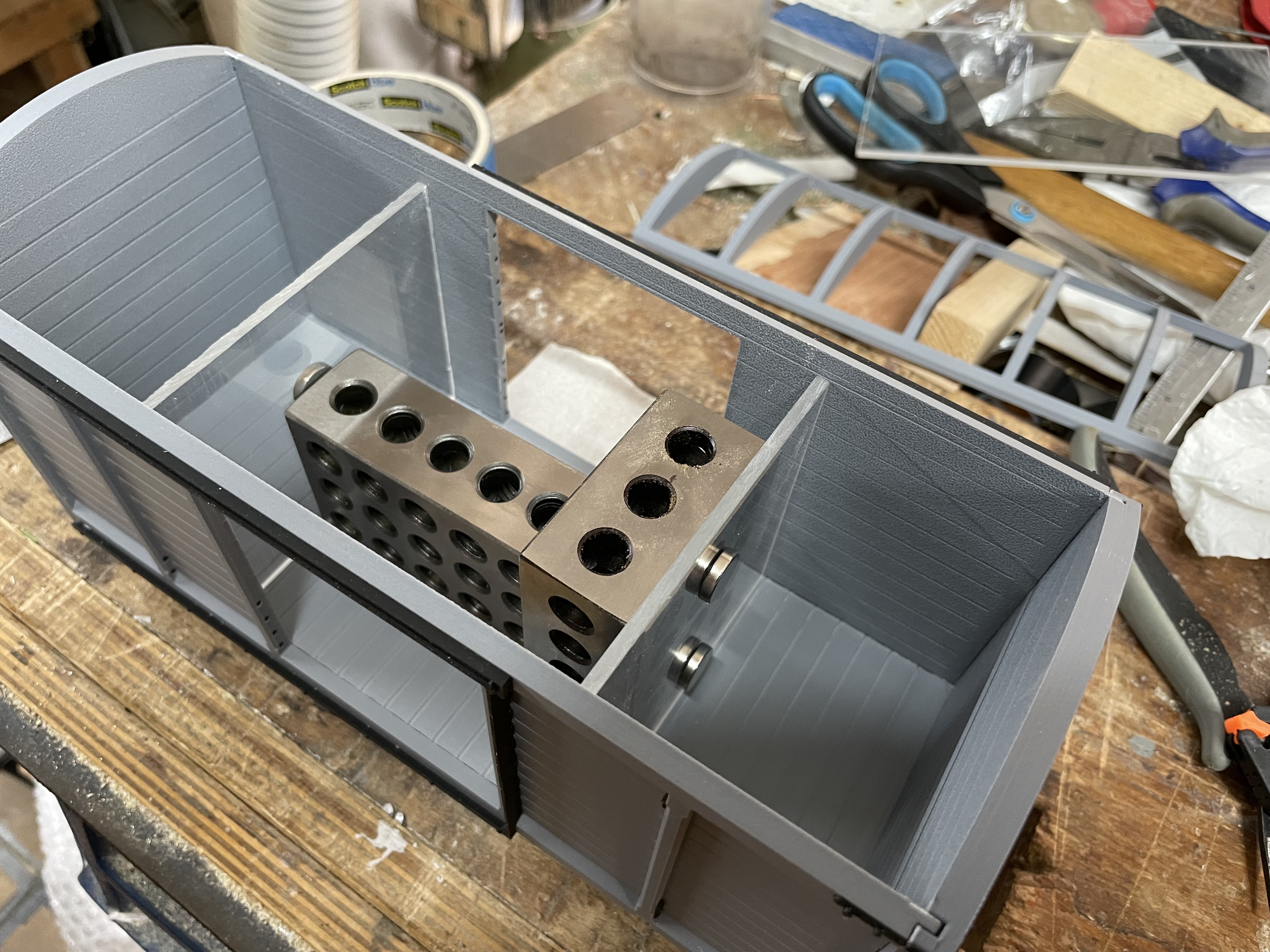

I have incorporated a pair of pieces of acrylic sheet in the hope of keeping the body in shape:-
I hope these will not appear too obvious when the doors are open.

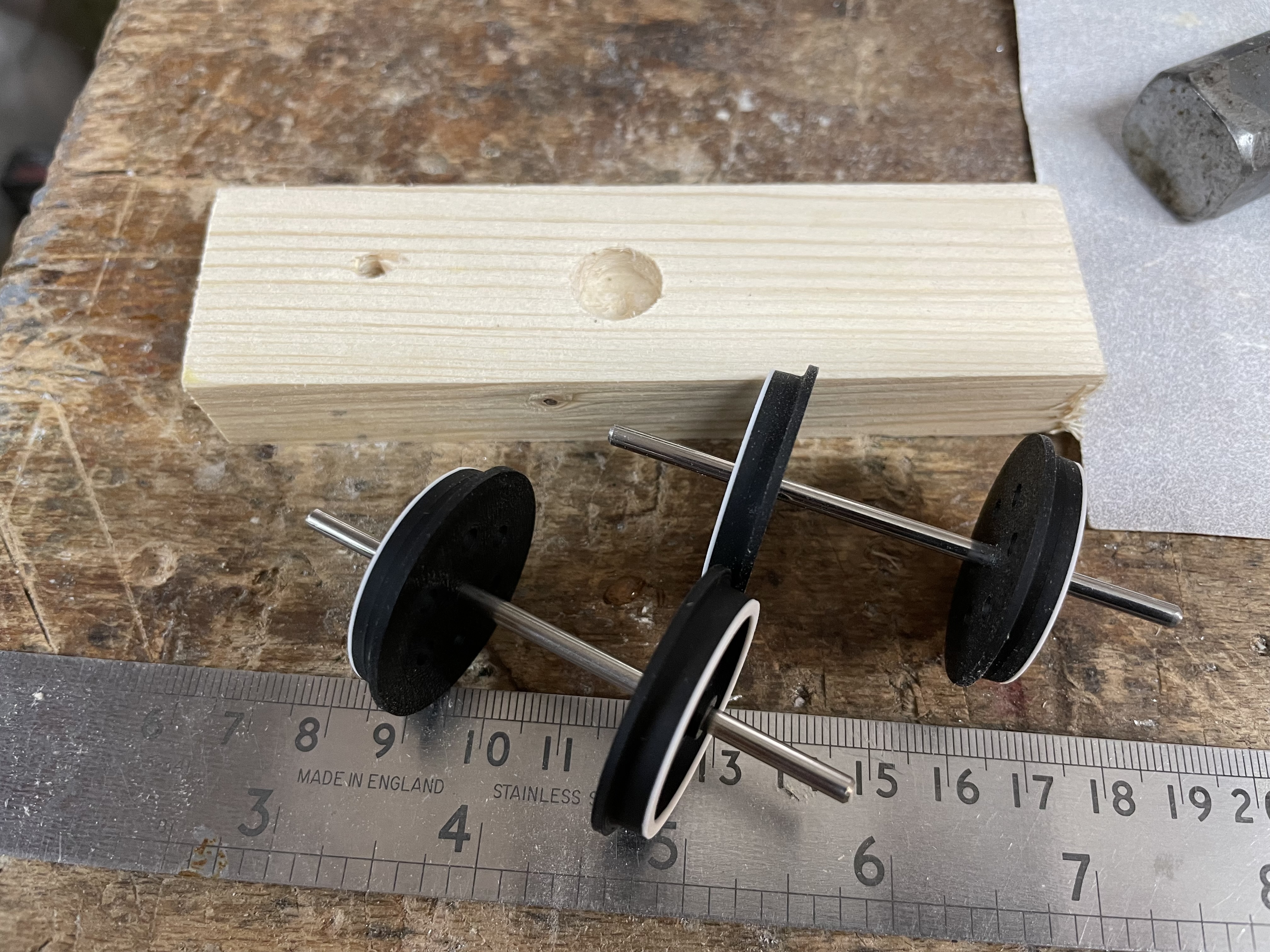

In building the first wagon I spent ages trying to get the wheels set correctly on the axles, just by measuring the distance from the wheel to the axle ends and tring to get them the same and correct. Today for the second wagon I tried using a jig. Simply a piece of scrap wood the correct thickness with a hole drilled through. The block was marginally too thick but a quick sand with coarse abrasive got it spot on:-
The block was placed on the steel rule as the axle was tapped through the wheel, my workbench has far too many dimples!

Phil. After puzzling a while at what looks like very futuristic cargo in your van, I have concluded you have some extremely clever composable magnetic clamp and set square alternative going on there... is that correct?
gilfachphil
- Posts: 429
Simon,
it's two 1-2-3 blocks between the acrylic pieces which are held by a couple of tiny magnets!

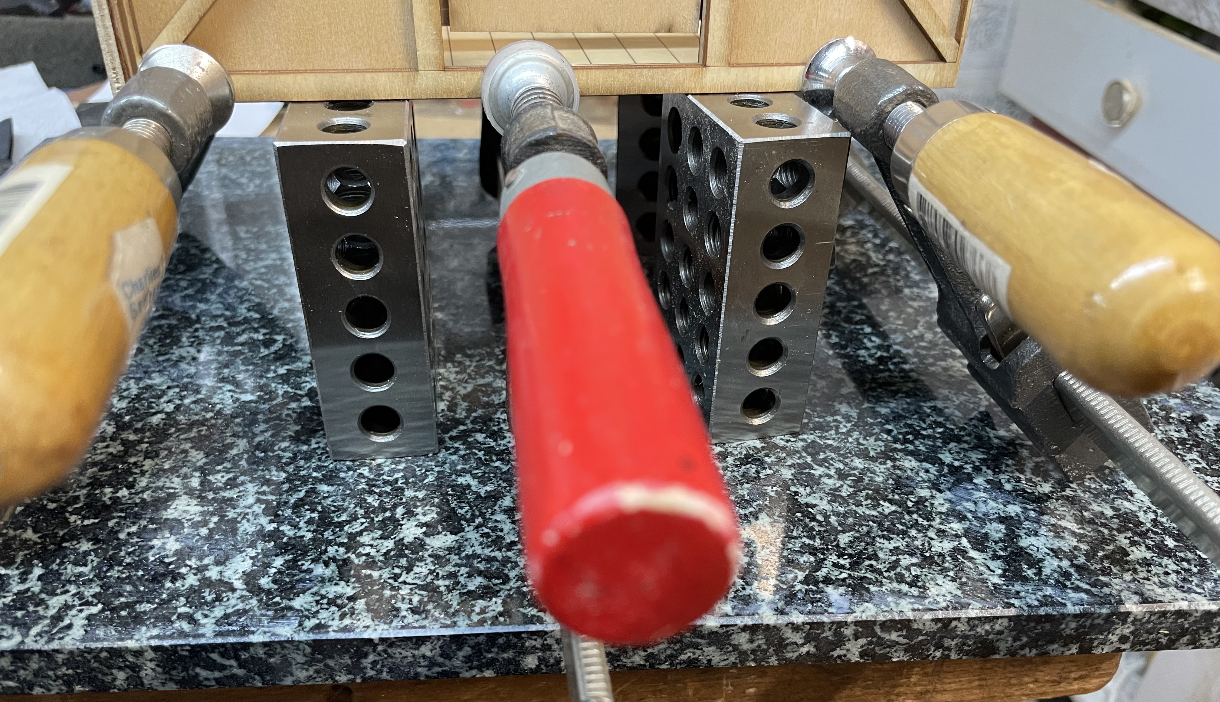

The first time I saw any of these blocks was a few months back when a friend was using them as weights while laying track, so I had to ask what they were.
Four were acquired via Temu. Here they are acting as supports for assembly of a wagon:-
I had to take this photo twice because when I checked the first one the side of the wagon was not down hard on the blocks. There's a lesson in there somewhere!
