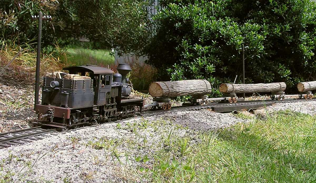

A photo posted by Jake (Tropic Blunder) has caused me to let the cat out of the bag.
The lumberjack driver has been in the boss's ear for some time, that loads and grades are getting too much for the engine. The engine has done many miles and breakdowns happen more often. He's concerned he may end up blocking the main line.

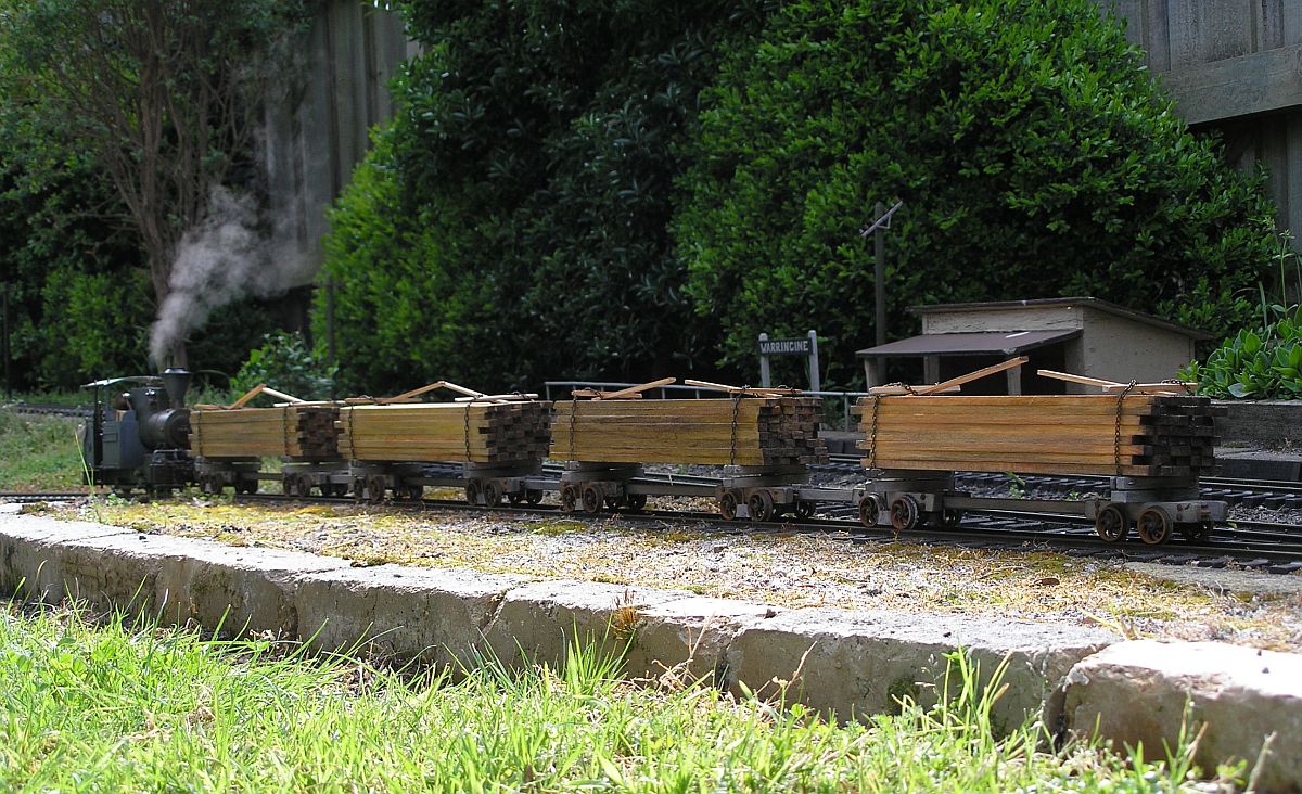

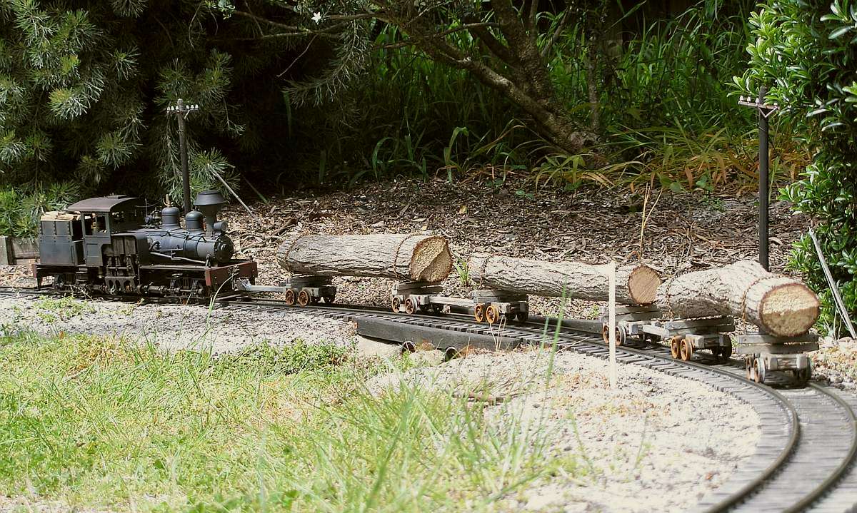

Loads of sawn timber heading for Leawarra.
I think the boss's heart over ruled his head when he happened across a fully equipped shay at a bargain price. Although sitting outside for some time, and with turbo generator, lights and a compressor(none of which are useable on the mill line!) Gray's Timber Products now has a three cylinder shay at it's disposal and an ex lumberjack driver with a grin to put a Cheshire cat to shame.

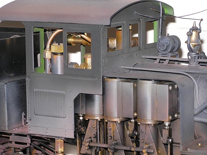

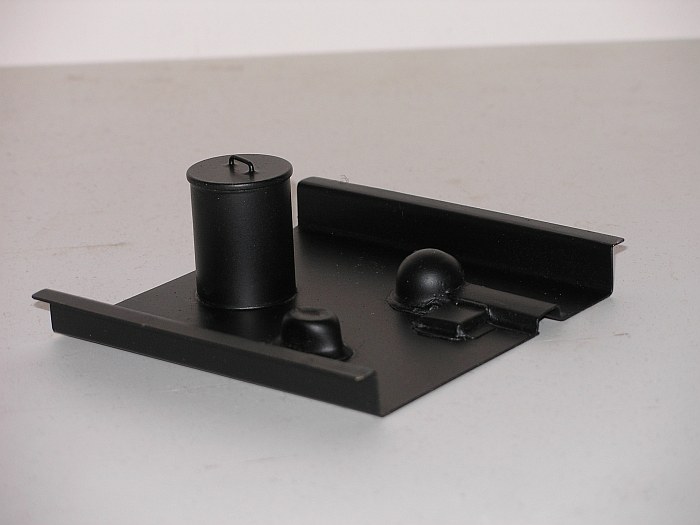

Thanks Jake, yes much work has had to be done to this shay firstly by Gordon under warranty. Many pipe leaks and fittings to be remade. Then comparing the drive shaft lengths with Graeme's shay I found out mine were much shorter, strange as I had already silver soldered an additional 3mm to mine because they kept popping out.
As the shay is 1:20th scale I decided to raise the cab 7mm in order to get 5ft 9" door height for a driver, and of course the new diamond stack. I made a new tank top that sits much lower to carry a wood load, that along with new throttle and gas control levers coupled with the raised cab means it's much easier to drive manually.
The pics. show the raised cab and the new tank top.

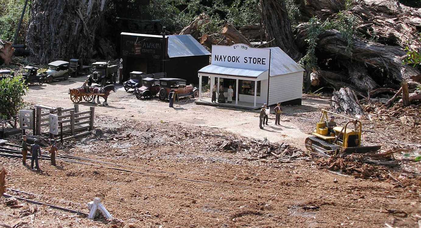

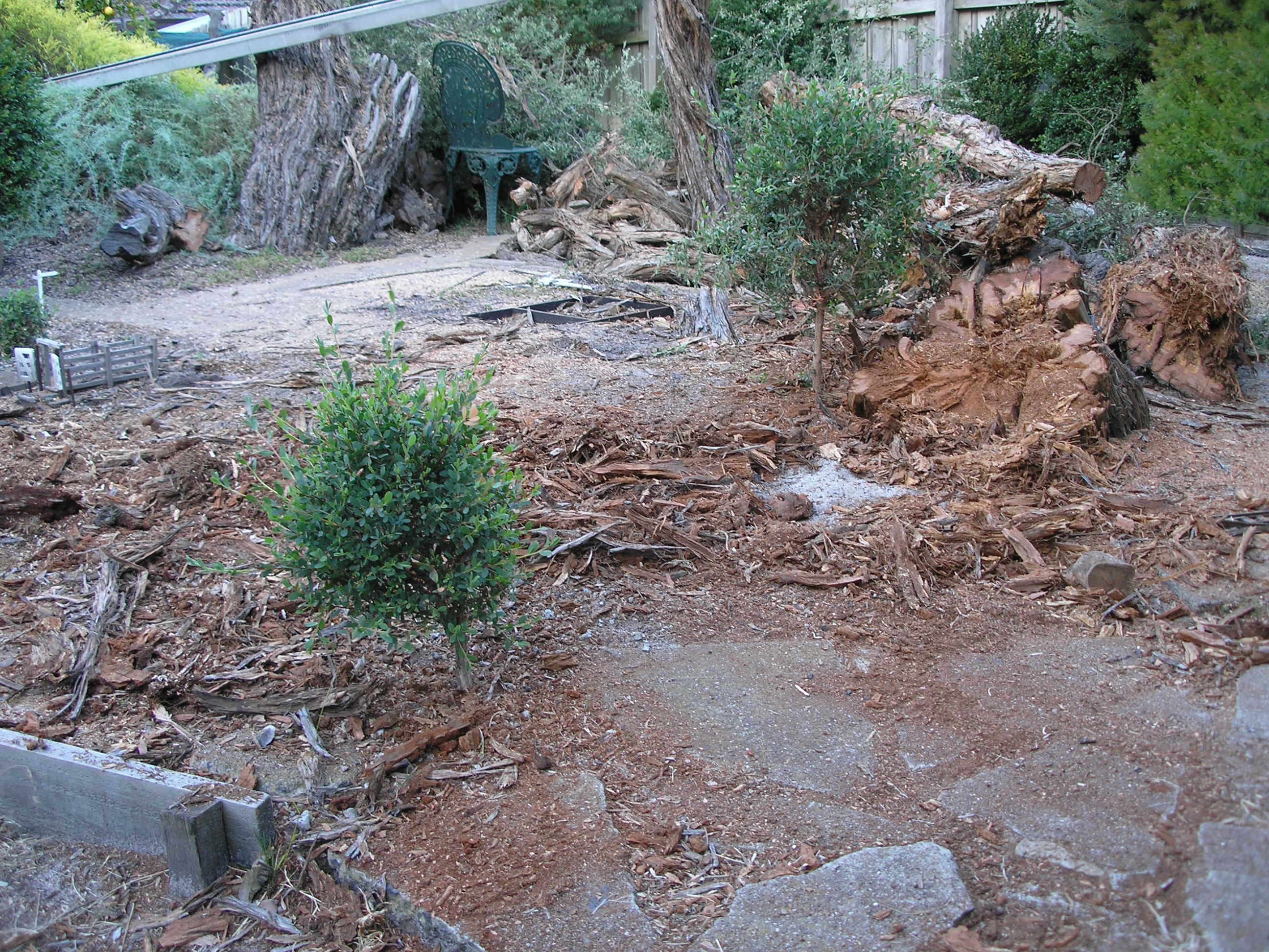

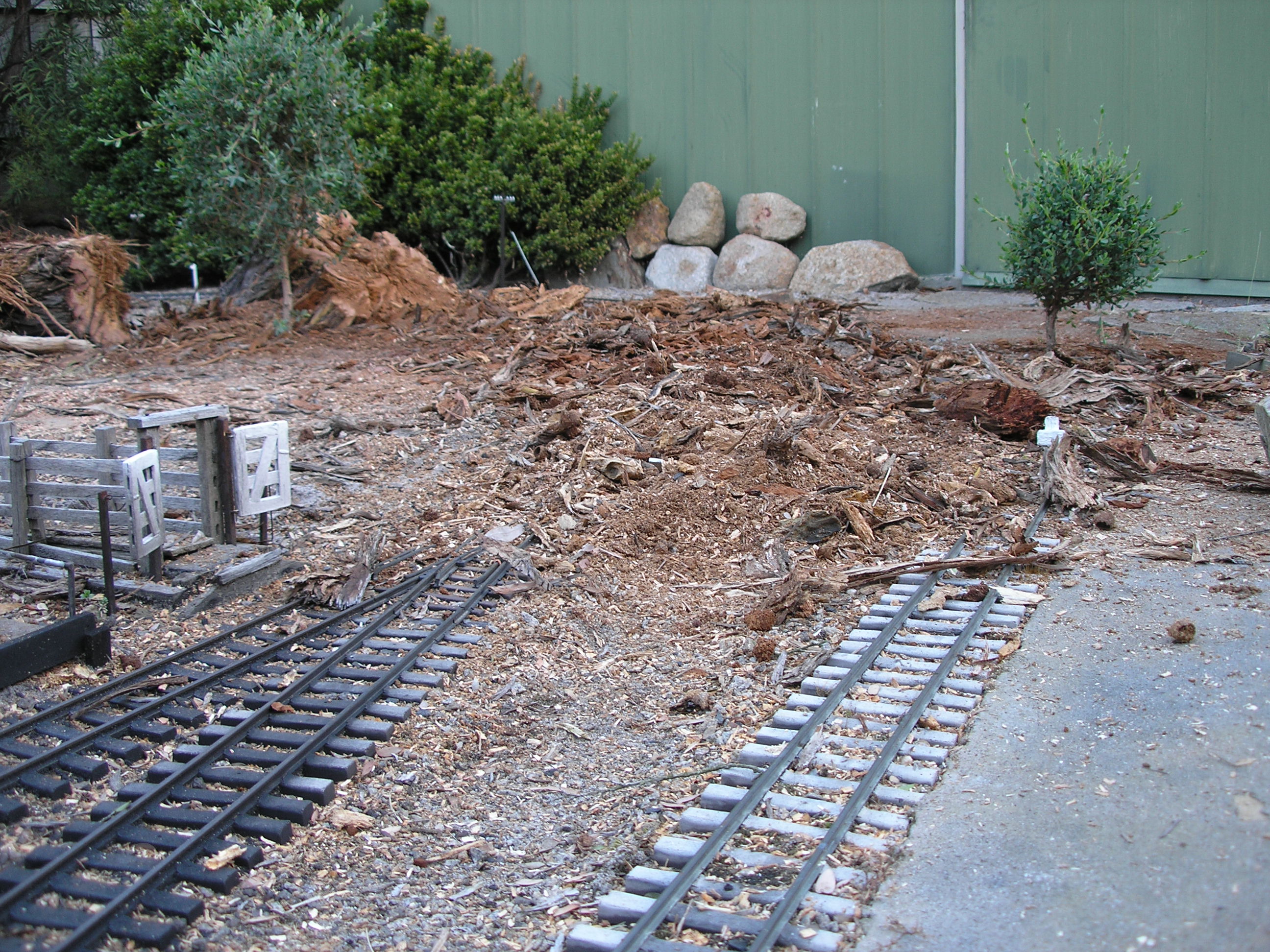

Well having survived the depression and with passenger numbers increasing, the LNR management have decided to order a new loco (currently being built as we speak) however the weather has thrown a spanner in the works with a severe storm bringing trees down and completely blocking the main line at the entrance to Nayook. Luckily not a single piece of infrastructure was damaged however there is a massive clean up to be conducted and of course no trains will be running until all is clear.

The pictures only show where the main trunks came down . The tree itself came down directly above
Nayook station and town buildings and didn't touch a thing. One knee on the tree hit the top of the wall behind the station and kept everything just high enough, another landed between the garage and the store, Phew!

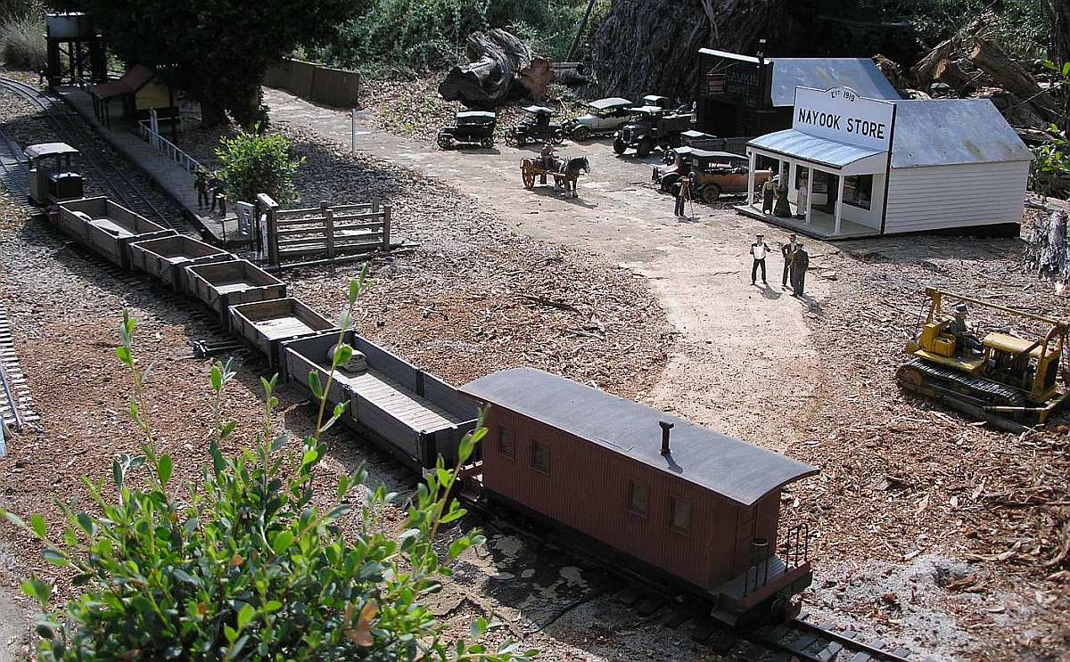

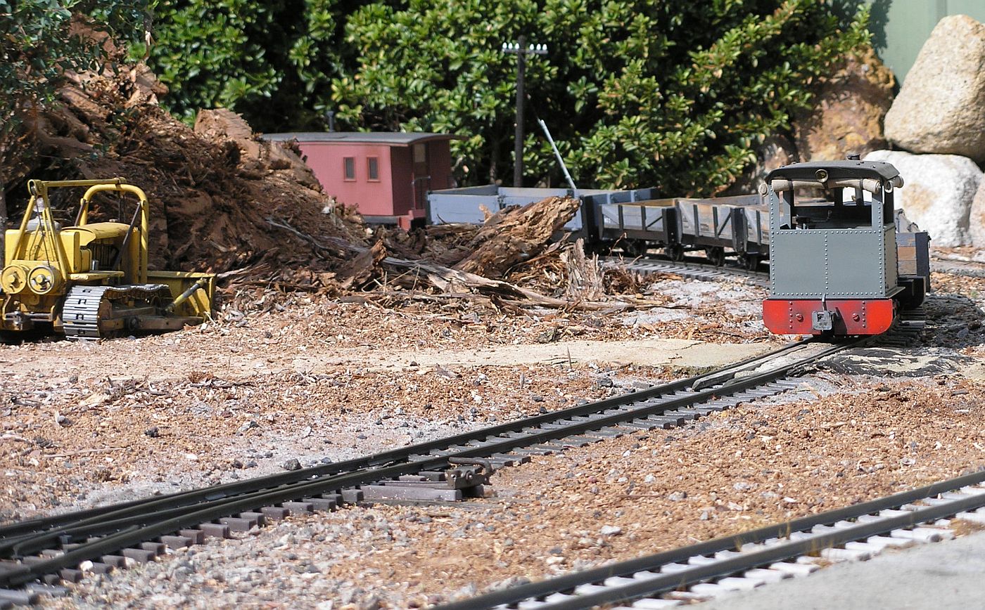

In typical country town fashion, word got out quickly and plenty of help was available. The Shire men's priority was the re-establishment of the road access, while the railway track gang concentrated on track clearance.
The press photographer covered the progress for the newspaper.
By late afternoon the first train waited at the site of the road crossing for permission to enter the station,
Then snake its way slowly into the yard.
