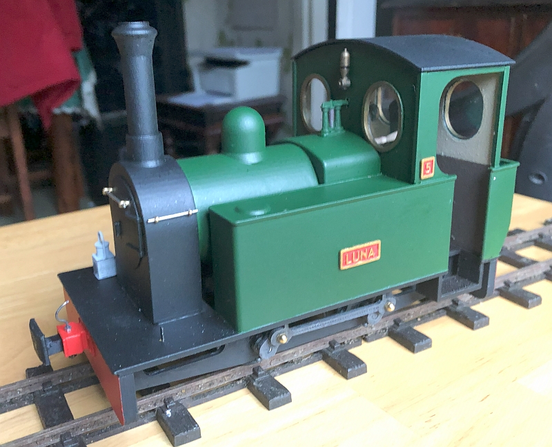

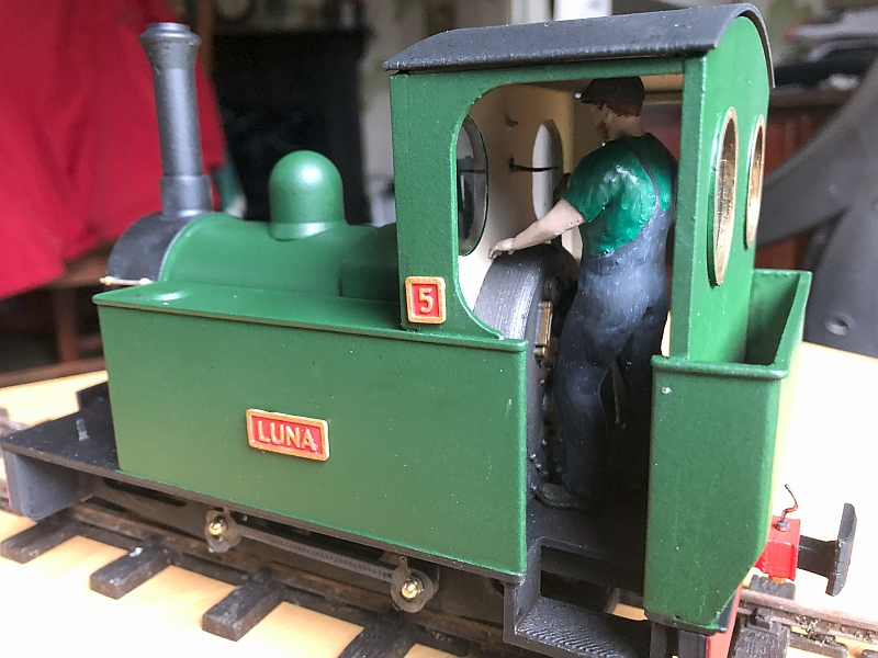

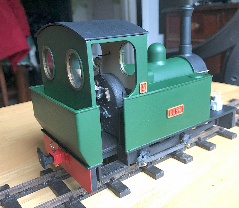

OK, after several days of messing about with bits and pieces, my Thornas is now finished. Along the way there seems to have been a gender change ( keep taking the tablets!) and Thornas is now LUNA ( named after our dog).
So following the last update:
The front lamp is now wired and working, although I think I may change the resistor because it's a little bit bright.

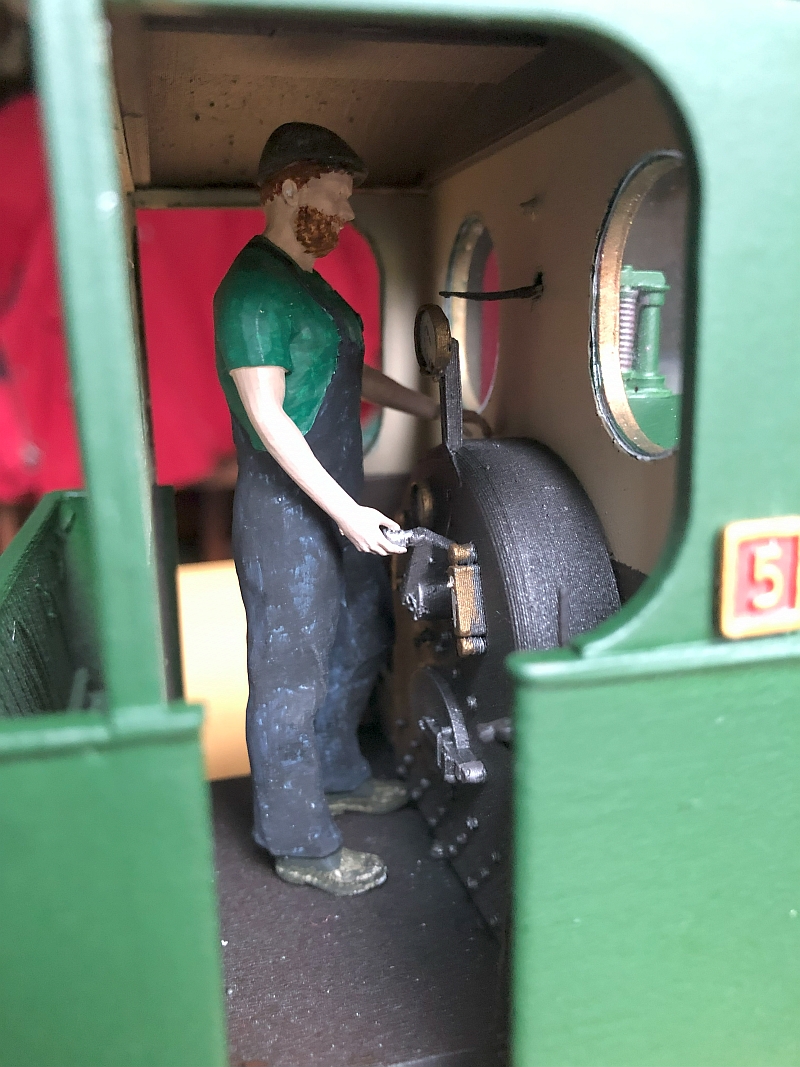

The windows are glazed, the cab interior and driver are fitted and I've added some handrails to the smokebox, plus a 2nd lamp iron on the front of the footplate.
I haven't as yet put another lamp on the bunker although the wire is there in case I decide to do it later.
She runs quite nicely light engine, although I believe I'll need to add more weight to haul a train. Because of that, the bunker is empty of coal so that I can get some lead in first.
I do have one problem but that is to do with the r/c not the loco. For some strange reason although the Rx65b finds the Tx ok when first switched it doesn't provide power to the motor and I have to switch both on and off a few times before it starts working properly. Its only this Rx that seems to show the problem though, switching the Selecta to another loco on a different setting and its fine. I need to do some more investigating.

She looks amazing! I'm taking lots of notes on how I could improve the original Thornas. The backhead really completes the cab and the driver fits perfectly, and the look is completed by all of the smaller details I wouldn't have even considered.

Looks great and runs really well.

A lovely little loco, the extra detail makes all the difference.

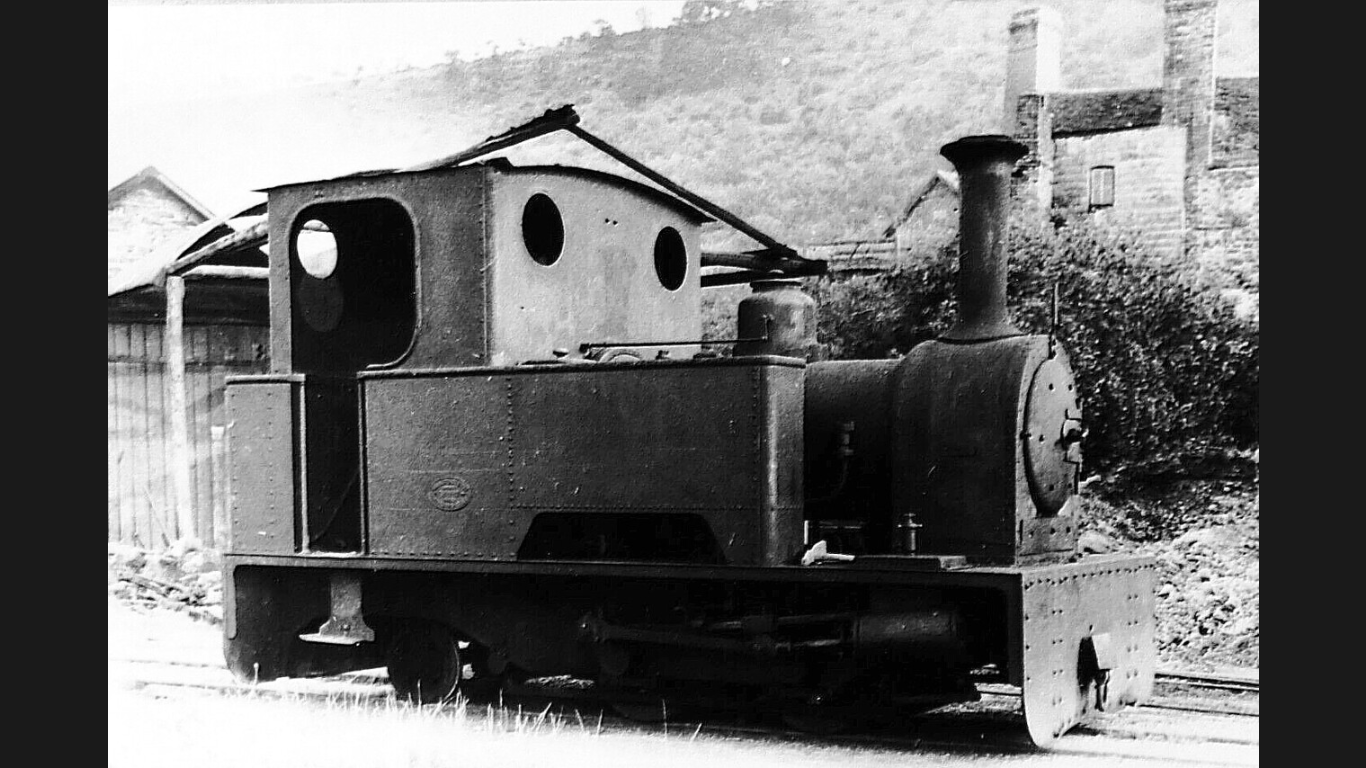

The Skylarks actually had a cab that could fit someone of 6ft height, tall for their day but average now. Even the standard Tattoo class has an unusually tall cabGTB wrote: Mon Oct 30, 2023 9:10 amThat makes the cab about the same height as a Kerr Stuart Skylark. The TVT engineer is 85mm tall and he just fits in the Skylark cab. I wouldn't worry too much, Skylarks weren't alone in having low cabs.philipy wrote: Mon Oct 30, 2023 6:33 am The tallest figure that will fit in the cab of Thornas is about 85mm high.
Anyway, the average male Brit was nowhere near 6' during the steam era, a steam loco driver was probably doing well to be 5'6" (88mm in 16mm/ft scale).

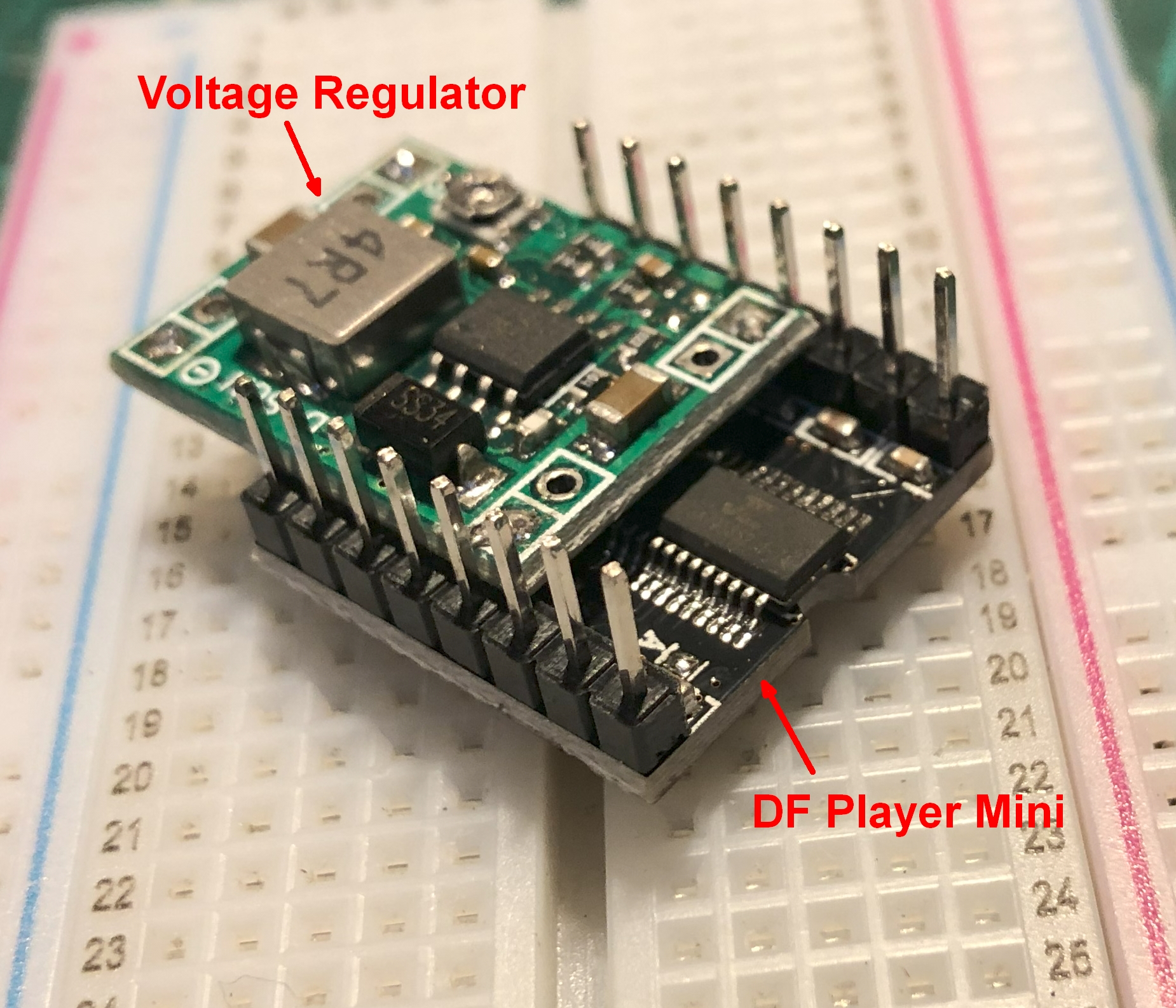

Anyway, I now had to get DF Player to play nicely with the loco and Deltang Rx65b.
I have 6x AA Low self discharge NiMh batteries in the loco, which when fully charged push out a smidgeon over 8v, which is perfect for the Rx but the DF Player wants 5v or slightly less, so I rummaged in my bits box and came up a small variable voltage regulator board and set it to give 4.5v. By happy chance, this board just fits between the connection pins on the player so the two together make a nice neat little self contained package. The player has the ability to play many tracks plus various controls, depending on how it is wired but I only needed two. The first track ( start and run) play as soon as they are triggered by the Rx, the 'end' track is then triggered by sending a signal to the "Next" command on the DF P. This overides the track that is already playing so the loco sound slows down, comes to a stop and cuts out. Then sending the initial command again starts the main clip, etc. There is a slight click when it switches tracks, but it is faint and quick and I can live with it - might not even be noticeable to anyone else.

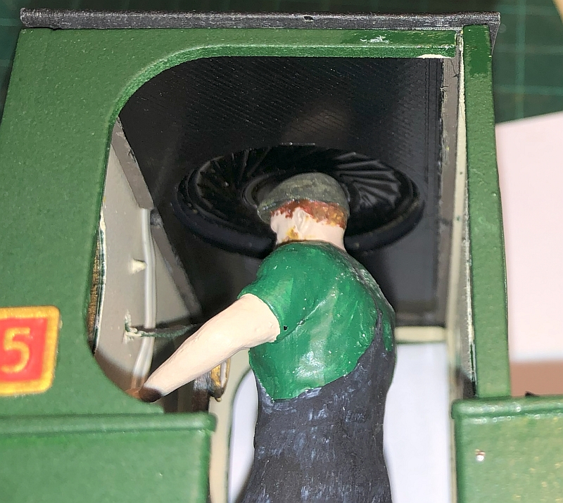

This where the fun started! The Rx65b that I used in this loco is actually one that I took out of something else because I had unsuccesfully tried to change the programming and it appeared to be faulty. However the basic functions still seemed to be ok. To trigger the DF Player I need to send signals to connect its input to ground (0v) and this should be achievable using Channel 3 on Pads 9 & 10 but it didn't want to know. Eventually after going round in circles between the Deltang website, and Rik's various blogs, plus the original little leaflet that had come with it, I finally worked out that my Rx was a version 11/03 which is before there were significant changes to the Rx firmware at version 11/11 and that the Channel 3 outputs on mine are Pads 6 & 7 not 9 & 10. Not only that, but P6 & 7 output plus 3v not 0v. It is possible to reprogram them to give 0v but thats a real pain using a Tx22 so I opted for the easier solution and knocked up 2 small transistor inverters which are doing the job nicely and all is now working fine. Carefully wrapped evrything in heat shrink sleeving then wired it to the loco properly and took it out to test it...all fine... except for a strange rattley buzzing noise which seemed to coming from the sound system but hadn't been there on the bench.
Back indoors, a quick inspection revealed the problem to be the driver. The speaker is mounted on the underside of the cab roof, facing downwards. It is 40mm diameter, 5mm deep, 8R, 1W, and I had designed and printed a housing for it with the bottom level with the top of the sidesheets. When I set it up, the roof was still loose, however testing outside revealed that in fact the driver was slightly taller than the sidesheets, so the speaker cone was sitting on his head and had actually deformed slightly, hence the buzz! - Remember that I spoke about the height of the driver, before? A bit of filing of the top of his head, some careful measuring and a slight redraw of the mount, and the speaker now clears his head by a mil or two. The speaker wires are two strands from an old grey ribbon cable and the slots in the sides allow them to exit the housing and run down inside the cab front to a hole in the top of the backhead.

Loving that speaker in the roof, great idea!
