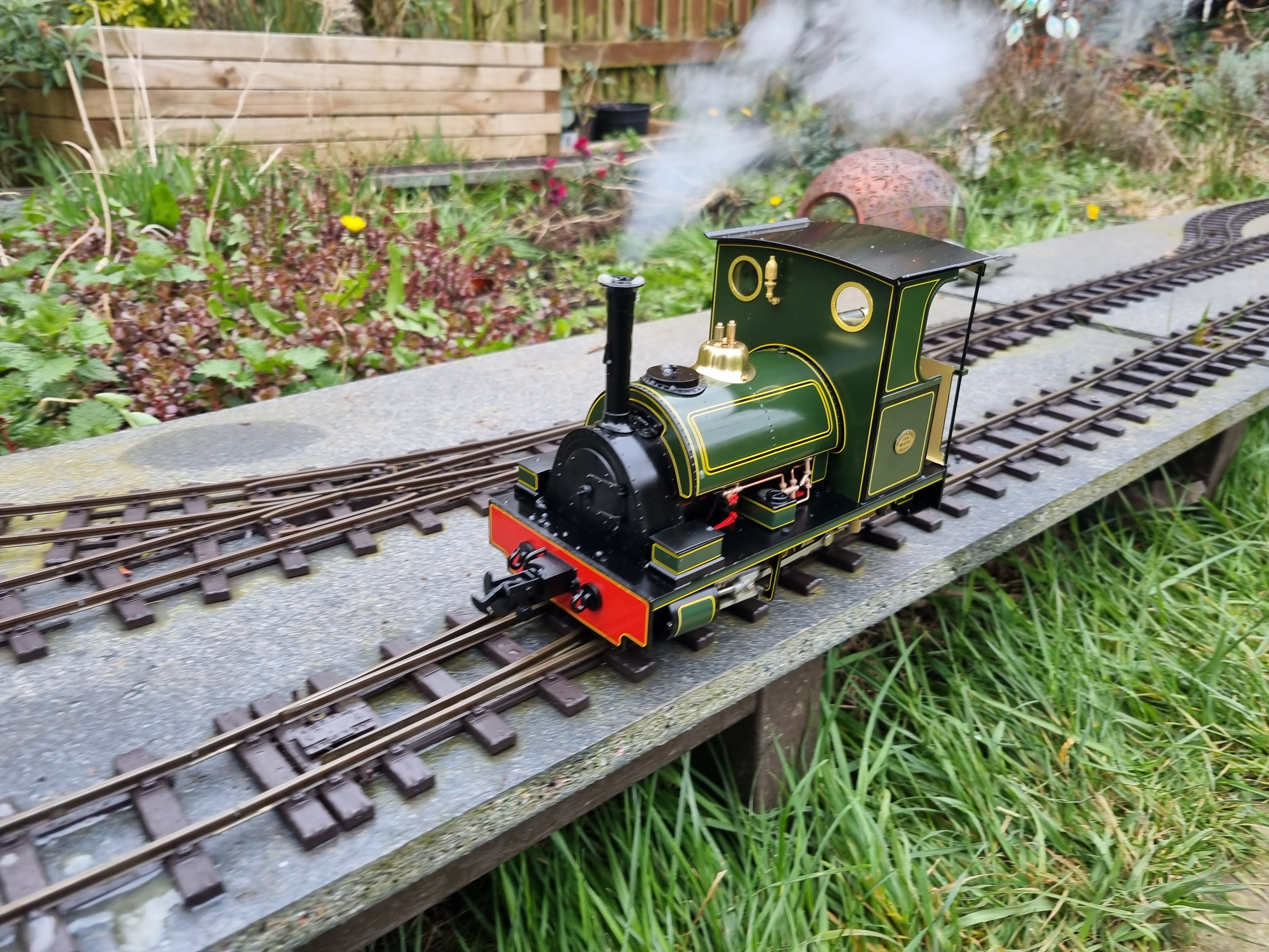

It was my 40th birthday on Friday (1st April) & I took a trip down to that well known engineering firm in Doncaster to collect 1 loco. Another arrived in the post the following day.
I've been very lucky to get one of this years just finished Palmeston locos from Roundhouse in brunswick green which I had hoped for.
Shes been interesting to fire & get running but with care she steams well. If your thinking of buying one my tip is to light it from under the cylinders not the chimney, keep the gas really low & the cab roof off until the burner settles down. Then turn up the gas.

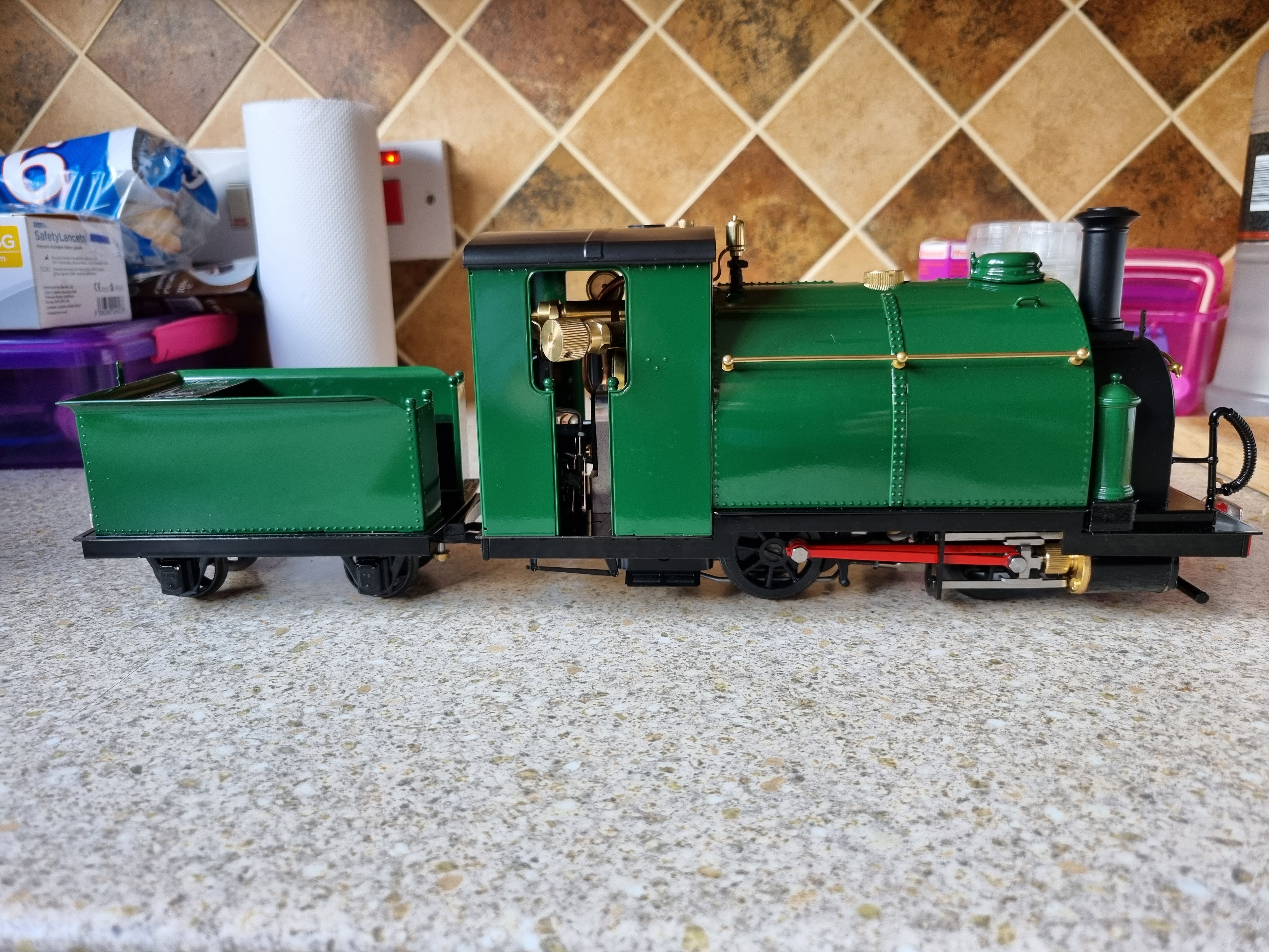

I also treated myself to a accucraft cranmore peckett. It has no relevance what so ever to Wales but hey ho it's my 40th & I love the peckett works livery.
Shes been a lovely steamer from the word go & I would recommend one to anyone.

Always the best way to do it. Put the flame where the heavier-than-air gas is, not where it might be.

Unfortunately the England is going back to Roundhouse, it has issues. It will not stay lit, I can get it to light but it soon goes out & will not re light. Gas is hissing from the burner but it will no light. I have run it once but a slight breeze & its out. Most of my roundhouse engines run in heavy wind & my accucraft peckett would keep going in a hurricane.

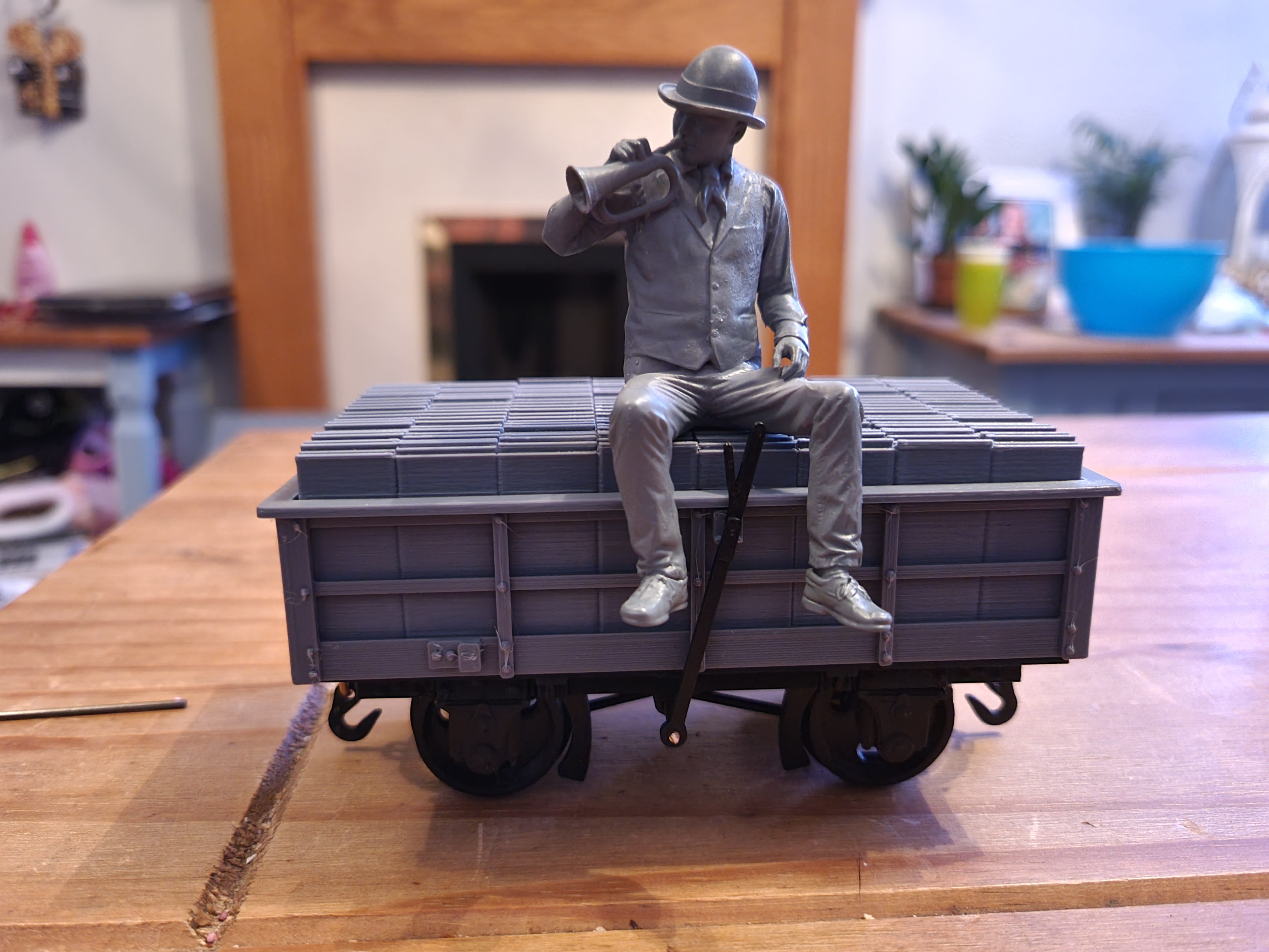

With the weekend looming all was not well in our house. Our children have all had a sickness bug that's taken half the school with it & many of very ill. Well sods law & all that, my wife starts Friday too.
Thankfully I'm the only one who's not suffered its wrath which I am pleased about. After caring for them all saturday afternoon, they all had an early night & so rather than twiddle my thumbs I set about a loco remote Gravity Griff Ffestiniog slate wagon by Locoremote.
I think I was rather lucky with this one because I don't think he is doing anymore & it's a quirky wagon. I've actually been thinking for sometime before I came along this kit as to how I could make a gravity wagon work with remote control.
The kit is rather simple with all the bits slotting into various bits of the chassis or body. All the wires are pre soldered (extra cost) & its all designed to fit inside the slate load. It's got a clavey models figure specially designed for the kit added on to make it realistic. The model is also sound fitted for the distinct trumpet sound you hear when the gravity train is running.
I plan to get a bit of primer on the various parts today so I can spray it up & weather it. I will keep you posted.

That looks really nice so far, most impressed by the quality and detail of the figure as well.
Once you've finished it we need a bit of video with sound of it running, even if just down a spare length of track!

I was wondering about the figure as well. Is it cast resin or resin printed?

The figure is a Richard Clavey product but I couldn't tell whether this is printed or moulded. I've purchased the same one together with the gravity waggon and 3 more slate waggons. You are slightly ahead of me in production - i.e. I've opened the box!😂

Thanks for the link. In the descriptions it says .....
This figure has been 3D printed by my CLAVEY models print factory, then manually finished and manually sprayed with primer coat ready for painting with Acrylic paint.
Given the crispness and level of detail they must be resin printed. Presumably they have been scanned from real people....

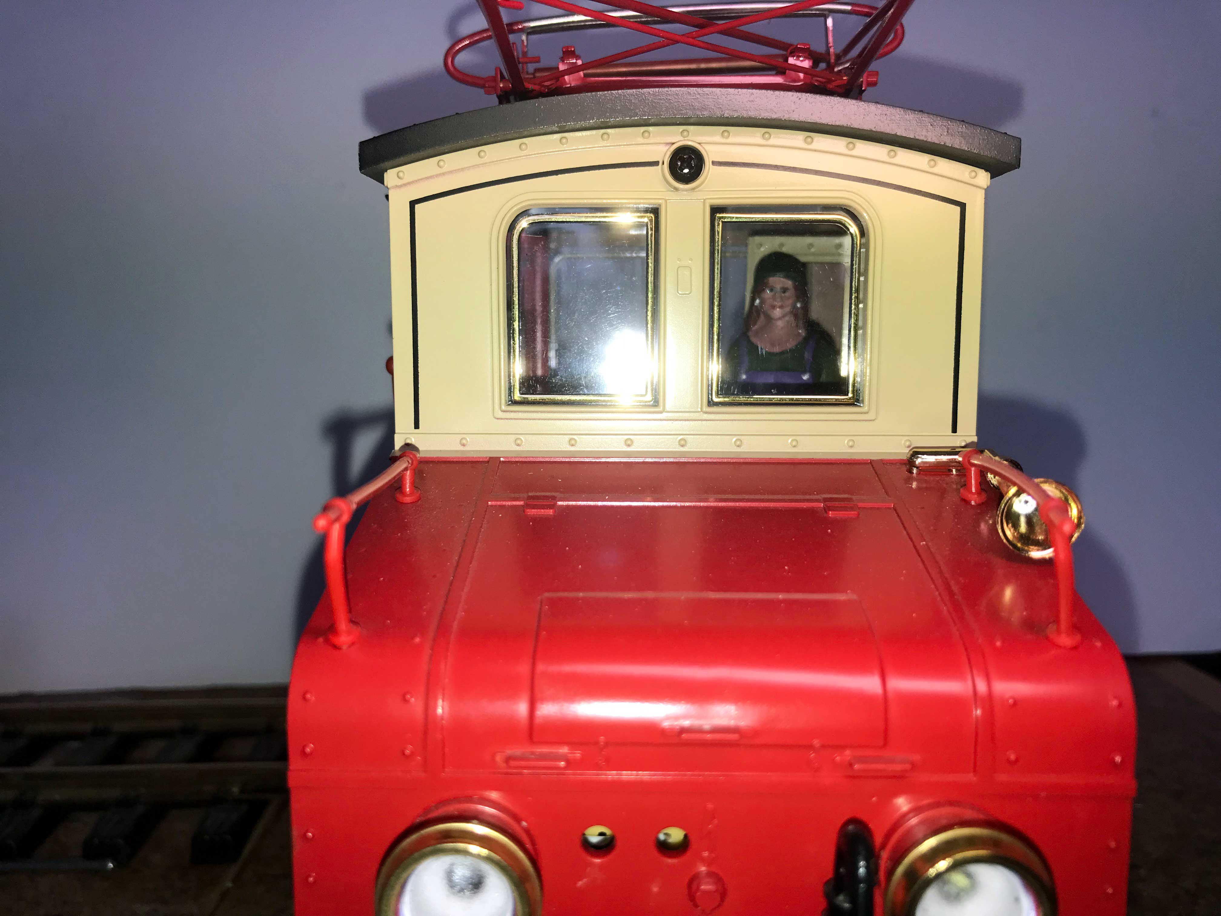

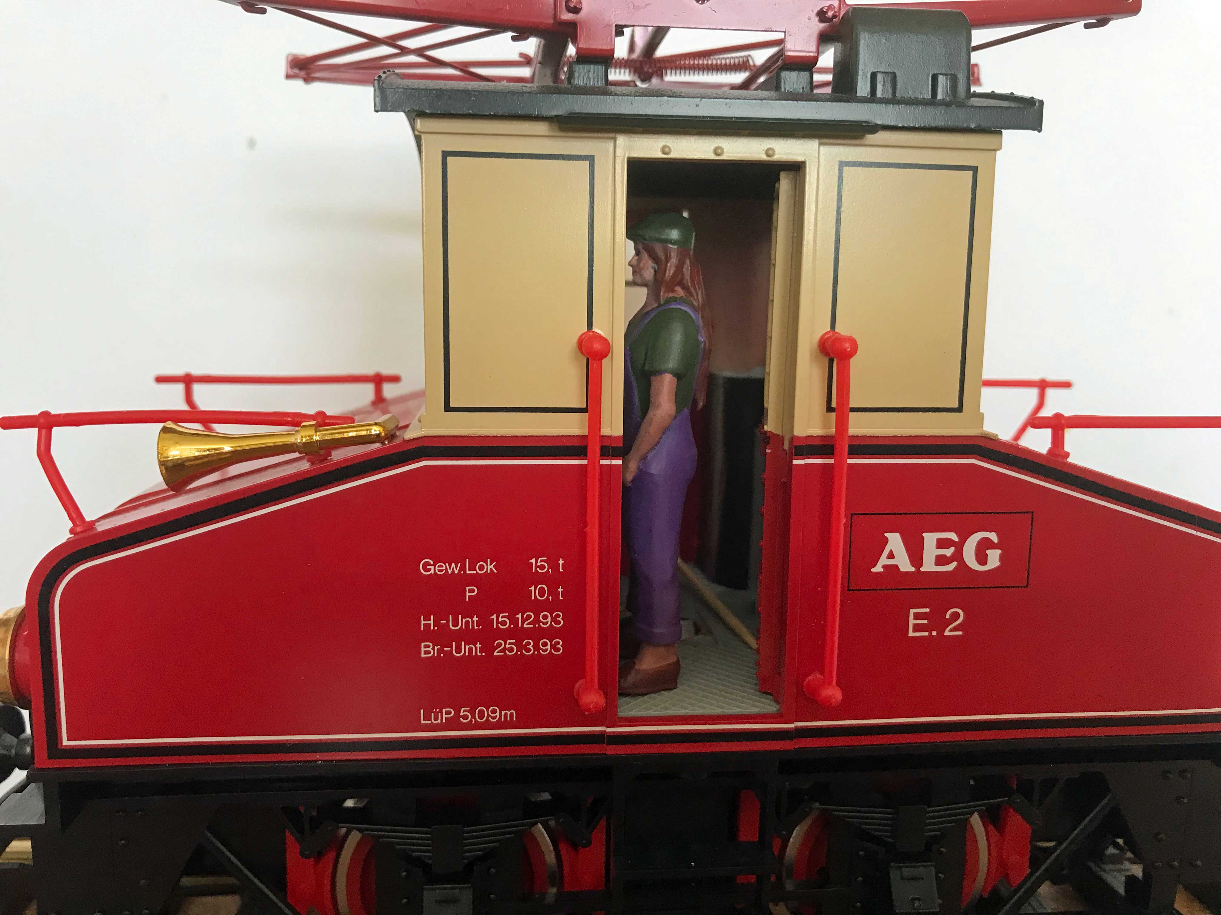

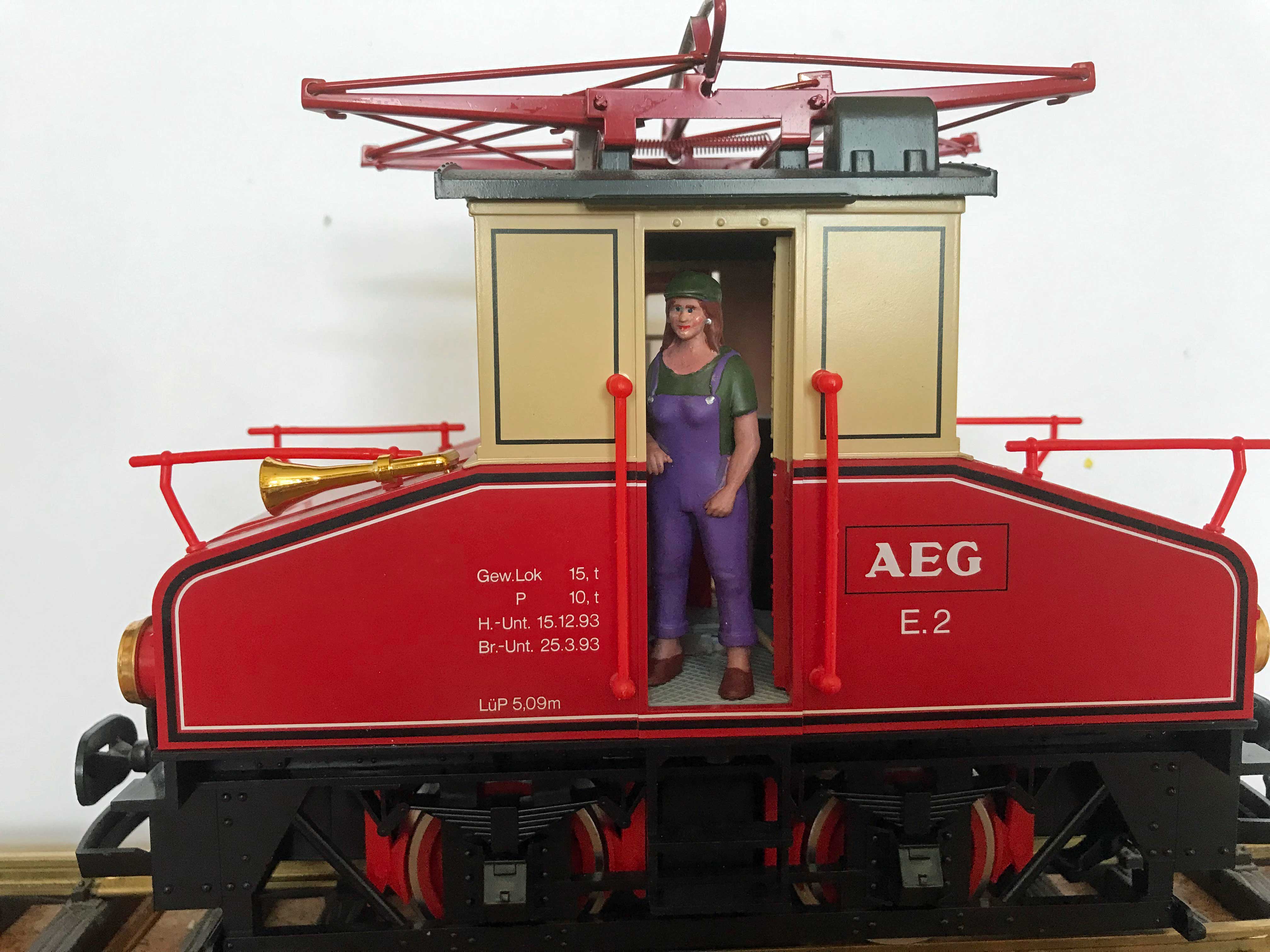

Just received my re-scaled 1:22.5 (75mm high) figure very impressed.
