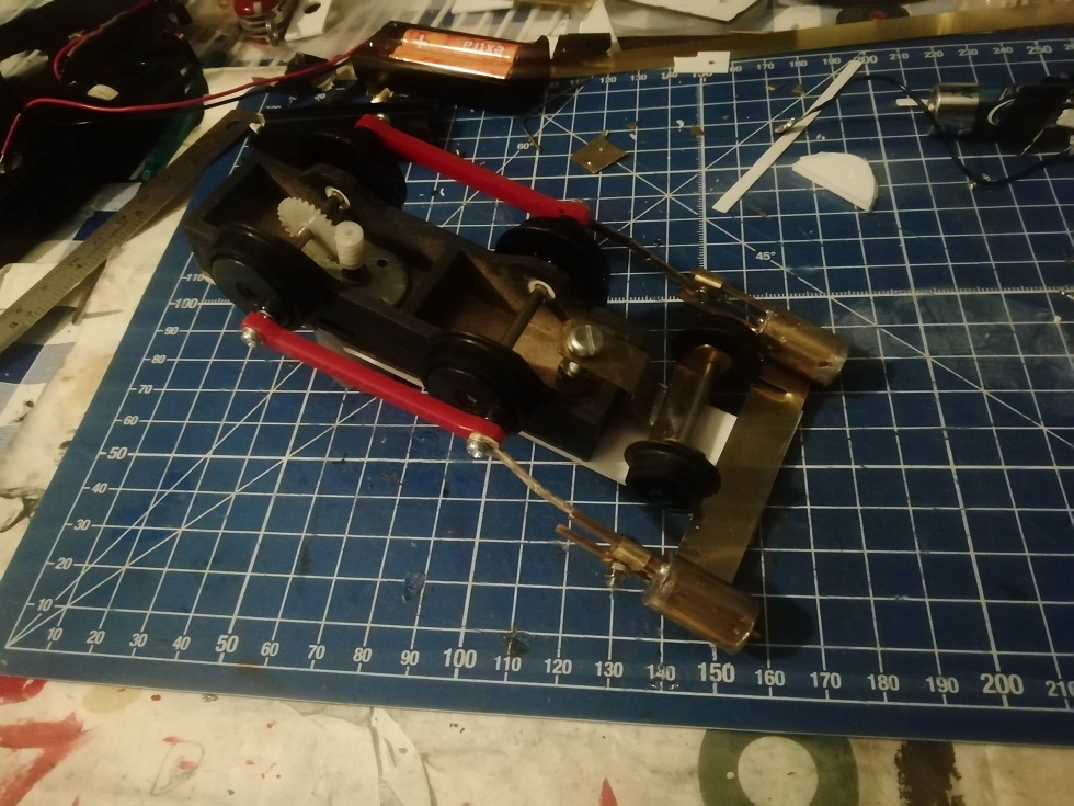

After a bit of time on the shelf I decided one of the aspects of the Bagnall I wasn't happy with the connecting rods set up. These consisted simply of straight rods sliding into slots in the cylinders - exactly the same as they do on my 00 gauge Hornby Caledonian 'pug'. The choice prototype had the advantage of sand flaps covering the motion, which meant I could hide this arrangement. At the time of starting this project, the thought of constructing my own motion as simply too daunting.
Subsequently though, I decided I'd give myself the challenge of creating working motion for the loco. Once again, I more or less followed Rik's technique for constructing these from brass tube, rod, angle and strip. Here's the result so far. My soldering work might be somewhat sloppy (some of this will eventually be hidden by plasticard decoration) but... it actually works!

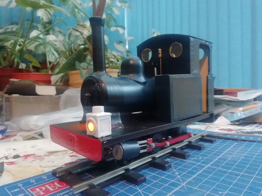

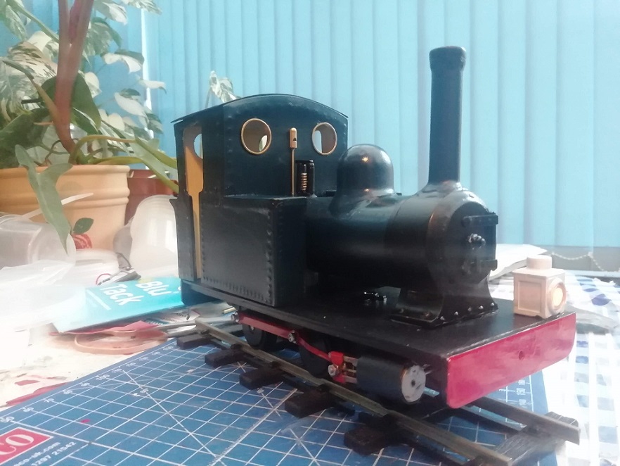

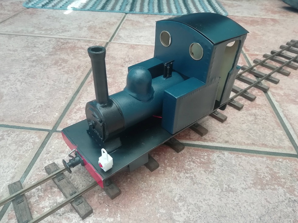

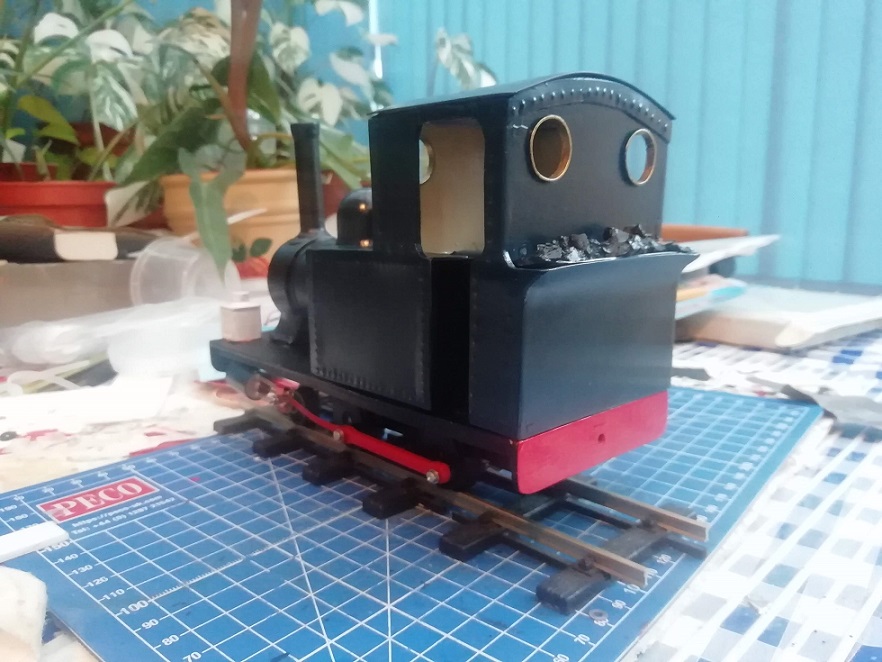

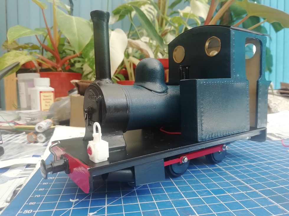

Here's a few pictures of the (almost) finished loco, back on its wheels, with the home-made cylinders and connecting rods working nicely. I've also added a working headlamp and a nice coal load for the bunker (actually a ground up cork from a wine bottle, seem to have a plentiful supply of these for some reason!). The loco-remote system is also working nicely, albeit a proper handset would be nicer, but for Β£30 it's a decent little system. The chip itself just about fits inside one of the side tanks.
Still got a few details to add, including a driver from IP Engineering (who requires painting) and the pipework on the front part of the boiler (no idea what that is called, sorry), and to paint and add the buffers.
As amateurish as it is in many ways, I still look at it and think 'wow, I made a locomotive!' Which is pretty satisfying. After cutting my teeth on this project I reckon I could do a better job a second time around. I've got an old Novo 0-4-0 chassis knocking around which I'm thinking about having a go at building a scratchbuilt, steam outline body for. Perhaps a saddle tank of some kind. Anyone got any prototype ideas?
