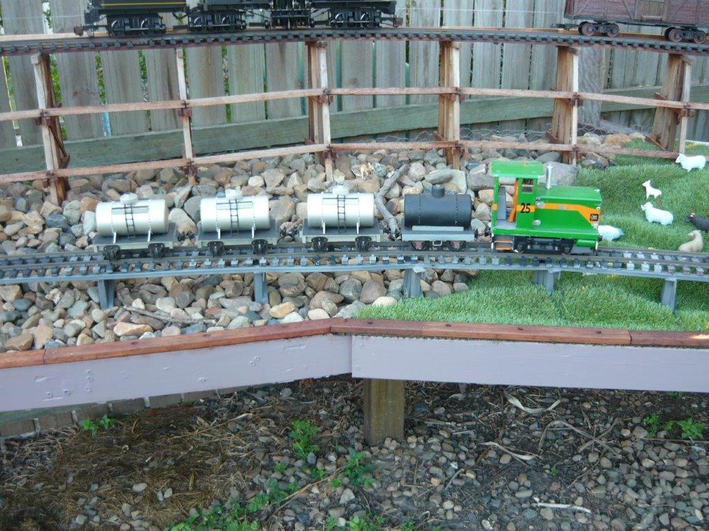

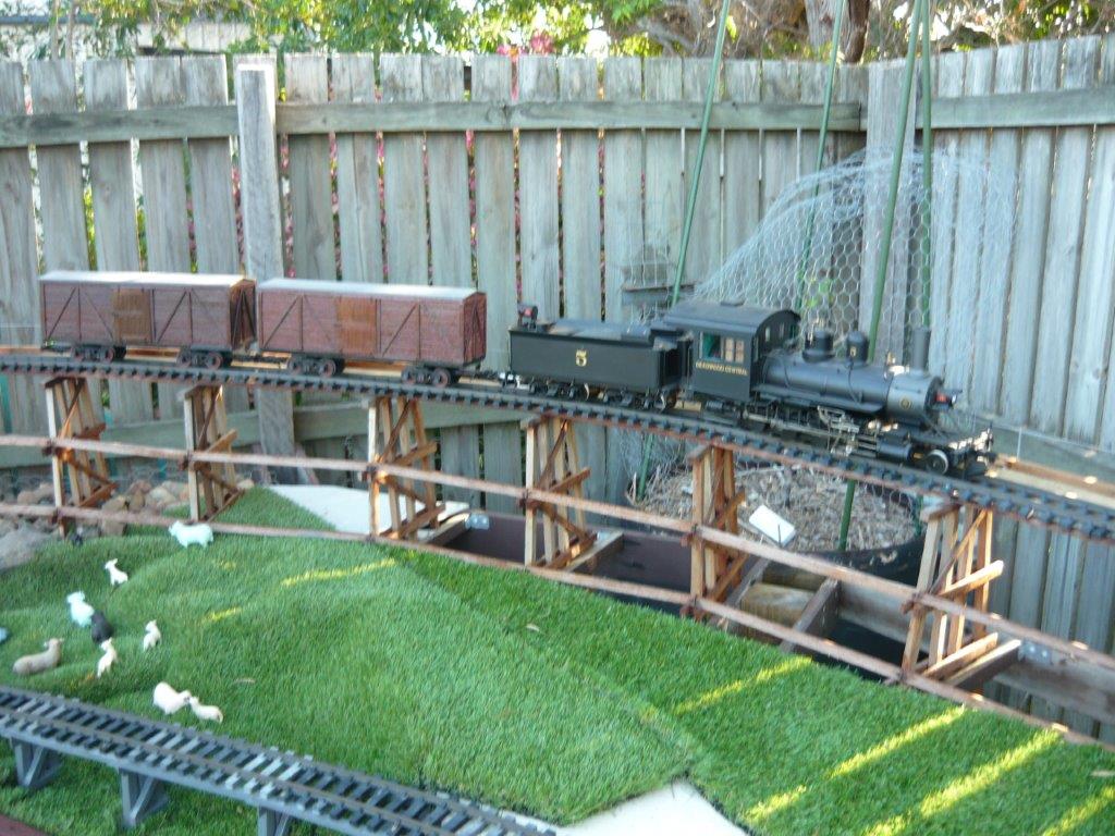

I have reached a point where I can call Stage1 complete.
The track has been laid and the line across the high trestle (my biggest worry) has been tested, my largest locos and a train have been run across it, both forward and backwards with no problems at all.
The low trestle has been tested as well and no issues presented themselves, looks like my pedantic attention to both trestle constructions has paid off.

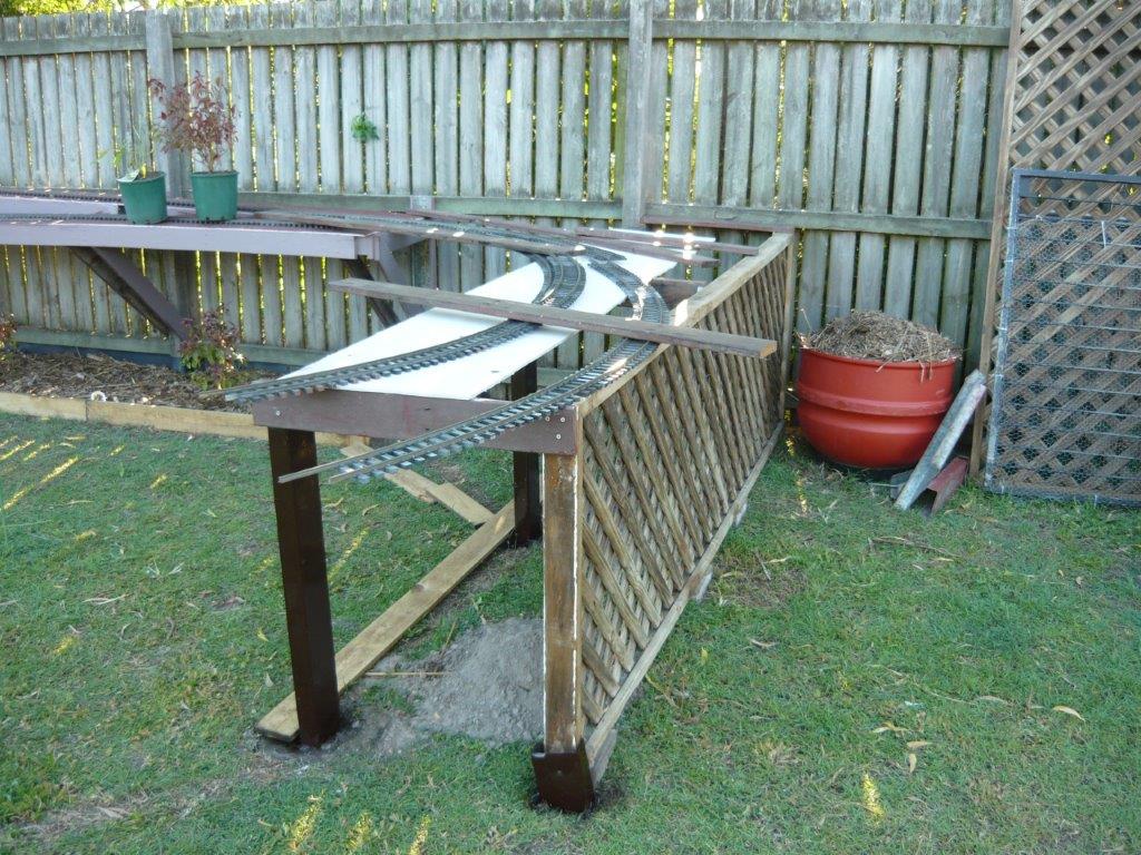

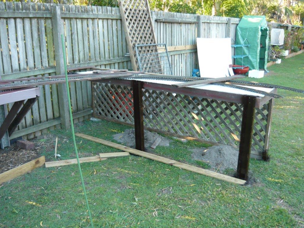

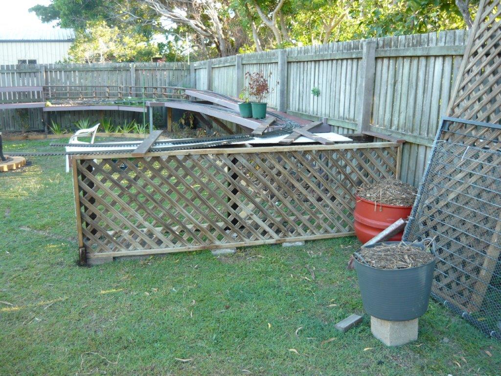

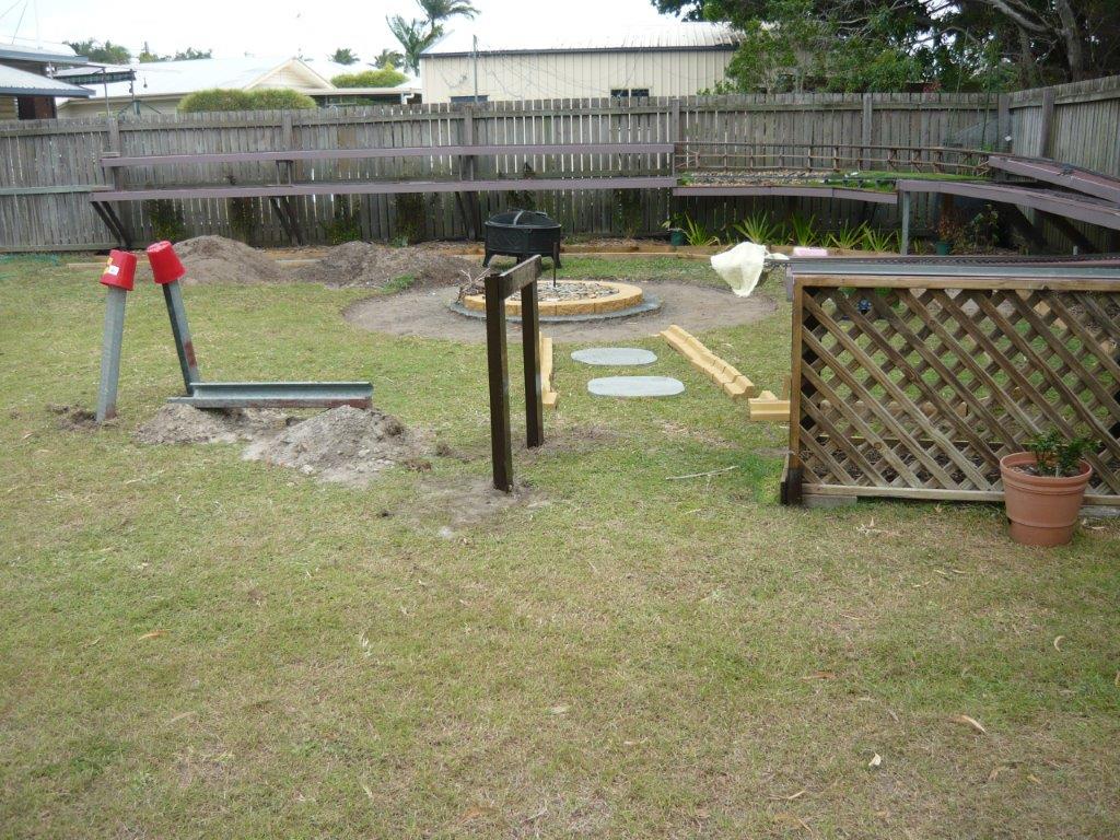

Stage 2 has begun it involves bringing the 2 tracks around a series of curves to run across the yard into the "town area.
As there are no fence posts to attach to I have had to cut my own and concrete them in, they are made of galvanized "C" purlin (used to build sheds etc).
I have also used a piece of lattice screening that was on my back deck before it was renovated, it provides a finished edge to the railway when it is viewed from the house. As my wife likes Coleus plants and the lattice provides a shady spot that is what will be planted there thus giving area the name of 'Coleus Corner'.
Pictures of progress so far.
Access to inside the loop will be via a lift up bridge hinged at one end.
In the centre of the layout design of a garden area has begun.

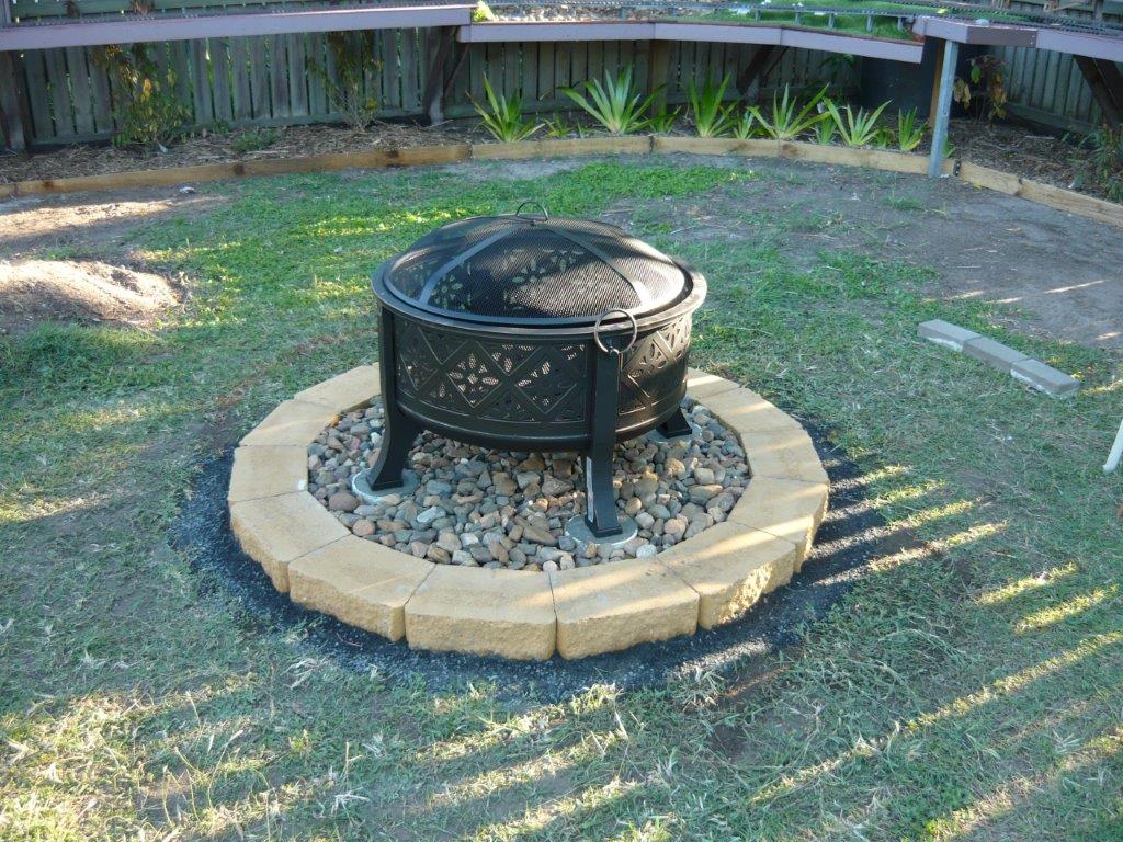

SWMBO wanted a firepit but we could not decide where to put one then I had a flash of brilliance and suggested we put it inside the railway that way we could sit by the fire in winter and watch a train or 2 trundle around.
Now this project has snowballed to me laying "Cracker Dust" (made of crushed rock which when mixed with cement acts like concrete) paths following the track and planting out and mulching the area so I do not have to mow grass inside the loop.
Picture shows the firepit in place, there will be another circle constructed and filled with "Cracker Dust", this thing could end up bigger than Stonehenge.

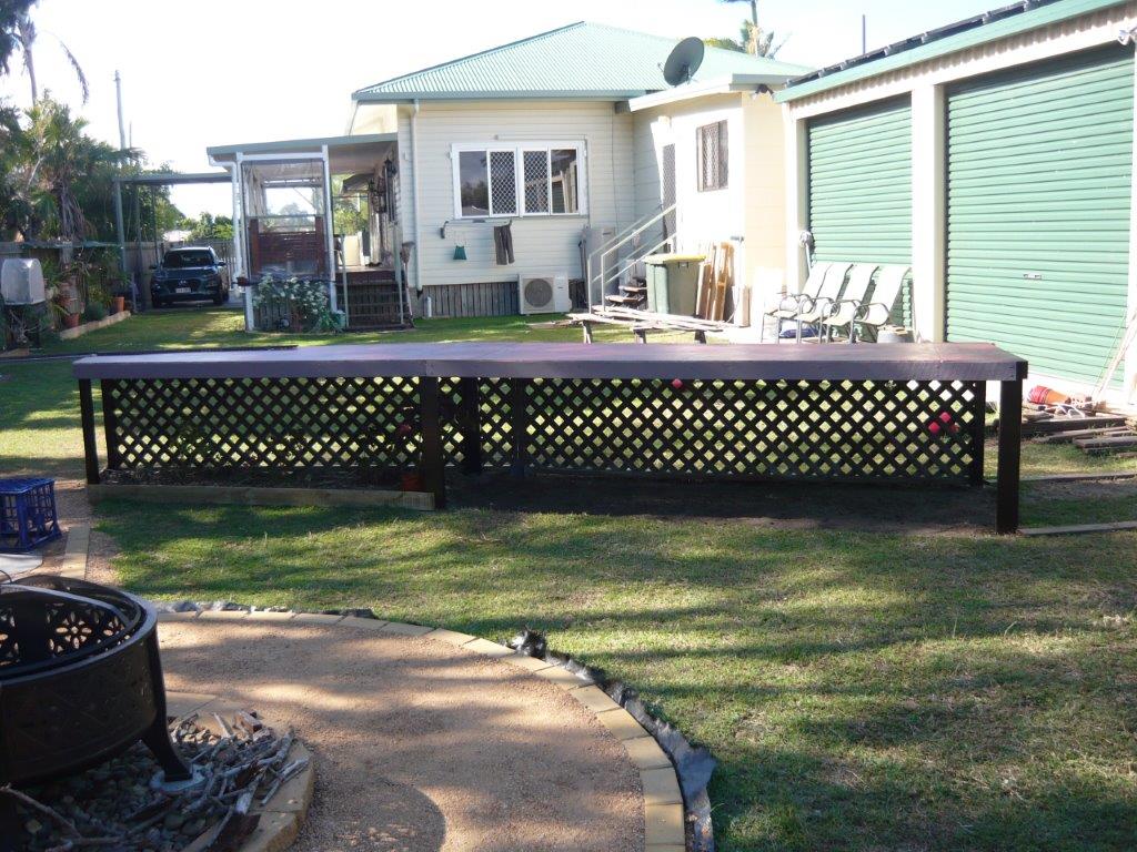

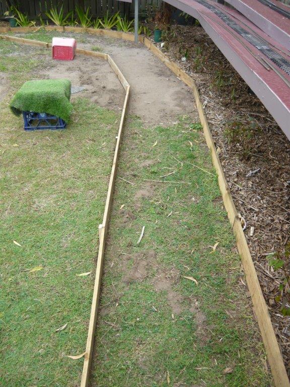

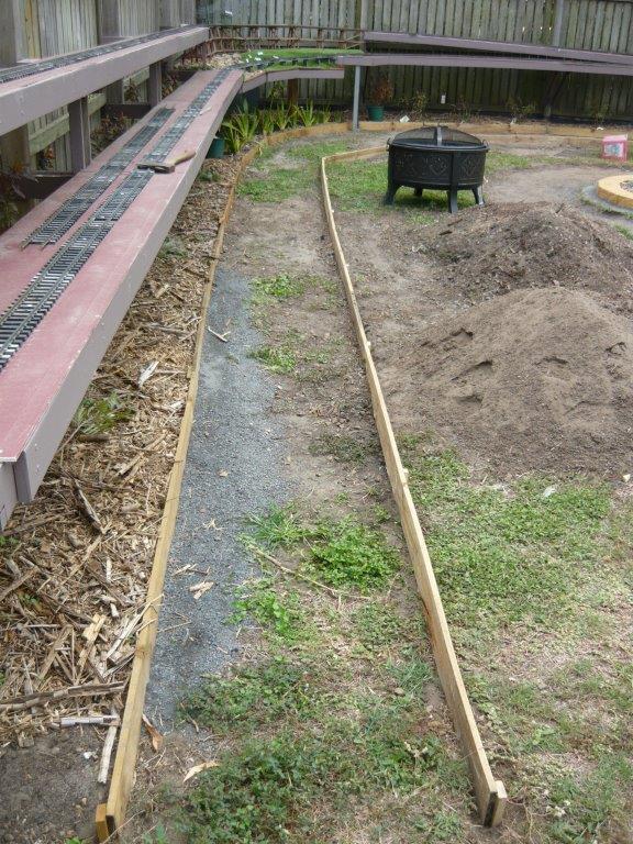

I have built the opening for the lift up bridge so that will be the next project under taken.
I also did a bit of landscaping around the railway and the firepit area.
I now have the edges of pathways that will follow the track boards so that I can follow a train right round the layout with out walking over garden beds.
I intend to landscape, with mulch and bushes, the whole inside loop area so as to eliminate mowing.

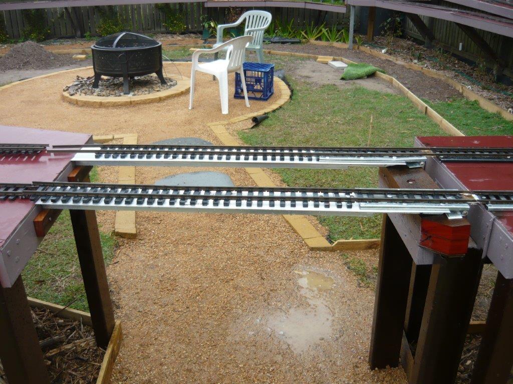

Some progress on the layout.

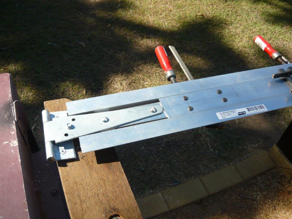

Half the lift up bridge is finished.

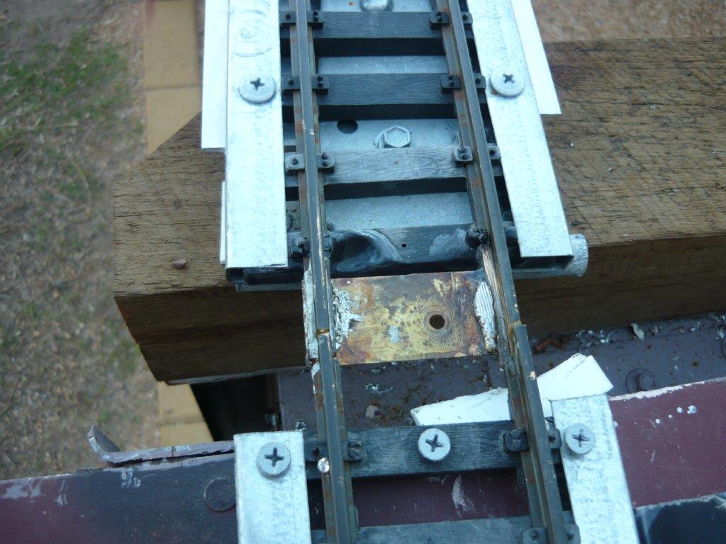

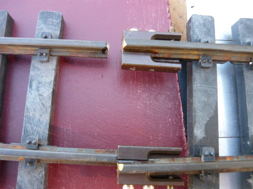

The opening end rails will be held in place by "Hillmans" lift out bridge clamps.
To keep the rail alignment at the opening end I soldered a brass plate under the rails which holds them at the correct gauge. (the melted sleeper will be replaced)
Lift up bridge lengthwise.jpg (81.65 KiB) Viewed 51645 times
Hinge and deck fitted.jpg (126 KiB) Viewed 51645 times
Hillmans Bridge Clamps.jpg (109.4 KiB) Viewed 51645 times
Gauge plate on bridge end.jpg (116.7 KiB) Viewed 51645 times

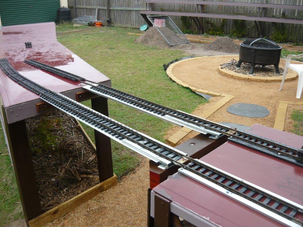

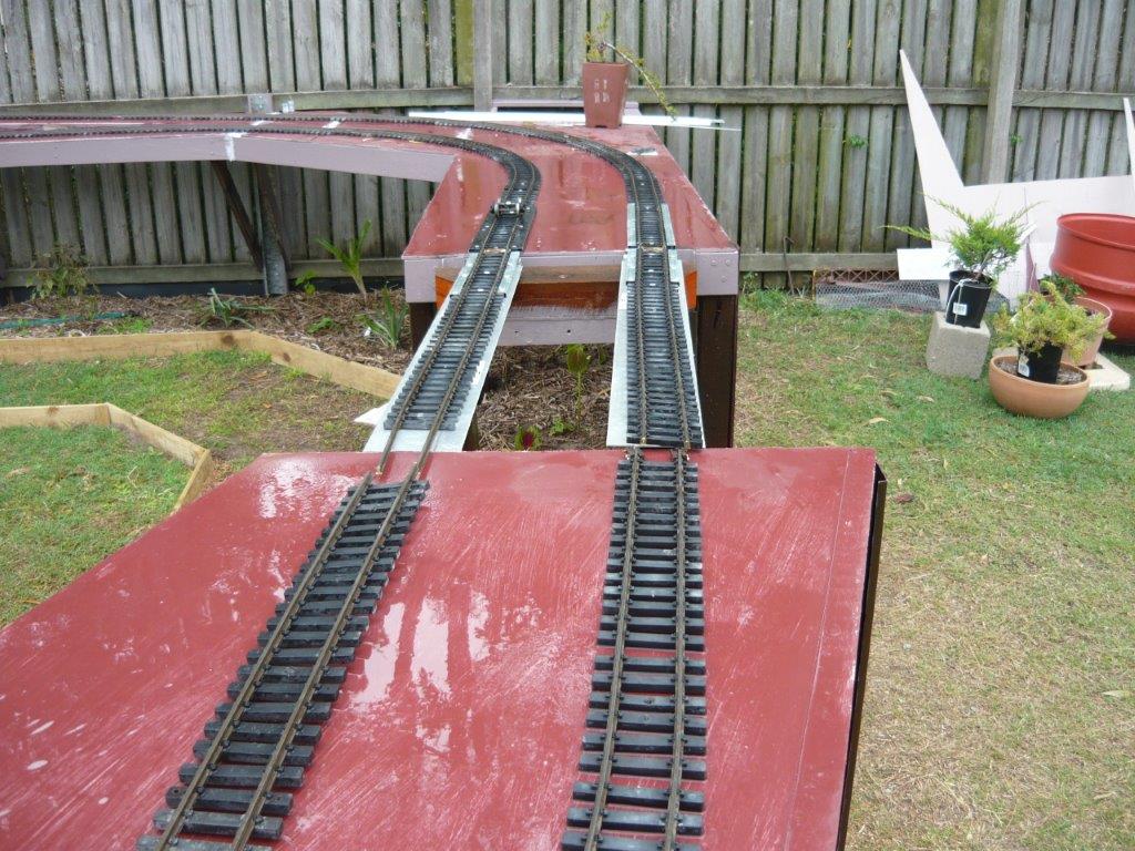

The baseboards across the yard have been installed, so Stage 2 is nearing completion.
Across the gap and beyond.jpg (136.07 KiB) Viewed 51645 times
Across the yard part 2.jpg (171.33 KiB) Viewed 51646 times

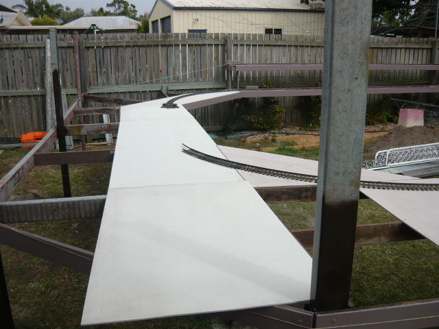

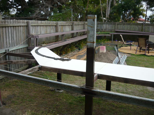

The framework for Stage 3 has been finished and the baseboards for the Lower Loop running through Stage 3 have been installed, this now allows me to lay track to complete the Lower Loop so I can run a train continuously.
Once they are painted track laying can commence.
